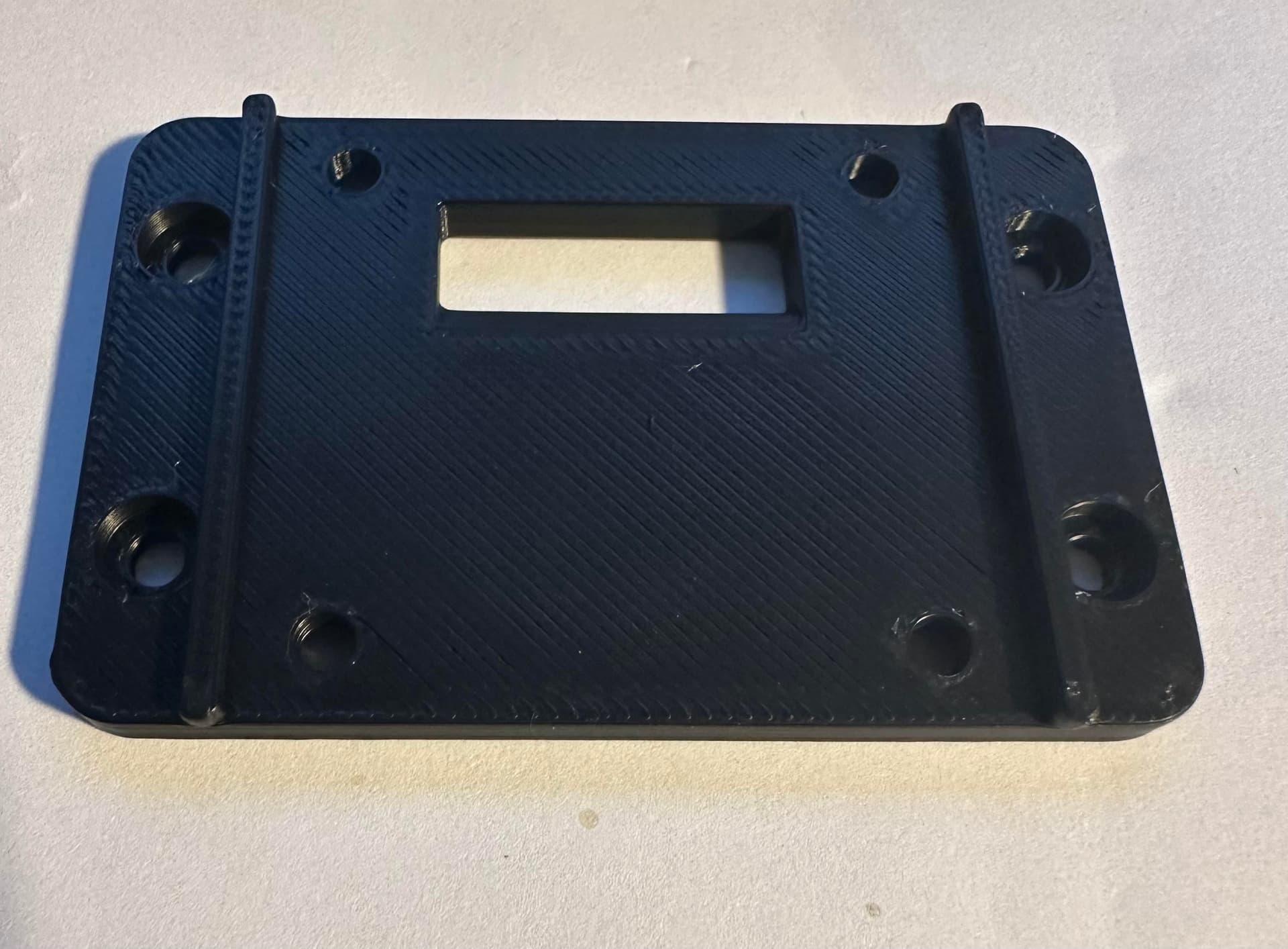

A few weeks ago this printer started either under extruding or over extruding. I can’t tell which and I have made corrections for both with it only getting worse. I will fully admit that I am normally a print by the defaults sort of users, that is why I like Bambu, it generally works. I do make some changes, but flow and pressure advance I normally leave to the machine.
So, that said, I have tried to manually calibrate, even used a magnifying glass while doing it to make sure I was picking the “best” even though there really weren’t great choices (well, imho there weren’t). But it really only gets worse. I will say that increasing the K value makes it way worse, but that test said it should be higher so I went with it. That was awful… Anyway, I am going to post a picture, but I am not sure if it is under or over extruding. I would guess it is under extruding, but like I said, I have gone both ways without good results.

BambuPic
When I perform filament calibration on my P1S, I have it go in 0.001 steps instead of the default settings for K value.
Upgrading the firmware did nothing…
I looked through my extra parts and found a new hot end for the P1S. I switched it out and got a better print. Testing another print right now to see if that was a fluke.
