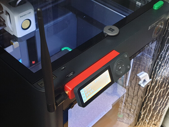

P1S WiFi antenna upgrade
Before you now get all excited let me break the fun - it won’t help much with the connection and drop out issues…
I found a TP-Link 2408C antenna for dirt cheap and brand new.
Wanted it to replace the flimsy antenna on my router to get a better signal in the garage.
But then I also spotted an equally cheap router with WiFi 6 and good reviews…
Long story short I salvaged those antenna cables from the old router and used one as an ‘extension’adapter cable’ for the big antenna.
Bit of a hassle with the sticky tape but at least Bamu has a Wiki for the antenna replacement.
My expectation were not that high as we already established that cheap hardware paired with overcomplicated security features are our main issue.
But from just one bar for the Wifi signal my printer went to a full strength signal.
Even tried a 20m Ethernet cable for the router and with about 30m between it and the printer I still had a working signal.
Great if getting a Wifi signal is the only worry.
Transfer speeds only improved marginally, if at all - still takes forever to transfer a huge print to the machine.
Still get the occasional drop out resulting the printer getting lost for Studio, still have Studio forgetting the access code every few days.
Is it worth investing the $20AU for a big antenna and to use salvage parts to complete the connection?
It certainly is if the signal strength is your worry.
The advertised 8dBi extra do show and make things a bit easier.
Tried the antenna with a Wifi module and with the original short antenna I lost the signal before I reached my neighbours driveway - about 12m from the (new) router.
With the TP-Link antenna attached I lost the signal a further 25m down the road.

Oh yea, you already upgraded. I haven’t yet. Agreed that their WiFi chip is just plain bad and slower than what people expect these days.
I have a fast costly micro sd card. Has not helped the speeds. It’s hardware related.
I didn’t replace the antenna but my printer has full bars.
Thanks for confirming that aspect.

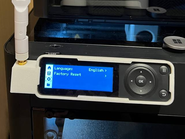

The bottle neck here is the “brain” of P1S, which is a tiny microcontroller ESP32. Although esp32 is fast by microcontroller standards but very slow by CPU standards.
In the esp32 datasheet, max WiFi speed is 150mbps but I doubt the actual speed could get higher than 1mbps for P1S.
The antenna orientation of P1S is wrong. Considering WiFi 2.4GHz radio wave radiation pattern, the antenna should be vertical. Need to rotate the PCB by 90 degrees or connect an external dipole antenna.
