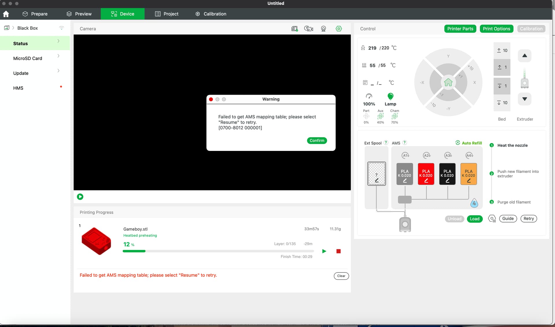

Came here looking to see if I was the only one. Updated the P1S firmware and it got stuck on the Heatbed Preheating for over ten minutes, then I received a ‘failure to connect to AMS’ notification.
Tried two prints, managed to get to 12% on the second one before the AMS failure popped up again.
I am getting tired of doing updates and then losing functionality.
Attaching screenshot of the error message.
Well, now you know what to do.

In my case, it was the compbination of Orca Slicer and 01.08.00 that triggered the malfunction. When I use Bambu Studio, it prints fine on the latest firmware.

make sure you’re using the latest supported version of the software as per released notes:
Bambu Studio: v2.0.3.54 or later
Bambu Handy: v3.1.0 or later
100% my fault, I thought I have the latest version installed and didn’t read the realease notes :slight_smile:
Thank you so much! I am up and running again! Love to hear the printer going!
