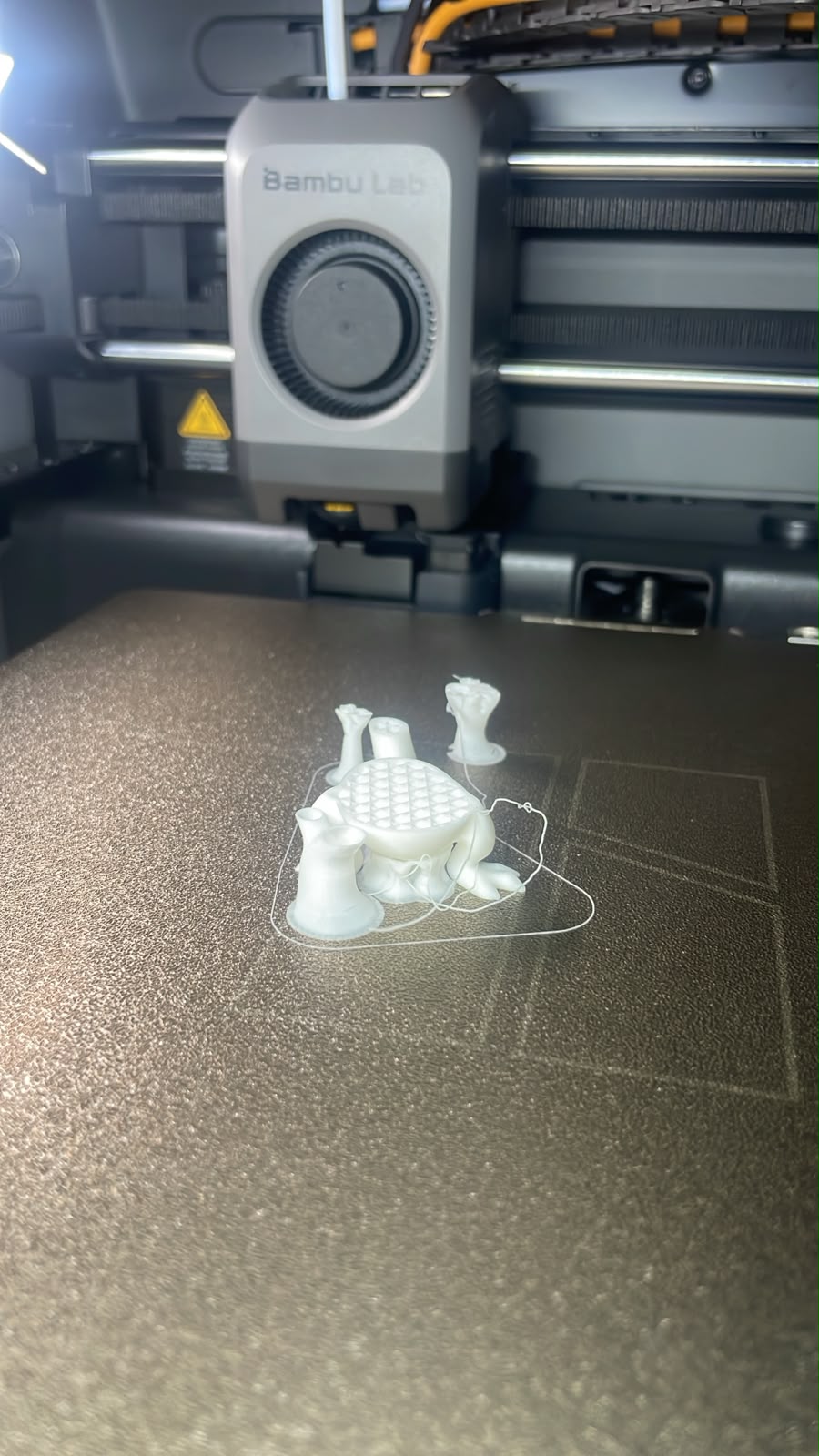

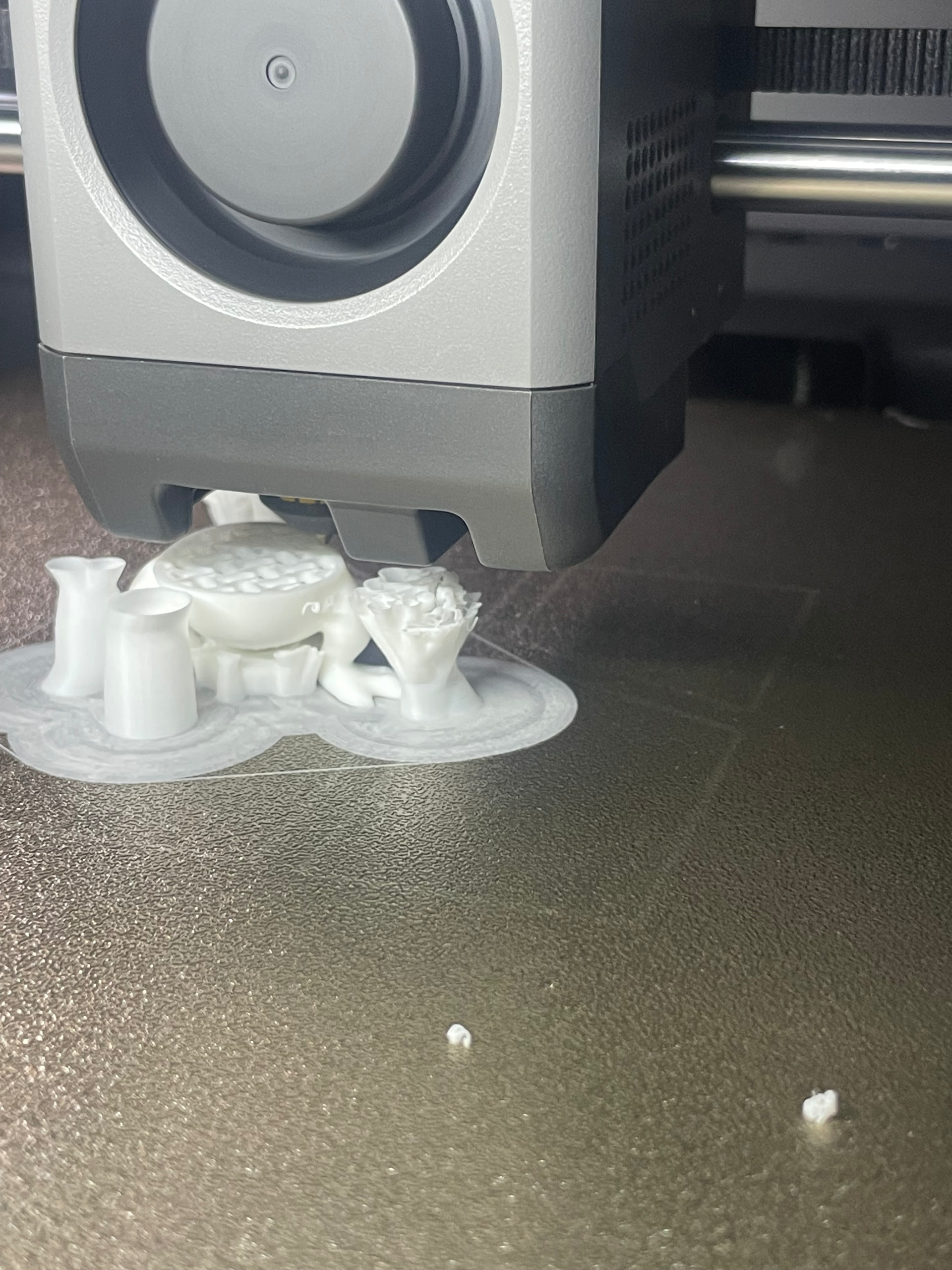

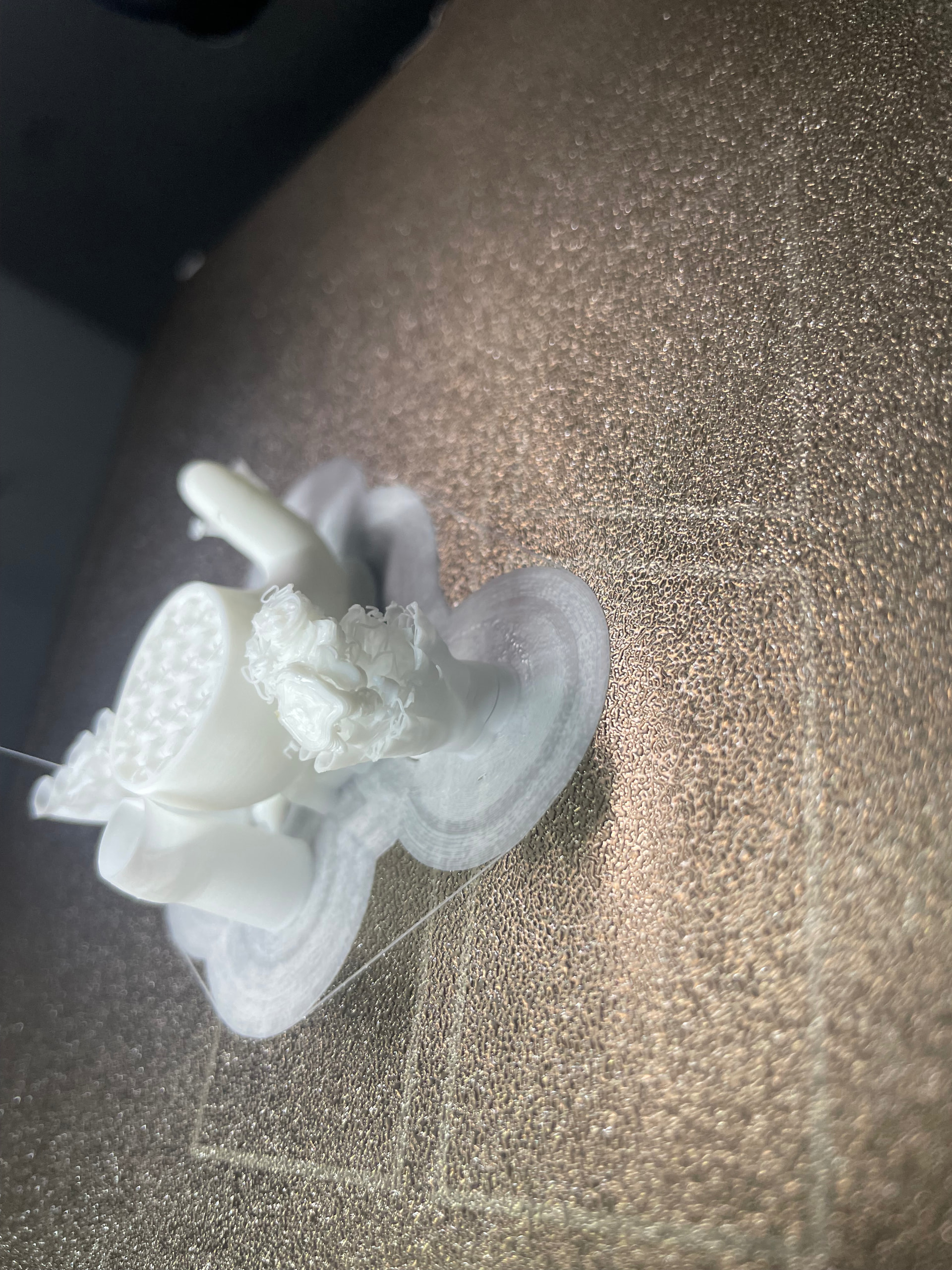

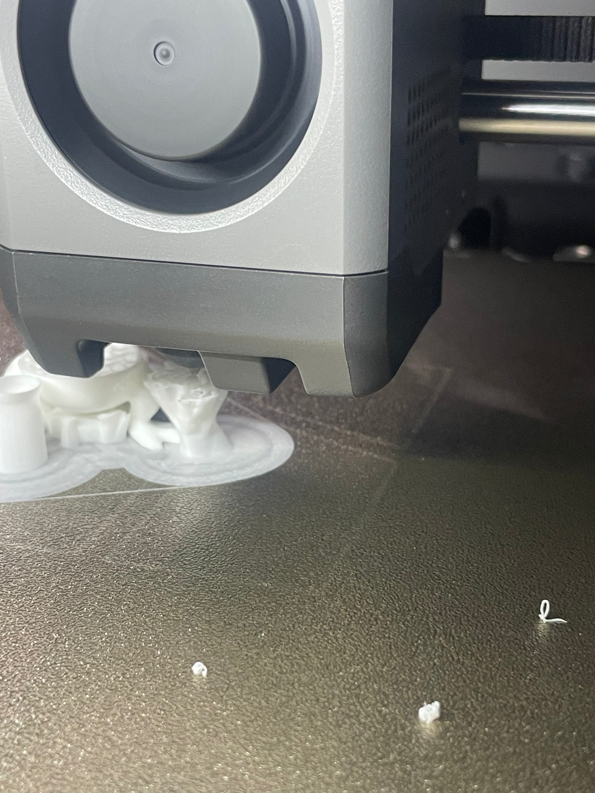

The extrusion totally failed in one of the supports resulting in bumping with the nozzle and failing my prints, any ideas to solve the extrusion problem?
I will run those again tomorrow.. and will upload the file, but this happens on other prints aswell, mainly when i have a lot of supports and few surface area.
The chamber (closed) is 38*C could it be heatcreep?

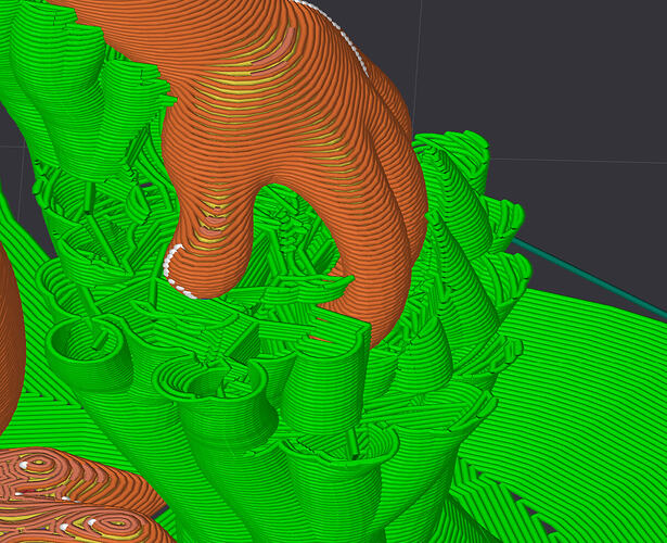

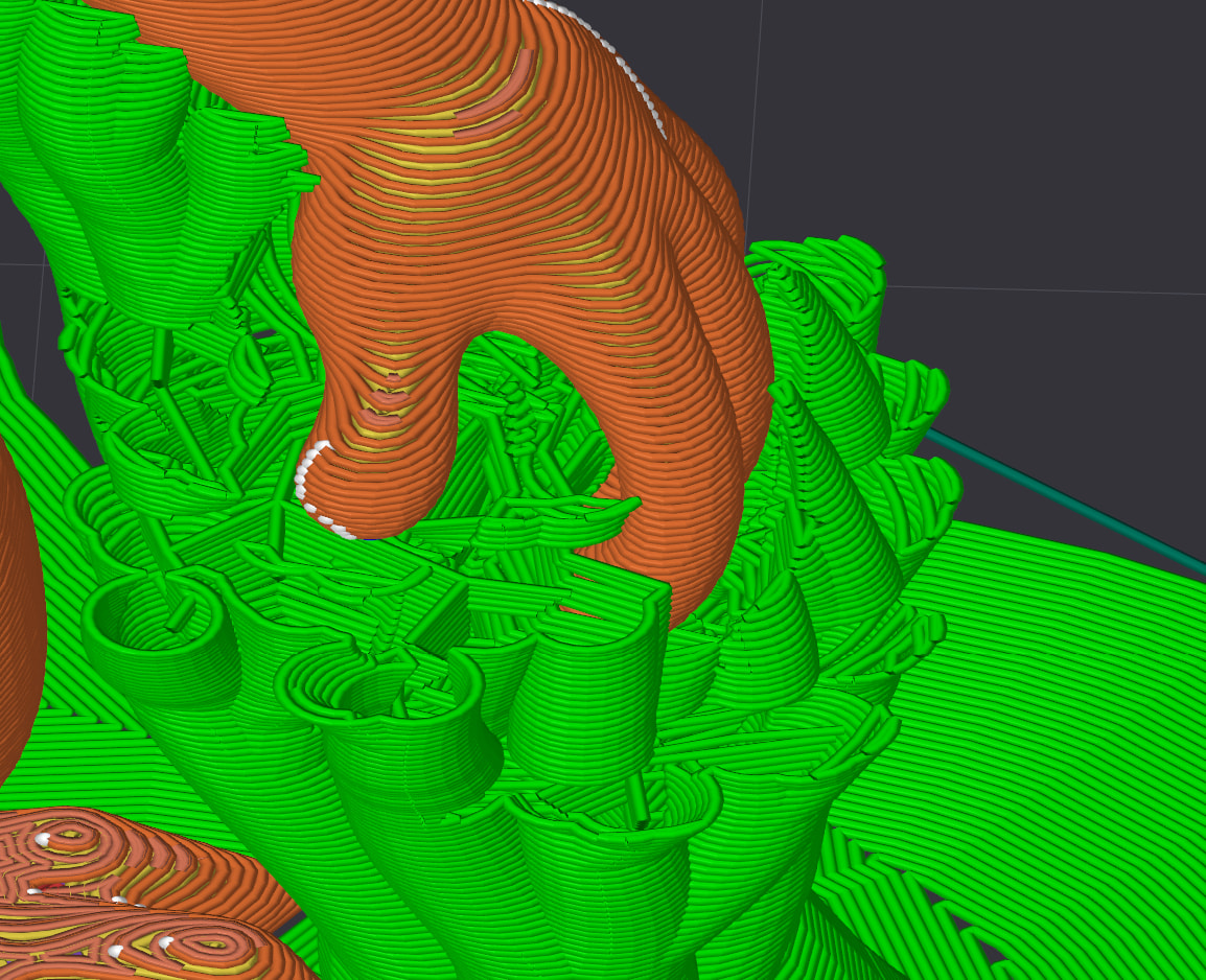

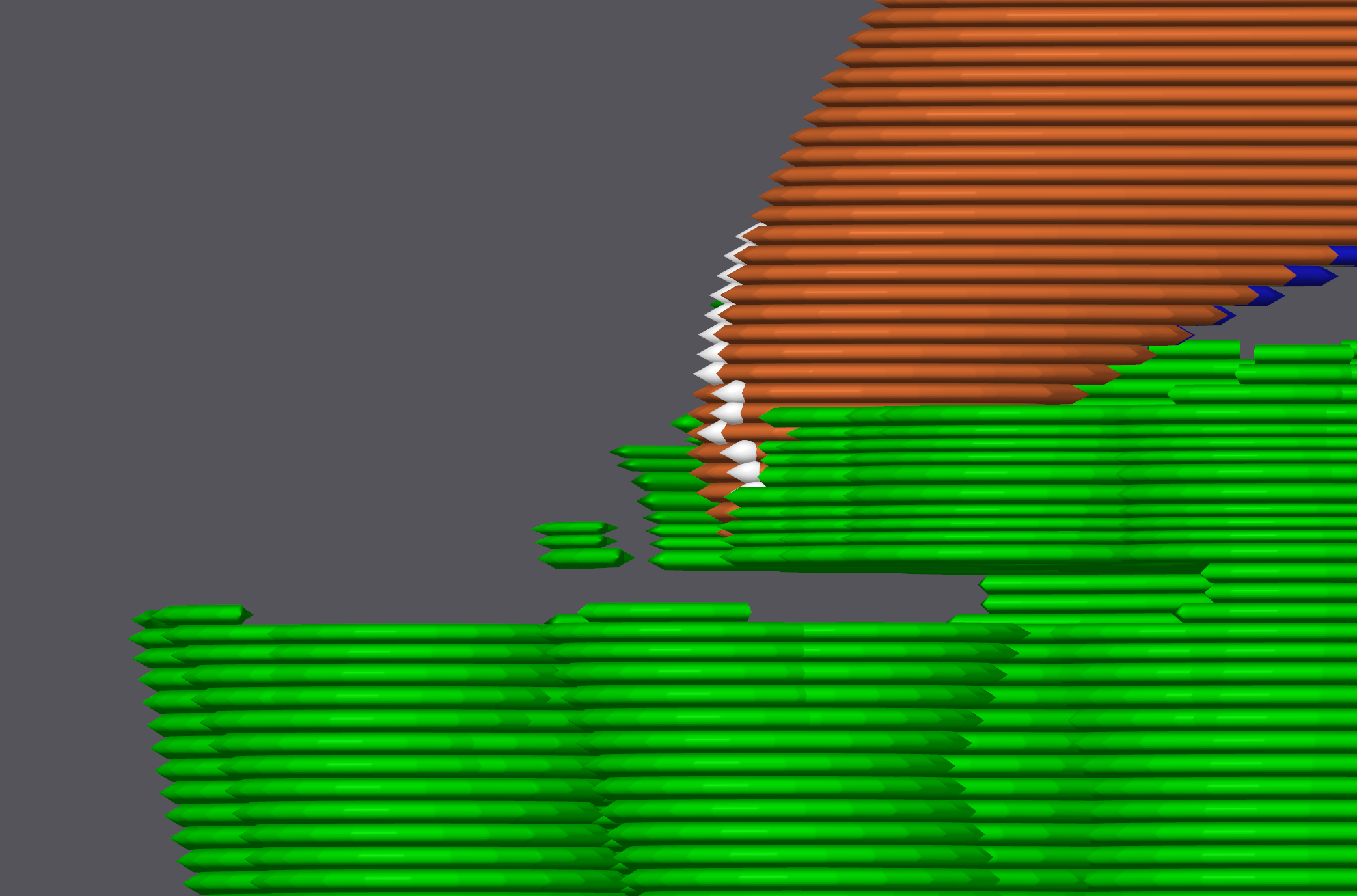

The following problem was found: For some reason, your support structure is incorrect. It not only goes to the fingers as it should, but also goes all around them and into thin air.
Now the big question is, what did you do differently?

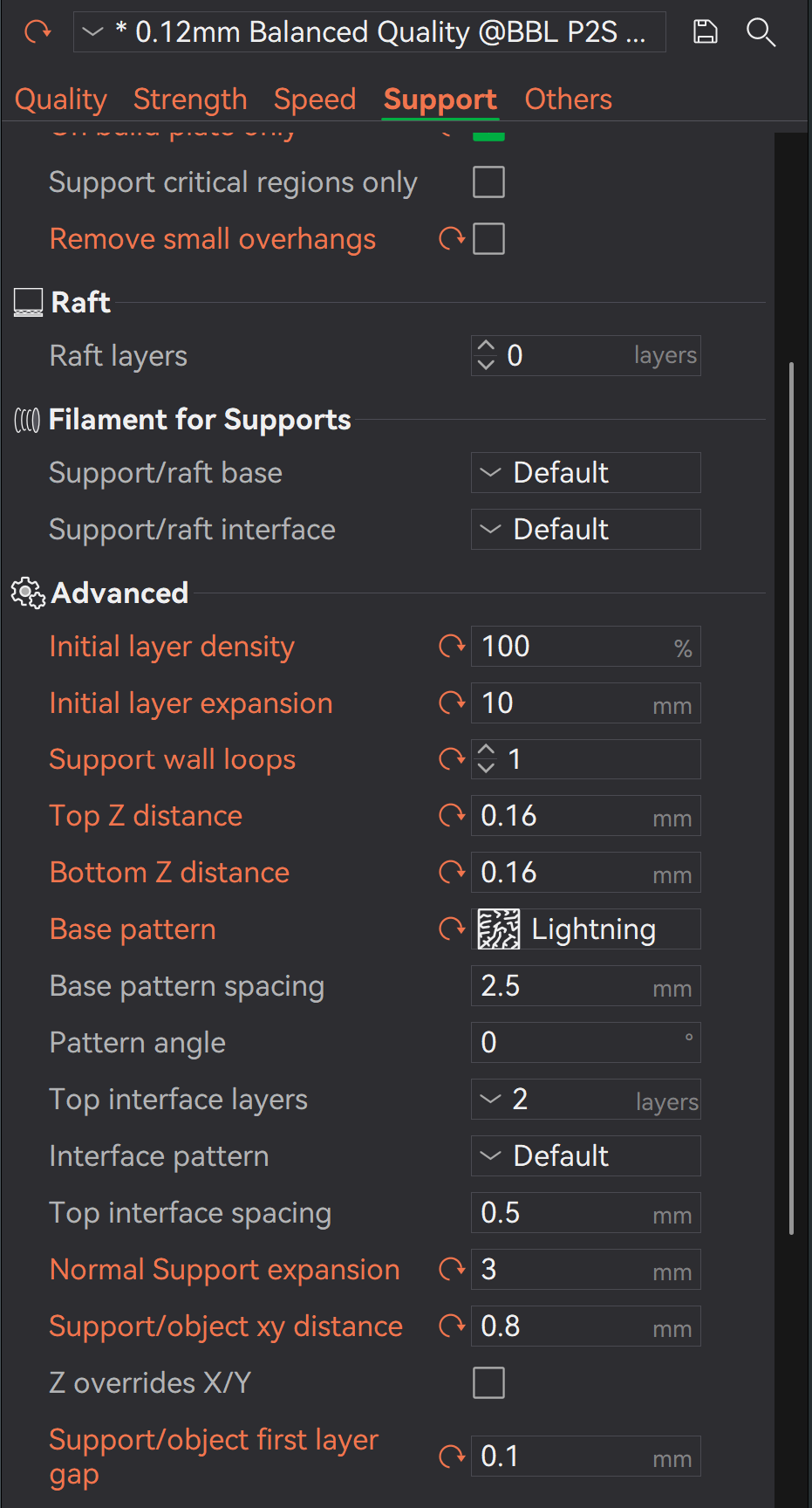

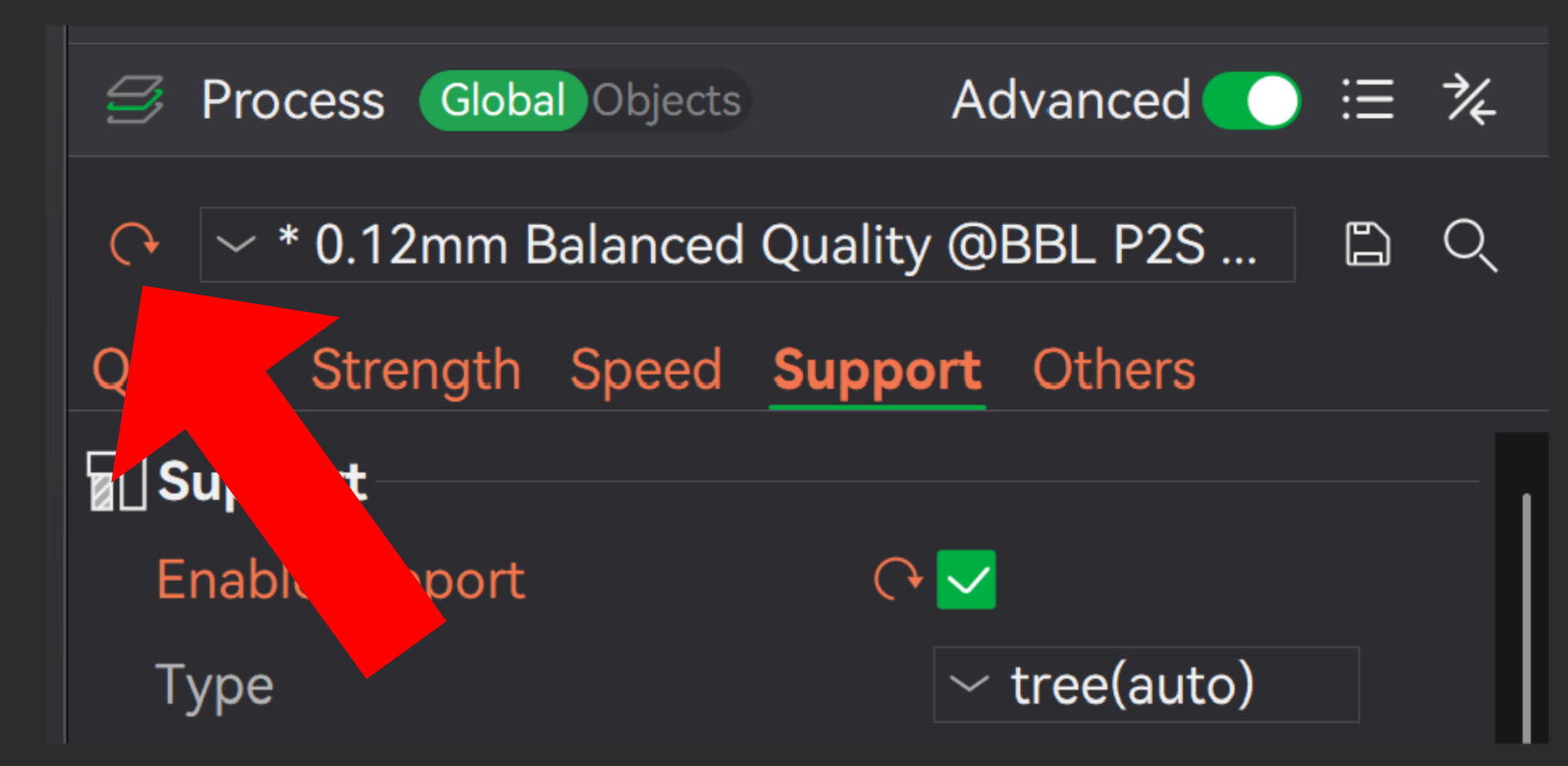

Okay, you’ve somehow tweaked every single parameter there could possibly be on your model. How did you come up with the idea of adjusting every single parameter?
Simply adjusting the initial layer height doesn’t make any sense.
Used as a Wall Generator classic - I don’t think the designer intended Arachne Mode, nor do I think it’s necessary; it just creates new problems in this case
Ironing won’t do you any good on an object like this - there are hardly any flat surfaces. What matters most for you is the layer height.
Then there are so many other settings you’ve adjusted under advanced settings - I can’t even list them all.
So you really did adjust every single speed parameter… without me being able to make any sense of it.
Support - every parameter has been changed, too, for no apparent reason.
In a nutshell: You just clicked on every parameter and changed it.

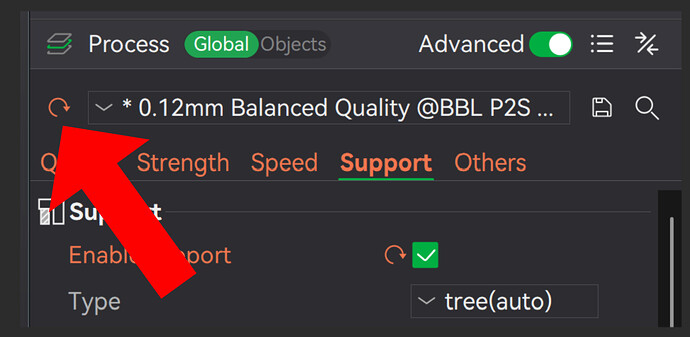

The only thing you actually need to change is: After you’ve reset the profile
I would recommend wall thickness of three
Infill gyroid, if it’s not already specified.
Seam position: back - if desired
support initlal layer expansion: ~10mm
That’s it - no other wall generator, no brim, no speed adjustments, no ironing, no advanced settings. Keep it simple - all your settings were the problem.

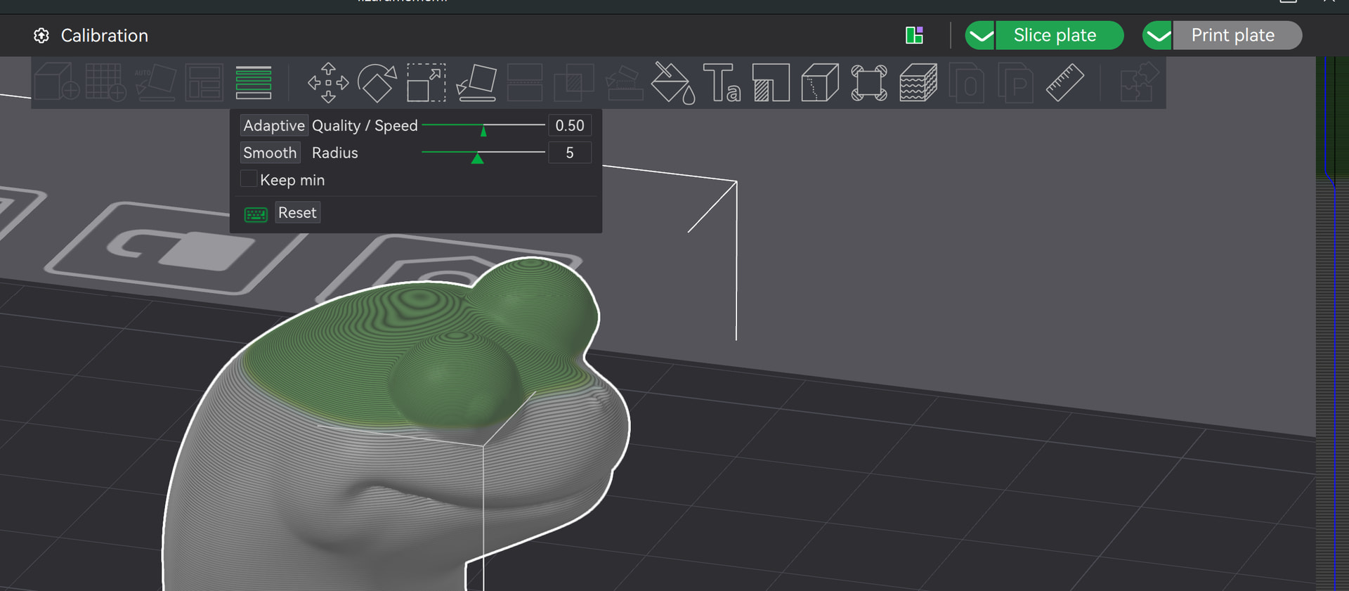

If you really want to improve the quality even further, you can select adaptive layer height - but only at top of the head of this lizard. I would, though, at least try one without it first.

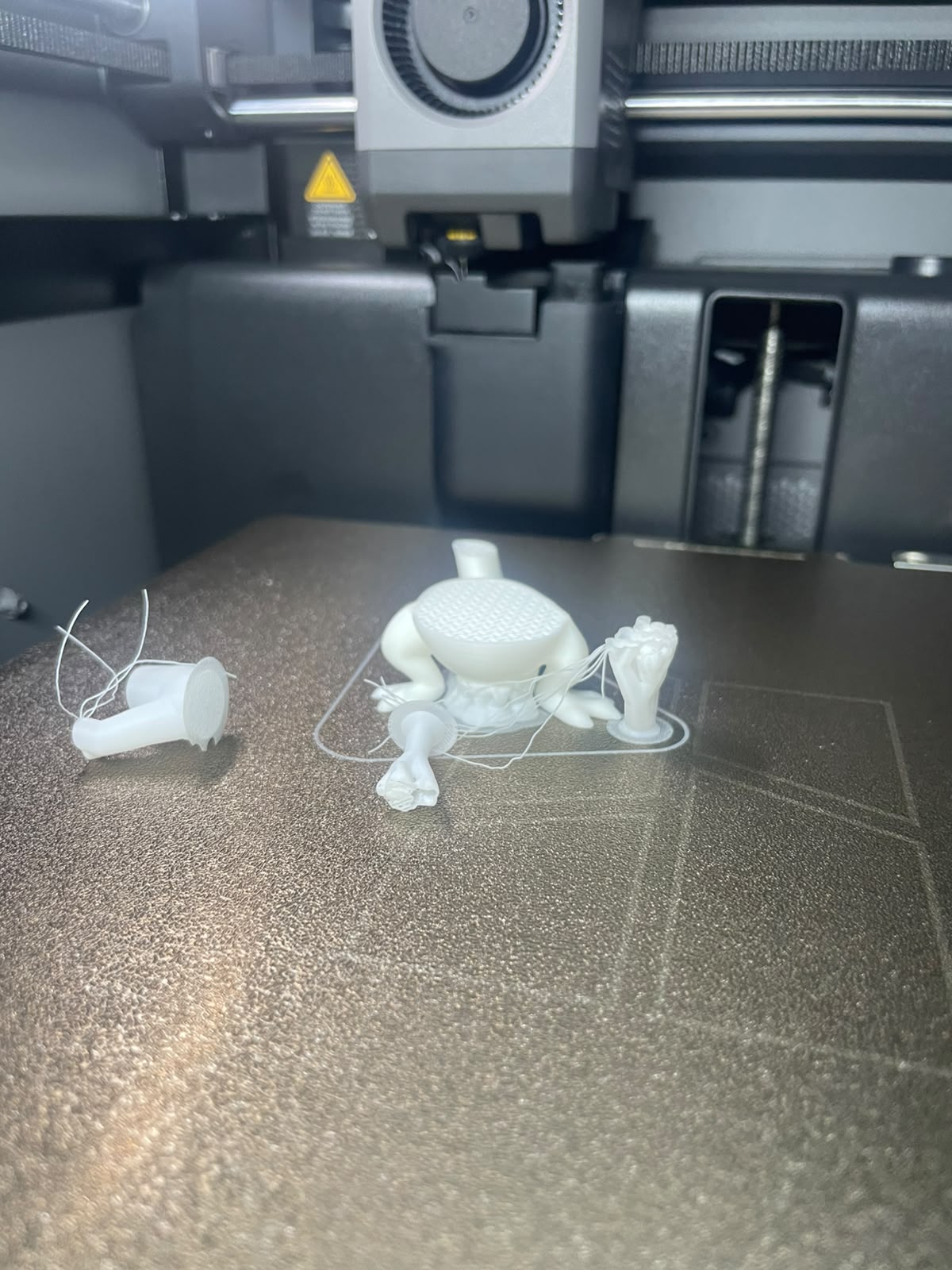

I ran another print today with supports again (auto tree) and my print failed again, not on the print itself but my supports breaking halfway (not from the plate) just snap in the middle resulting in spaghetti failure.
I’m pretty convinced it’s not an adhesion problem, it seems like i generate faulty supports.
I will try the print again tomorrow but instead of auto tree supports i’m going to try the classic supports and see if that makes a diffirence
inspect your support structures after you slice, and send us some screenshots. Having tree supports fail like that seems extremely unusual, considering that they are basically just hollow tubes.
Also, yes, keeping your chamber closed and allowing it to reach 38C while printing PLA could definitely be causing some issues with heat creep. Even on my P1S, for example, I have to leave the door open when printing larger PLA prints, or quality definitely starts to degrade towards the top.
