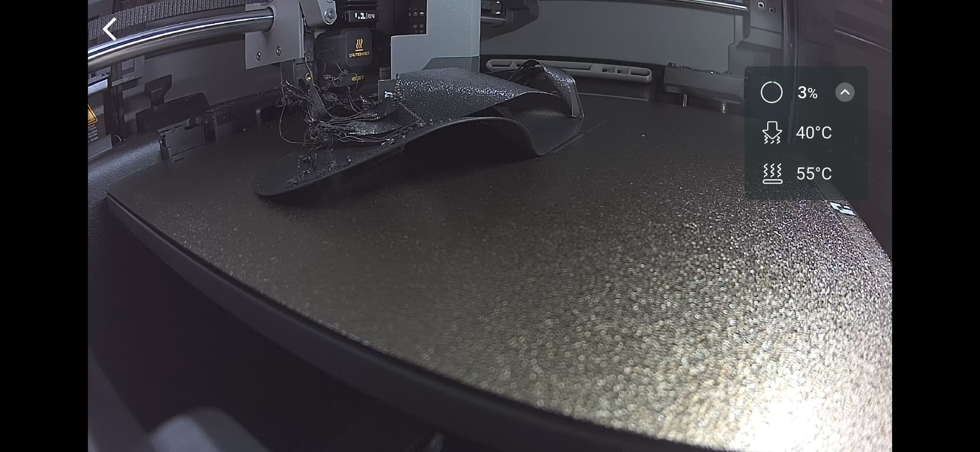

I’m experiencing a very high print failure rate after only 20–30 hours of successful printing on my new P2S.
The main issue is that the first layer doesn’t adhere properly, which causes the prints to fail.
I’ve already followed the troubleshooting steps in the wiki: bed calibration, the recommended checks, cleaning the build plate with both IPA and dish soap, etc.
I’ve also tried printing from both Bambu Handy and Bambu Studio, but the results are exactly the same.
To be honest, I bought this printer expecting a much more reliable experience. I didn’t think I’d run into these kinds of problems so quickly.
Seeing other users having issues with high-end or engineering filaments is one thing, but I’m having the same problems with basic PLA and PETG, which is really disappointing.

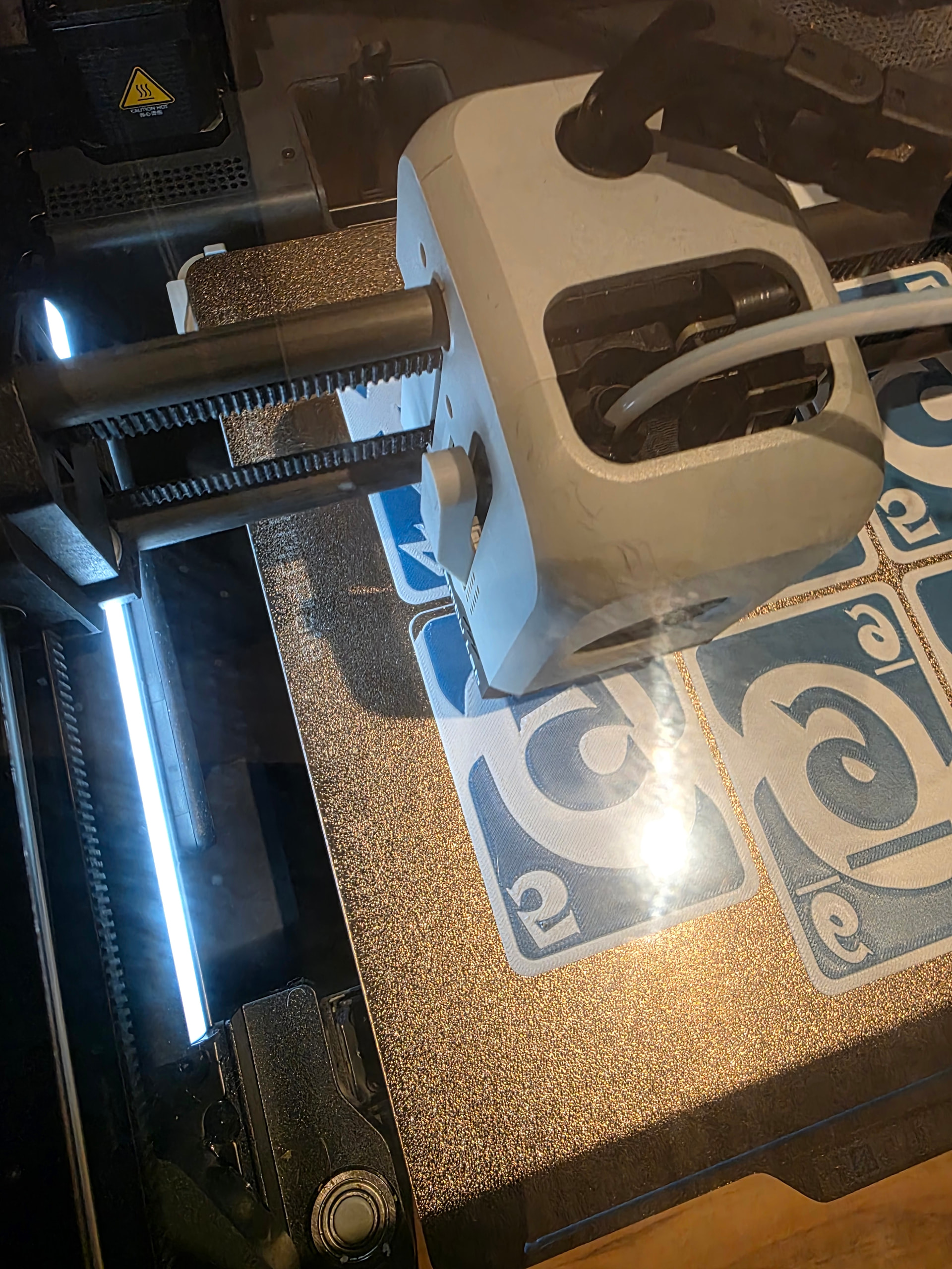

Here is a pick of something I am printing right now in PETG-HF. Also, one last note, I mainly use Bambu filament. I actually find the colors and easy of print to be the best. after that would be Polymaker stuff.
I also have first-layer adhesion trouble if the chamber becomes too warm. Even with the door of my X1C open and the glass top removed, the chamber can become too hot after the first print or two. A recent heat wave was giving me fits until I remembered this and used the shop A/C to drop the ambient temperature from 27°C to 25°C (80°F to 77°F). My problems started when the chamber temperature reached 39°C; the chamber temperature peaked at 36°C after cooling the shop.
it also shows the textured bed, which I have had almost zero issues with.

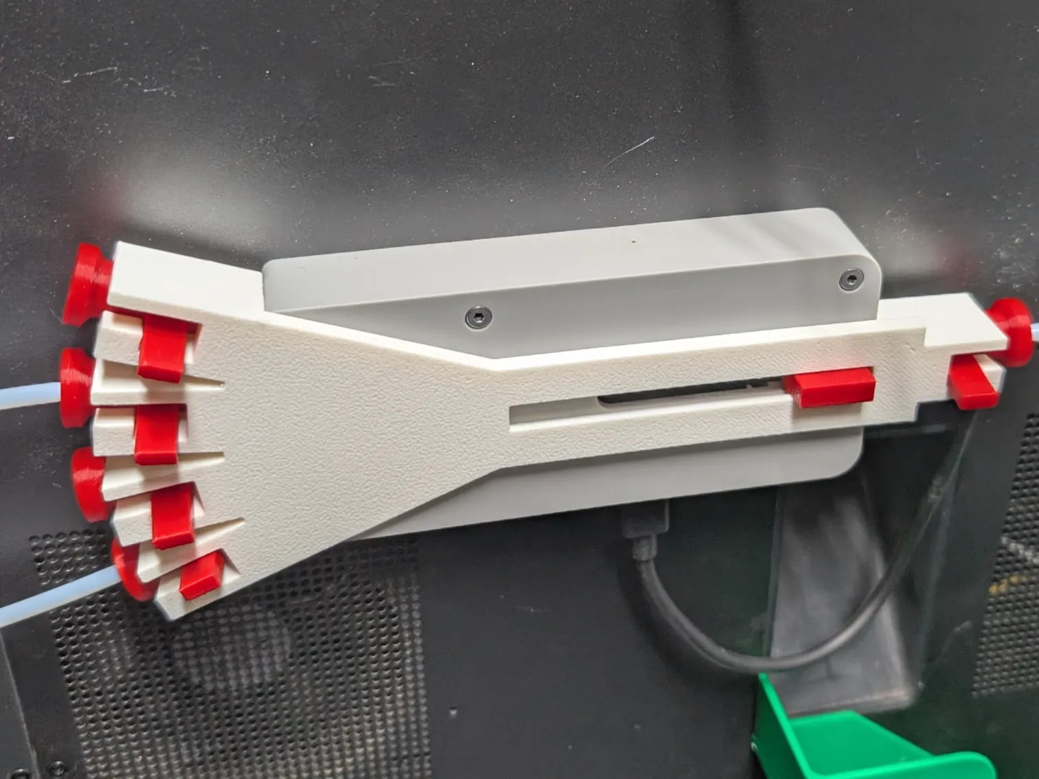

The following was printed on a plate prepared using this method. You can see some places where the texture is a little flattened, but it is mostly as one would expect:
https://makerworld.com/en/models/3009283-ams-hub-tube-guide-release-bahubguide#profileId-3379497

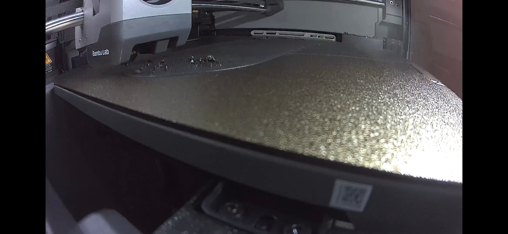

@Morphystation Has your situation improved? I"m at about the same spot you are. Well - more accurately I got about 50 hours in great. Then around 60 I had intermittent failures. Now at a 100 hours I’ve just realised I haven’t had a succesfful print at all in the last 20 or so. All failures.
This is stock P2S with AMS Combo. So .4mm nozzle, textured plate, bambu PLA pure.
I’ve tried:
- Washing the plate with very hot water and soap
- Giving it a wipe down with isopropyl
- Glue stick method
- Glue stick + hot rinse
- I’ve dried the filament
- Cleaned the nozzle
- Done flow calibration
- Done bed height calibration
- Done a cold pull
- Checked the bed temp
- Tried printing at higher bed temps
- checked the screws
- Fiddled with brim, ears etc
- Tried slowing first layer right down
- Tried doing the first layer even thinner
- tried doing the first layer a bit thicker
At this point - even taking all the “physical” precautions (checking humidity, ensuring the plate is super clean etc) - i cannot even print the factory installed benchy that lives on the machine itself. It just an immediate spaghetti failure.
I’m just soo tired. I haven’t even used a full reel of PLA yet and I’m spending this much time mucking about with a mahcine that’s marketed as supposedly way less fiddly than it’s much cheaper cousins.
I have a feeling that it got worse immedately post the 1.02.00.00 update so the next thing I’m going to try is rolling it back. But just wanting to hear if maybe you’ve had some success with something /anything?

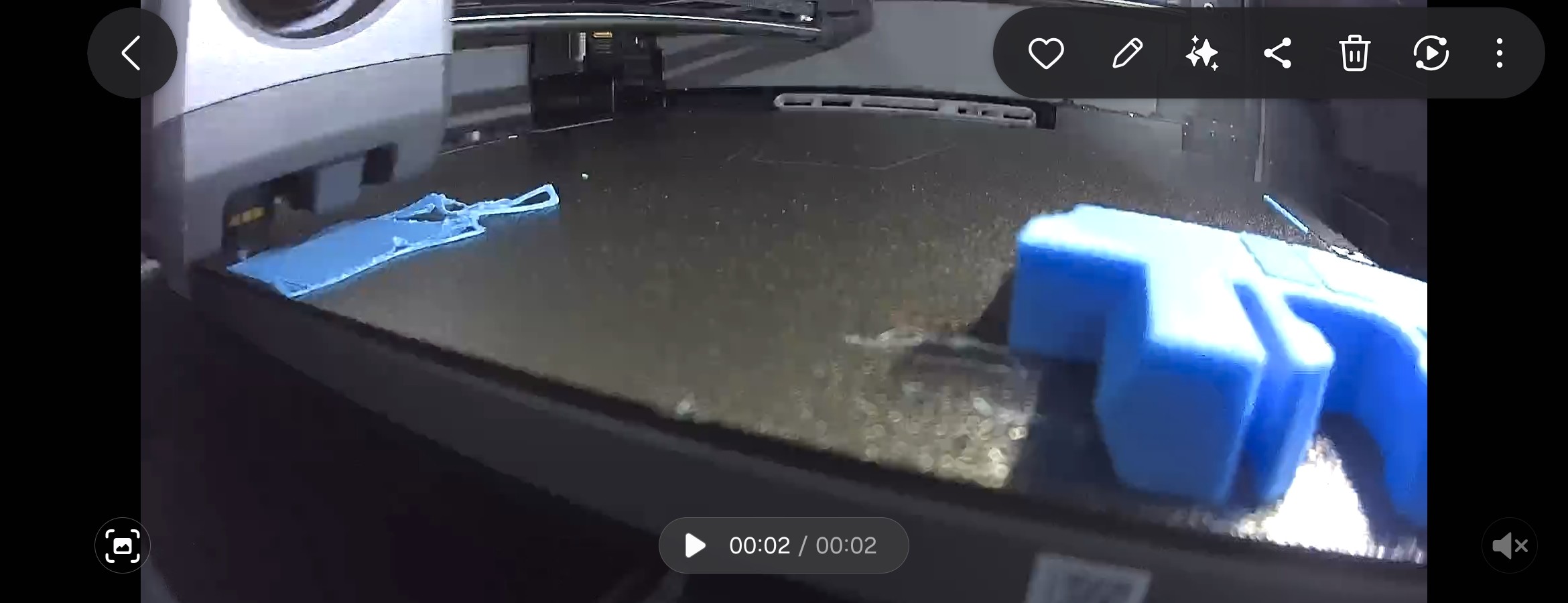

Oh should add - in case this is relevant - weirdly: the little calibration line it does up front work every single time. THat has never been anything other than perfect. But the second it moves to any other part of the heat bed it doesn’t stick.
