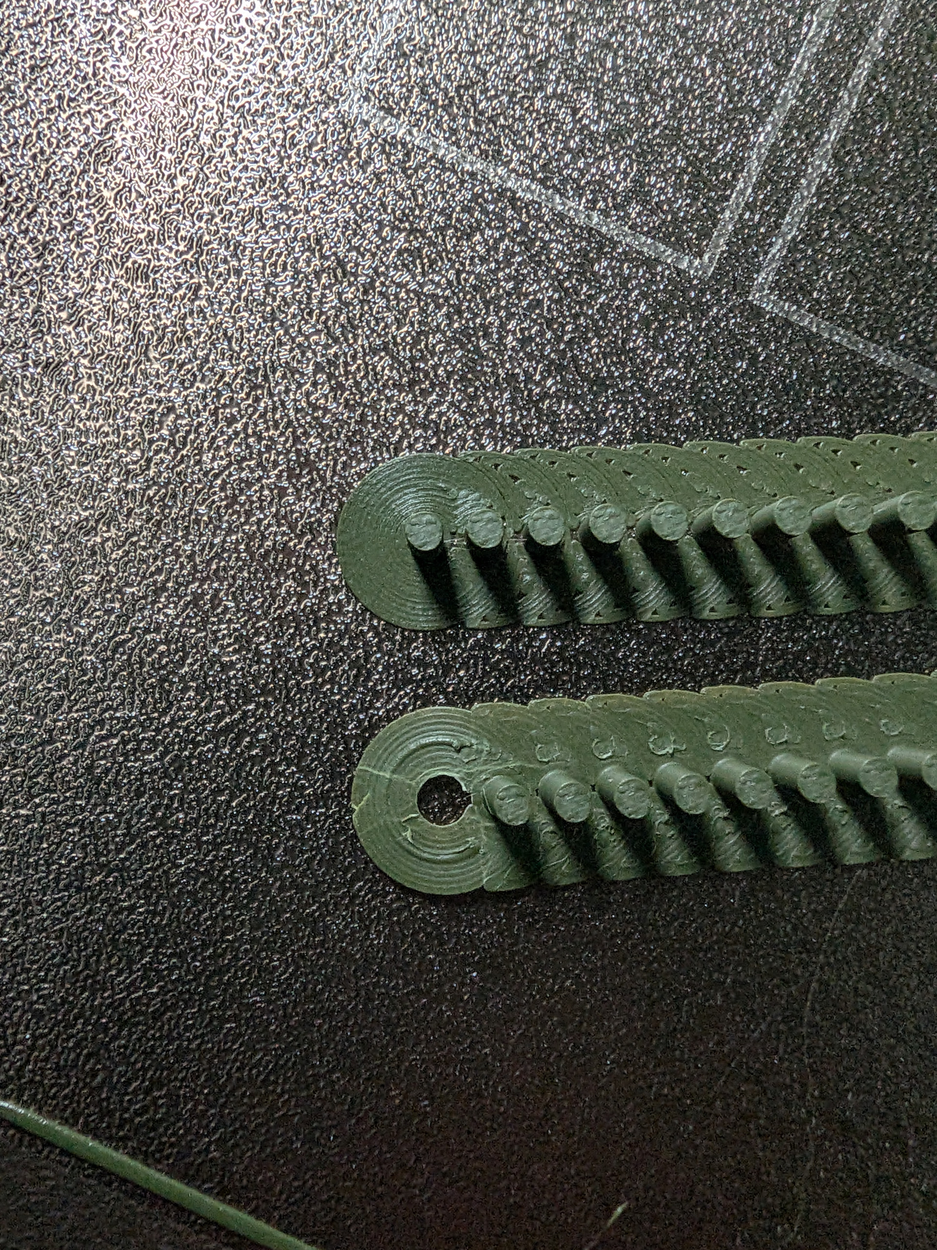

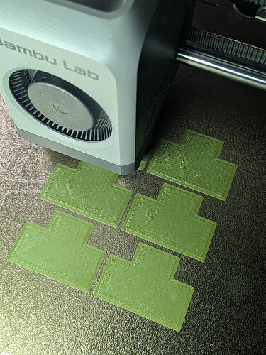

Hi,
I’ve recently started to see really poor brim quality/thickness and wall distance, yet I have made no changes to my printer settings. It seems on every print the brim and first layer look really rough, and the brim ultimately fuses to the outer wall of the first layer. This is proving to be a pain when the print finishes, as the brim no longer comes away from the model cleanly and I have to cut it off instead.
I’ve seen possible causes to be Z offset and the layer getting to much pressure on the plate, but I’m not sure why this would only now be a problem? I leave auto bed levelling and flow calibration on for every print, so should the printer not be able to detect and account for this kind of issue?
I had suspected a damaged nozzle after a failed print caused it to grind on some very roughly extruded filament for some time, but this is happening on a brand new plate and nozzle too.
Can anyone offer some suggestions on possible causes of this issue and how to rectify?
Thanks for any guidance!
From your picture it looks like you have a massive over extrusion on the first layer. This is what is causing the brim to be difficult to remove. The extra filament is squishing out and bonding to the brim. Since the brim doesn’t seem to be over extruding I would suspect you have a multiplier applied to the first layer of you print?

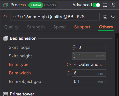

I would completely understand the brim settings themselves being at fault, but I am just using other people’s profiles with no adjustments of my own. The model/profile for the previously attached image is using these brim settings:
For a model that did not previously have an issue, but now does, these are the settings in use:

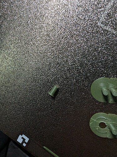

For the following elaboration on my testing, I am using a MakerWorld published model/profile from here. I have attached the 3MF file below as well.
Master+Chief+Helm+Split_rework.3mf (6.3 MB)
I am printing plate 4, which is just a number of small connectors with a brim, using the publishers default settings. I have not touched the brim settings or anything else.

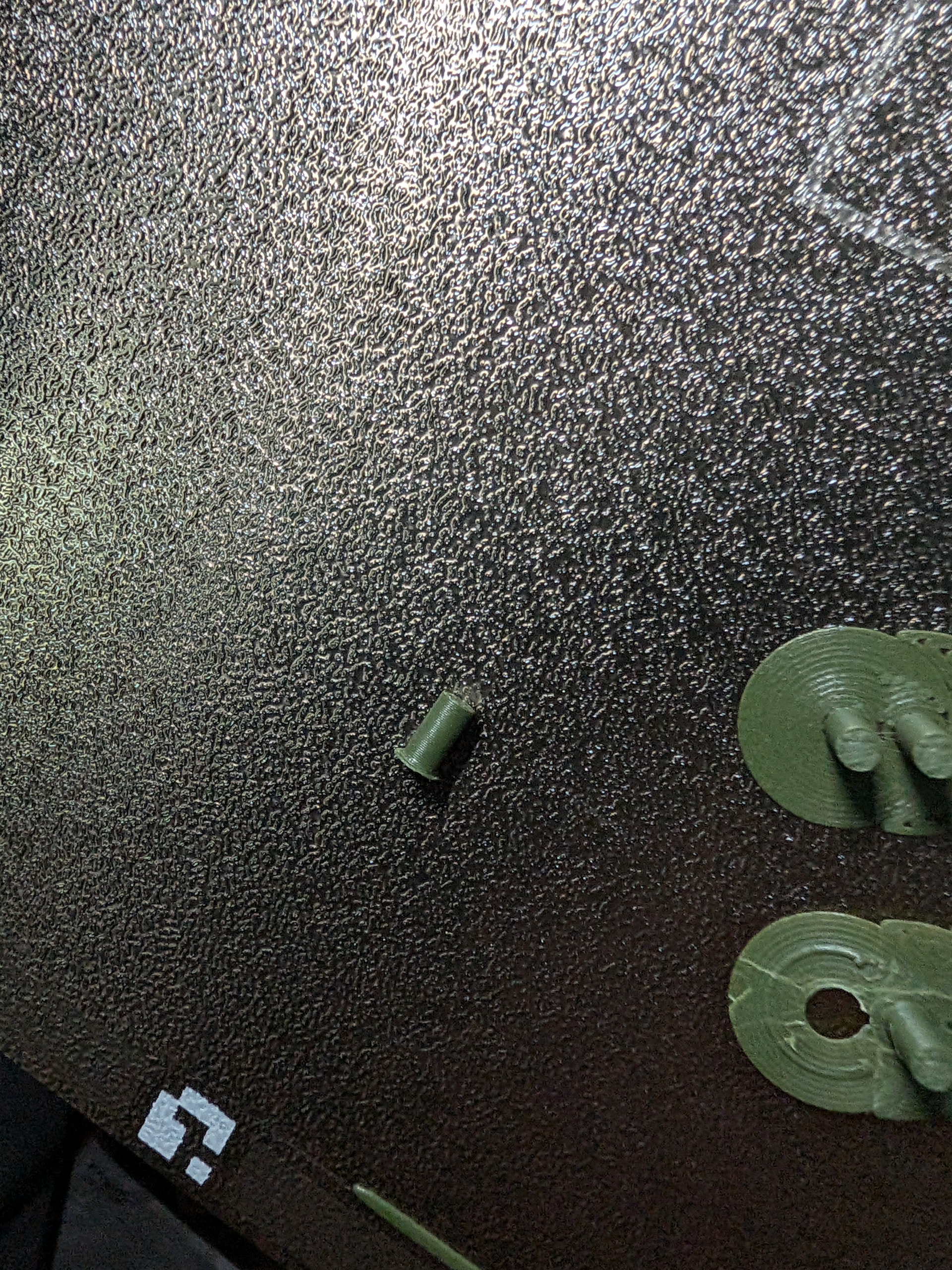

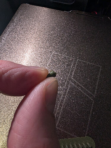

The below shows what the connectors look like when I remove them from the brim after the print has completed:
As you can see, the connector fused with the brim, so when removing the connector there is a lip on the bottom edge that I need to manually cut away.

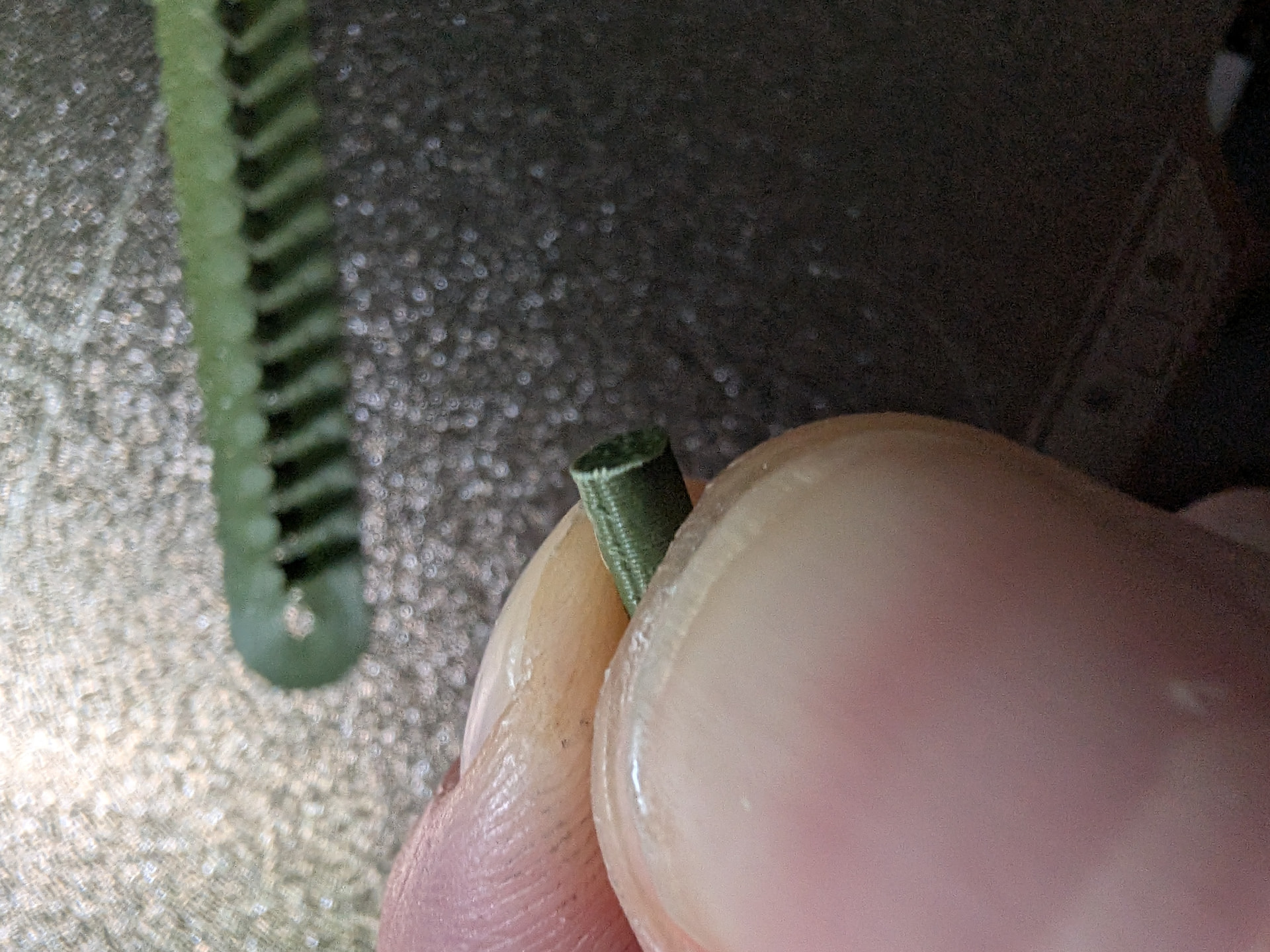

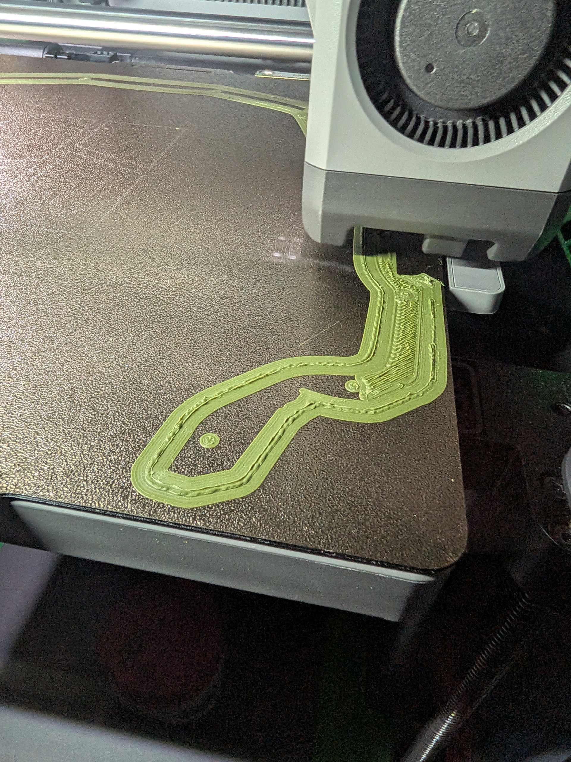

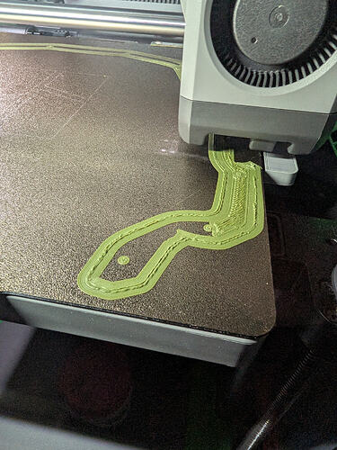

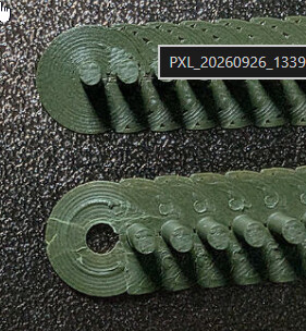

What I have then done, is gone into the manual first layer calibration on the printer, and moved the slider to the max setting of 0.05. This results in a better brim, shown below comparing the previous print (bottom) with the new print (top):
This is not quite perfect, nor as good as my brims have historically printed, but certainly a lot better. Below shows that the connector removes more easily with essentially no lip from the fused brim:
I can leave my manual calibration like this for now and see how future prints fair, but I am still confused why this has only now started happening with both existing models that were fine, and new models that I have not adjusted.

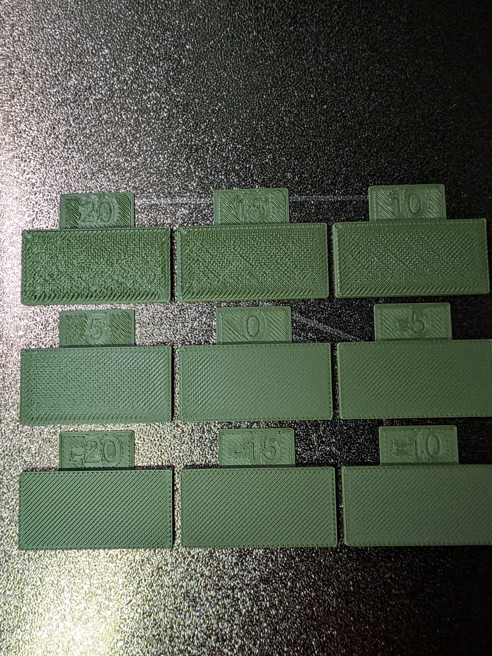

I would first recalibrate the overall flow rate and pressure advance for that filament. The bottom strip is over-extruded.
If the brim still adheres too strongly, leave the initial layer flow at 1, but increase Others→Bed Adhesion→Brim-object gap so the brim squishes less firmly into the part.
Running the manual flow ratio calibration, the first layer on all 9 blocks looks poor, but then the block 0 seems like the best quality top layer.
I wondered, as I have been using PLA matte for my recent prints, whether somehow my default BL profile has changed. Can anyone tell me what the filament profile flow ratio should be for BL PLA Matte? Looking at mine, it is 1.01 and I think PLA basic is 0.98, so wonder if it is worth testing in PLA basic to compare and reverting my matte profile if this is not the default value?
