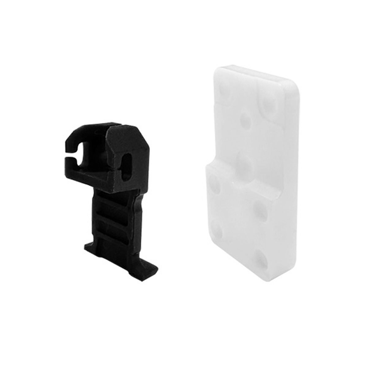

Mine also broke…after lots of digging I found these on via Chinese Taobao and then finally on Aliexpress.
Correct with holes on sides: https://s.click.aliexpress.com/e/_c3hr0c8L
