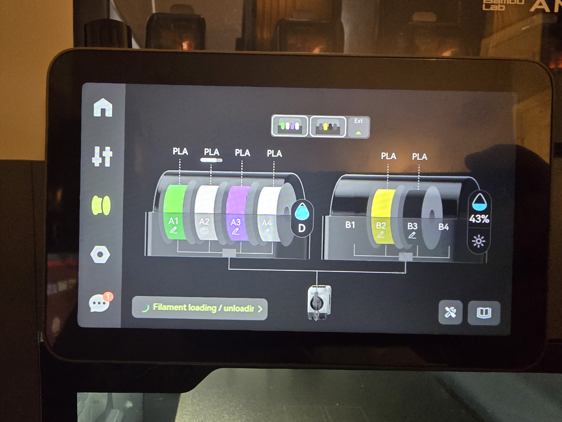

I recently had a problem in my extruder. I cleared the nozzle and now it thinks there is external filament in the extruder. I read the wiki. The hall sensor magnet didnt seem to go back the way it needed to, so I bought a new sensor. I went ahead and got a new nozzle as well.
I pulled the extruder out and opened it up. There is not filament stuck in it or the gears. I put the new sensor and nozzle on. I used the app to load the roll from the AMS and it still says there is still filament from the external spool in there.
The screen keeps scrolling “Filament Unloading / Loading…”
I have never used the external spool. I have two AMS hooked up. I am out of ideas. Any help?
Since you replaced the filament sensor I would check the connection on the toolhead board.
Yeah, I tried that too. I pulled the sensor out when I cleaned the extruder and put it back. When I put the new one in, I worked hard to get it in the right place. Now, I could have still screwed it up.

I replaced the hall sensor for the filament. I took the extruder apart twice. Nothing in there. I put in a new nozzle. Changed out the PTFE tube going to the extruder. I have no clue.
Did you look at the filament buffer?
Yeah. Did thay too. I cant even factory reset it because it thinks there is filament in it.

See what happens with no AMS connected, then with only one AMS, then the other.
I removed all of the AMS and the filament buffer. I then fed filament in through the tube manually to the extruder. This worked. It extruded it. I hooked it all back up and loaded from the AMS. Purged just fine. Started a print and the AMS stopped getting filament to it and the printing was “printing” without filament.
I went to get it started again and I got the same frickin external filament error again! After some reading, I saw it could be the filament buffer. I removed it and tried to open the board as it shows on the wiki, but two of the hex bolts stripped.

I cant factory reset it due to it thinking there is filament in it. I just replaced the filament buffer. Didn’t help. I have given up.
With no AMS connected, or two, ot still wants me to remove the external filament.
