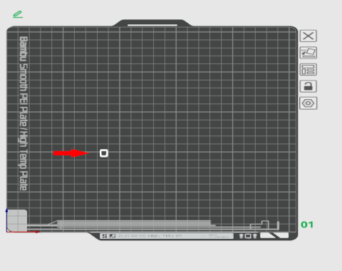

When I go to the Calibration menu in developer mode and choose Pressure Advance, it flashes the test print on the plate, then it disappears. Any idea why I can’t get it to work?
Windows 11, BS 2.4.0.70 and the Test that says “Pressure Advance”.
If I choose PA Tower it works, but if I choose PA Line it just shows type that says PA Test on the plate and if I choose PA Pattern I get absolutely nothing on the plate.
What do you see after slicing?
I am unable to slice since nothing is on the plate. Slicing is greyed out.

I did a fresh re-install, then installed it on another machine with a fresh install of Windows 11. Neither machine will generate anything.
Same thing happening here with BS 2.0.8.60 on windows 10.
More info: I can load the C:\Program Files\Bambu Studio\resources\calib\pressure_advance\pa_pattern.3mf project, then change to my printer, plate and custom filament settings and it will still slice properly with the “.06mm High Quality @BBL A1 0.2 nozzle” process settings, but when I try to change to my custom process settings, the primitive does not appear onscreen, nor will it print. Tower and line still work properly. Any ideas?
