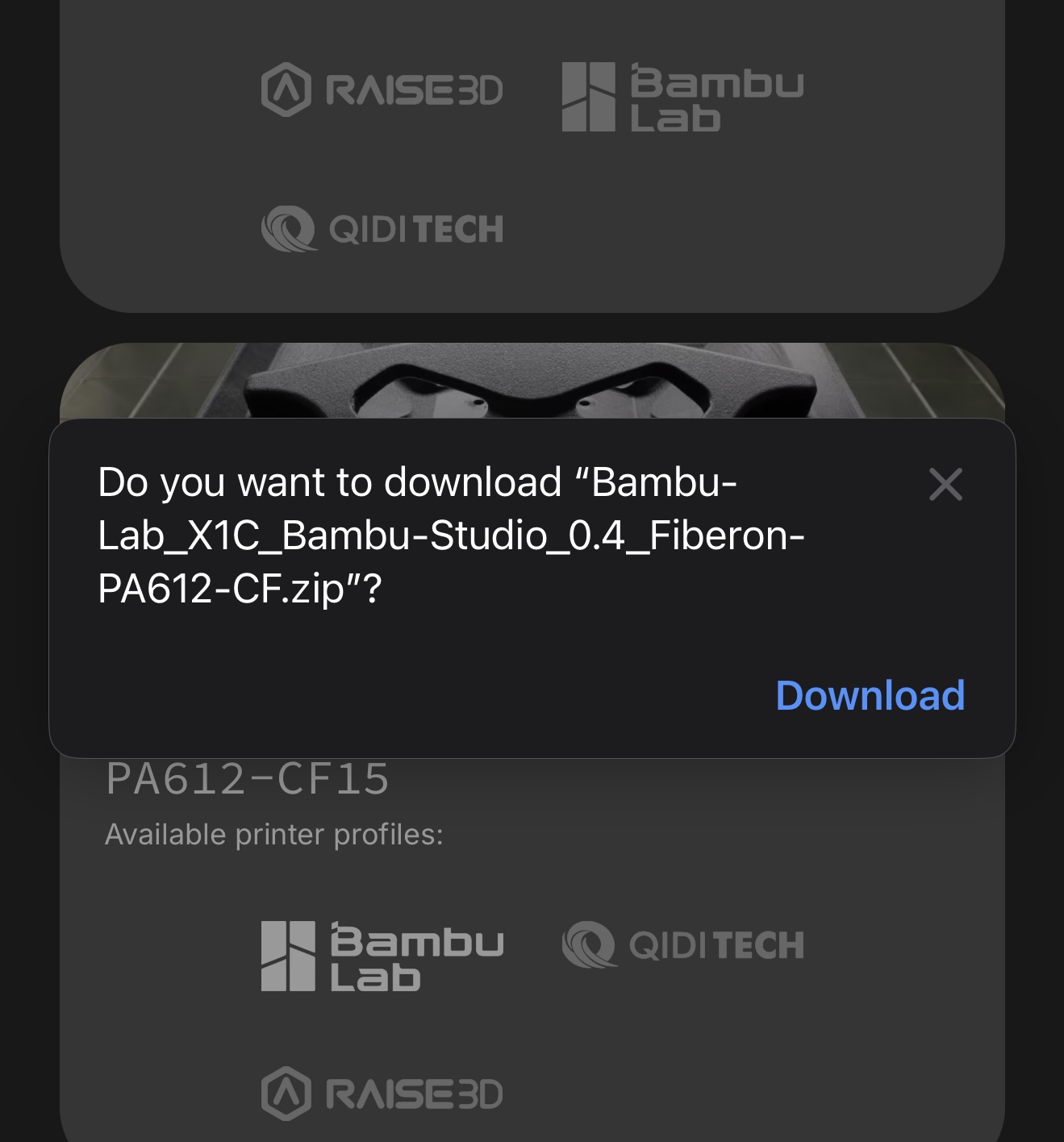

It looks like polymaker used a 0.4mm nozzle for their provided profile.
https://fiberon.polymaker.com/material-comparison/
Great, thanks, I was looking for that profile!
I know how to import it into Studio using the File-Import, but how do I make it show up as a filament in the list of available filaments?
Is it that I don’t see it because it’s an X1 profile and I have the H2D?
How can I fix that?
Thanks
EDIT: Seems editing the name in the .json file changing to H2D did the trick.

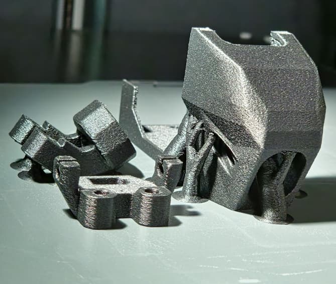

Zero risk. I’ve printed a ton of PA-CF and PETG-CF with 0.4mm. Not one single issue. No clogs.
PA-CF:
Yup no problem at all. I have over 8000 hours of printing PAHT-CF and other GF/CF filaments though HF 0.4 nozzles and never once had a clog.
