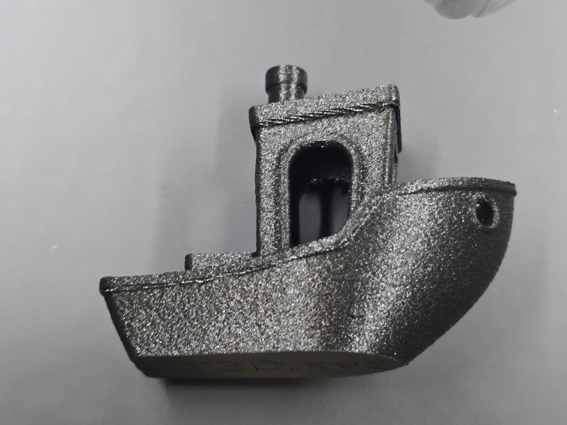

Just printed this Benchy in PAHT-CF on the smooth plate with vision miners. I had to wait until it cooled down to remove it. It was stuck really good.

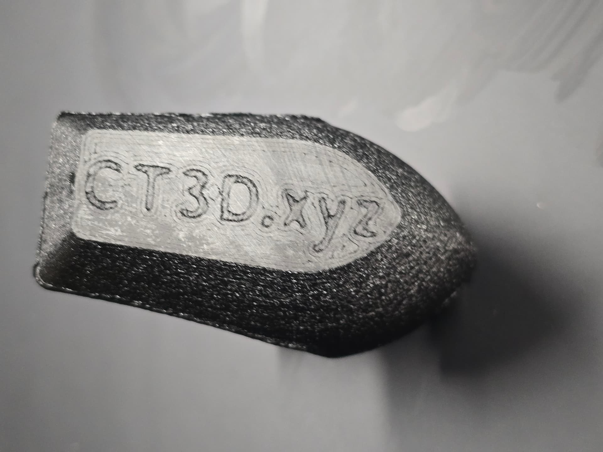

Received my BIQU gryogrip pro glacier and I made 2 testprints 1 with PA6-GF and 1 with PAHT-CF without any adhesive. Just a small box 100mmx40mmmx20mm. Both held on the plate and both finished. I have warping on PA6-GF, not with PAHT-CF.
I will try to tune the profile of the PA6 which I think part fan is too high but pleased with the PAHT-CF result for now with default settings. I hate glue as well so it’s good but I have to test print bigger part before I can say I’ve got a winner.

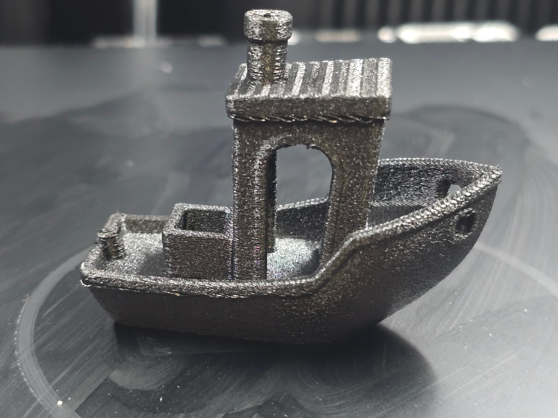

Small models can usually be printed without glue, but as soon as you go larger, you’ll need glue regardless of the build plate — at least in my experience. I can print a 3DBenchy or something about twice that size without any adhesive. For anything bigger, I use Magigoo Original, Magigoo PA, or my latest addition, Magigoo Supergrip, depending on the build plate surface.

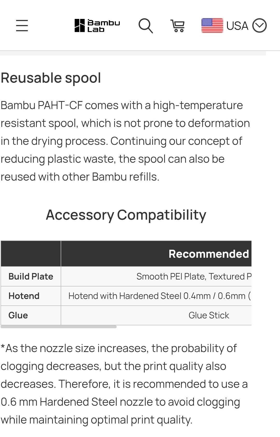

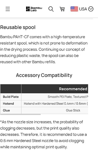

Bambu even recommends it on there website when you go to buy it.
