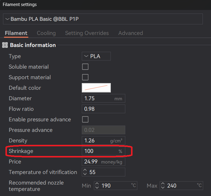

I can’t find a shrinkage number on Bambu’s site. But ultimately, shrinkage is generally pretty consistent, so I’d suggest printing a calibration cube and doing a little math to find the shrinkage percentage. X&Y are generally the same factor, but Z is generally a separate figure.
In Orca Slicer, the filament profile has a shrinkage adjustment for the XY, but I guess you need to manage the Z on your own because I couldn’t find an adjustment for the Z. Personally, I’d do the base adjustment and see how far off the Z ends up, especially if it is a relatively small print. Also note, the high temps PAHT CF is printed at may play a part in the shrinkage, so if you significantly bump either bed or nozzle temps you could find greater variances.
