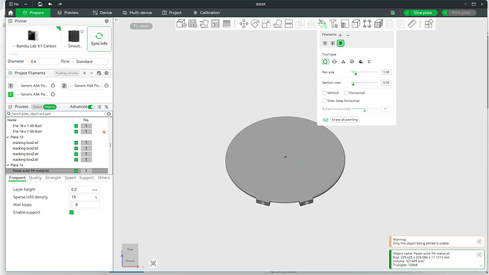

Painting stopped working
I have the newest version 2.2.2.56
I have a file that I have letters on it and have painted them a different color.
I have an earilier version, 2.2.1.6 and the painting works likes it should.
what can I do to get the newer version to work as before?

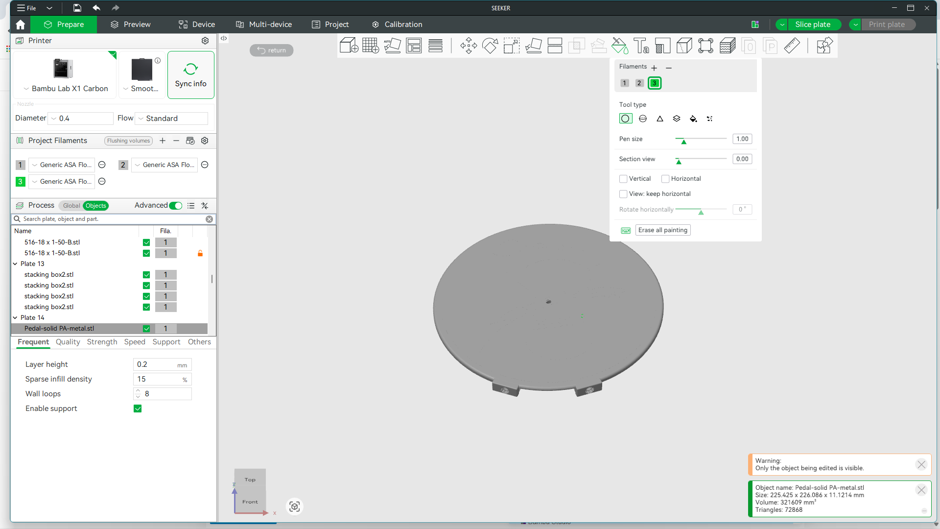

the first pic shows the colors and is working and the 2nd pic is not working, same file.
Can you elaborate on what you mean by “not working”? All I can see is that you put a couple of painted dots on the second picture with the circle tool.

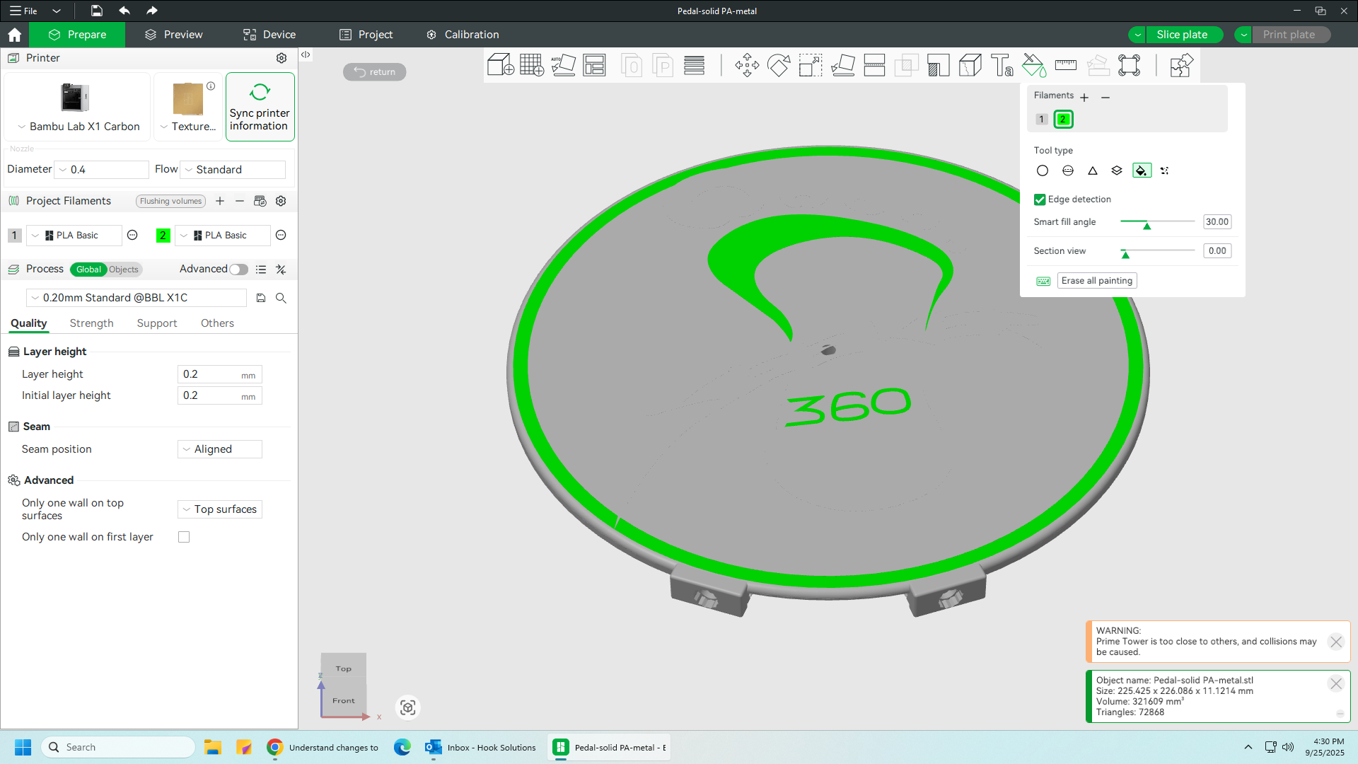

If you click the paint can, and then turn on “edge detection” it will work like the previous versions.
that did the trick.
Thanks!
