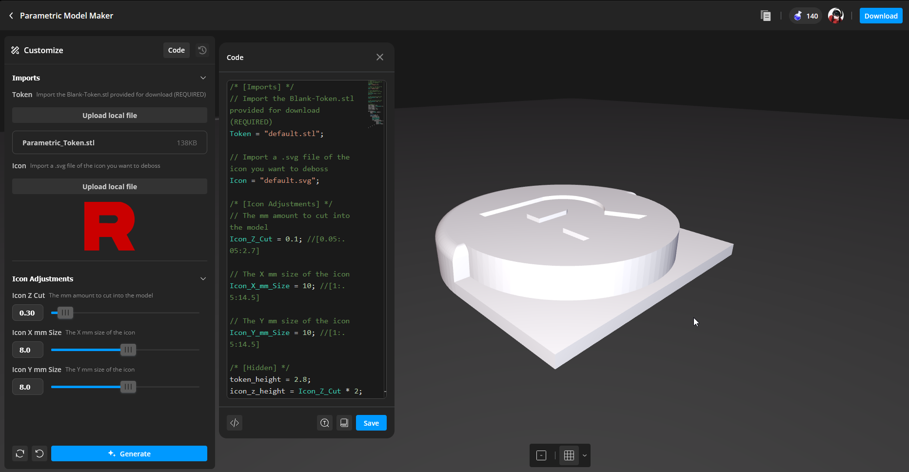

Currently, the only way to import an STL or SVG is by providing an option
While this works, it adds a lot of friction for the user. If they want to deboss a logo onto your model (like shown above) they have to download the STL from your page and then upload it.

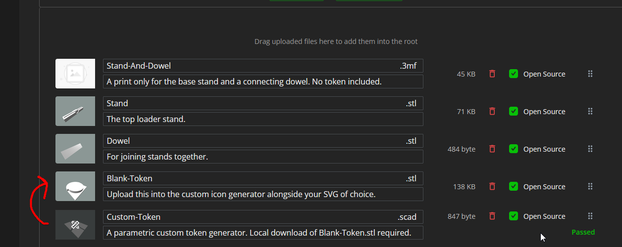

Suggested feature:
Allow the designer to set a new default STL (or other formats) for their OpenSCAD file. This could link directly to one of their models found here:

This feature basically already exists in OpenSCAD and Bambu’s Parametric Model Maker so I am not sure why I would need to make a feature request upstream.
In OpenSCAD, instead of importing from “default.stl”, you can provide your own local file path and import any STL / other supported file type that you’d like.
Bambu’s implementation clearly already uses this functionality considering that you can upload a local file that replaces Bambu’s “default.stl” import.
There is a LOT of friction in expecting the user to go ahead and download your model and then upload it just so that they can customise it. I’m simply asking that the designer can pick from their uploaded models to reassign the “default.stl” import that Bambu has preset.
