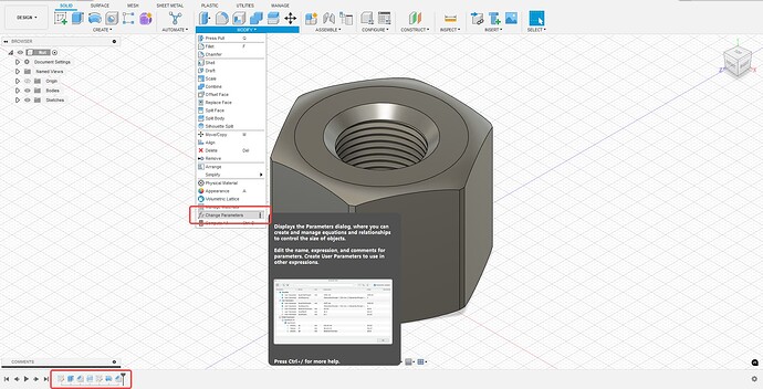

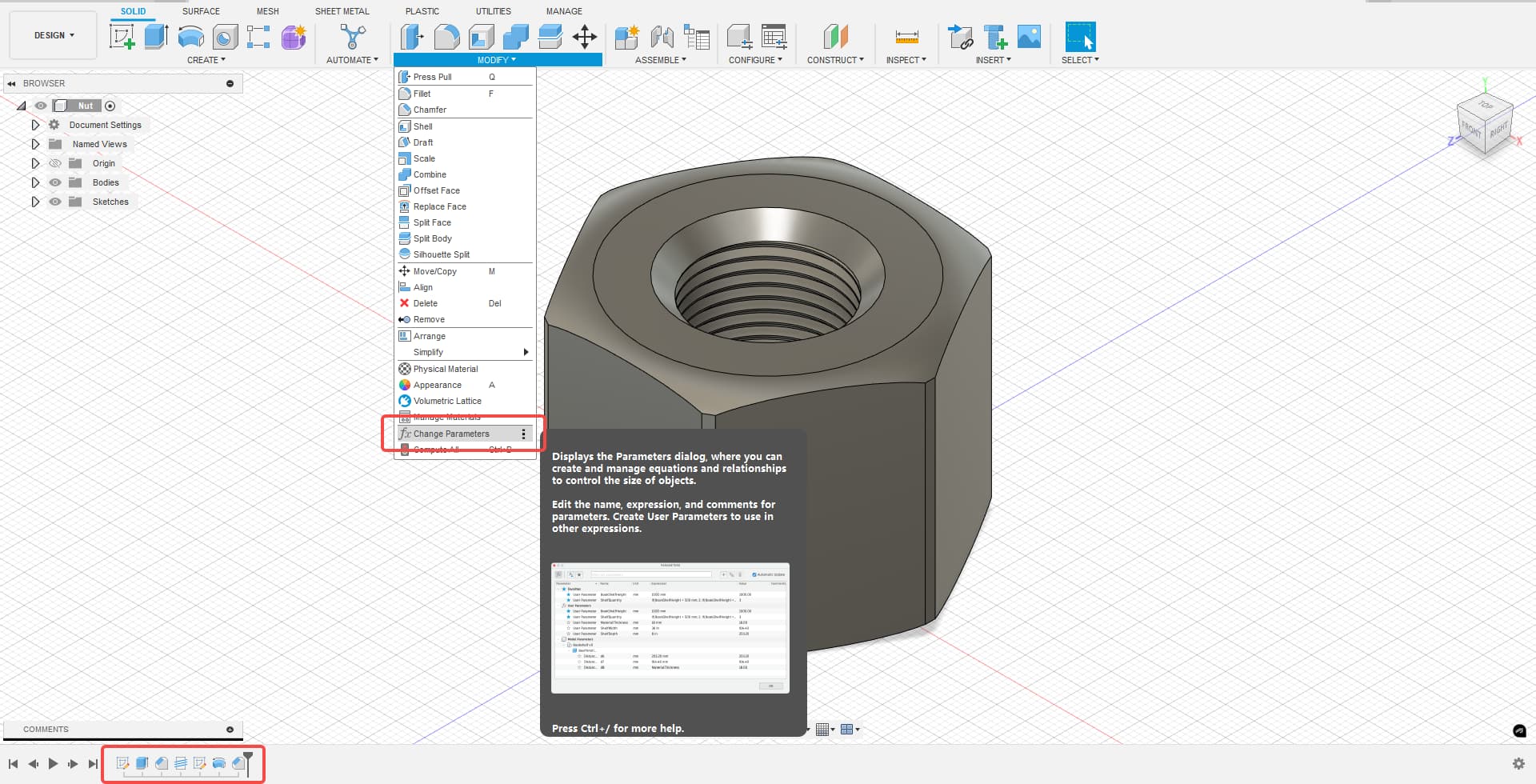

  1. Open the Parameters Menu
    First, ensure your model has Design History enabled (the timeline at the bottom). Then, go to the MODIFY menu and select Change Parameters.

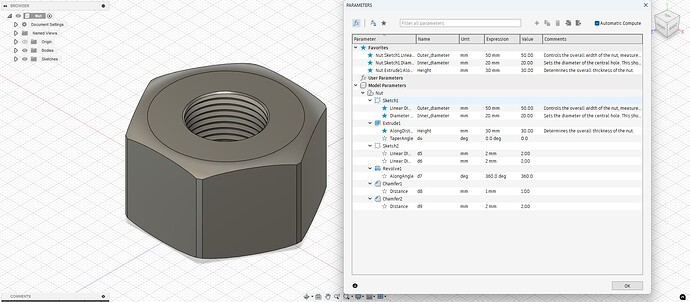

  2. Mark Favorites and Add Comments
    The Parameters dialog lists all of your model’s parameters. To expose them to Parametric Model Maker:
  • Mark as Favorite: Click the star icon (:star:) for each parameter you want users to control. Only favorited parameters will be used.
  • Add Comments: Write a clear description in the Comments column. This will be displayed as a helpful tip for the user.

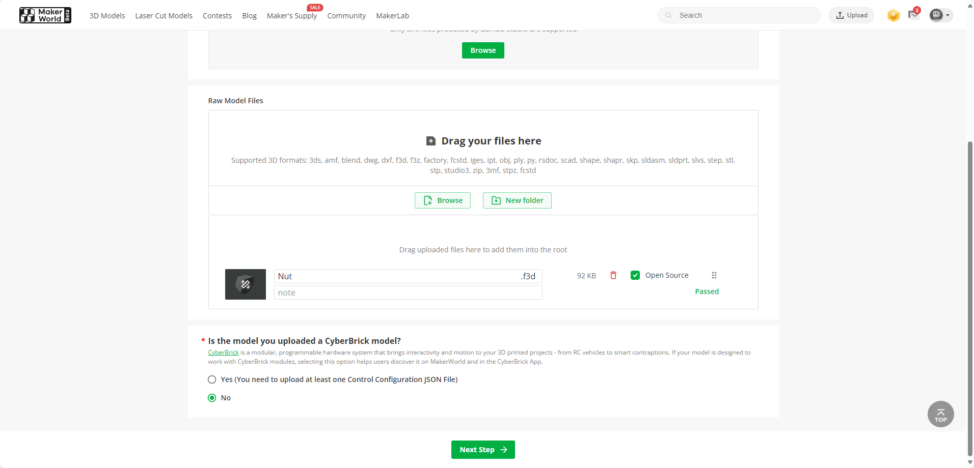

  1. Upload the F3D File
    In the Raw Model Files section, upload your prepared .f3d file. Here you can also choose whether to keep the model “Open Source” (allowing others to download your .f3d file) or closed source.
    Note: If you encounter a timeout error during validation, your model may be too complex for real-time generation. Try simplifying the design in Fusion 360 and re-uploading.

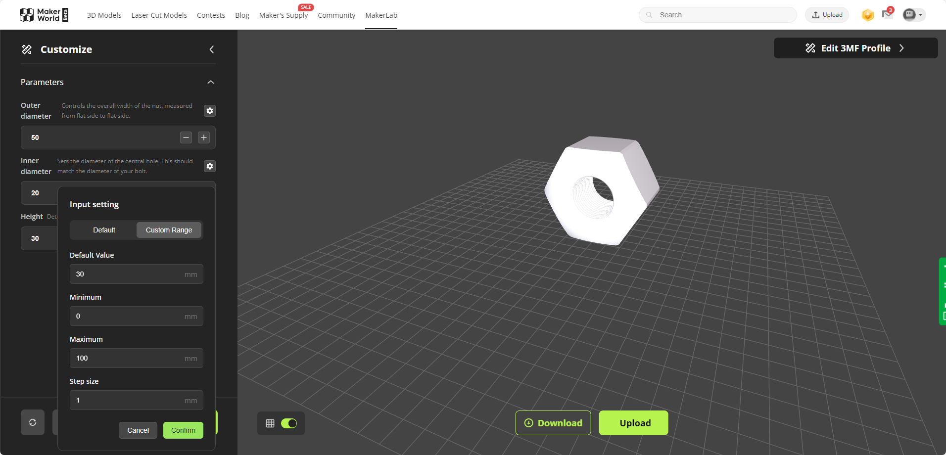

  2. Configure the Customizer
    After the file is processed, click the model’s thumbnail to go to the Customize screen. Your favorited parameters will appear on the left.
  3. By default, each parameter is a simple number input. To turn it into a user-friendly slider:
  • Click the settings icon (:gear:) next to the parameter name.
  • In the Input setting dialog, define a Default Value, Minimum, Maximum, and Step Size.
  • Click Confirm. The input will now be a slider.
  1. You can also click Edit 3MF Profile to control how the model is exported in 3MF format.
  2. Remember to click the Upload button to save the settings.

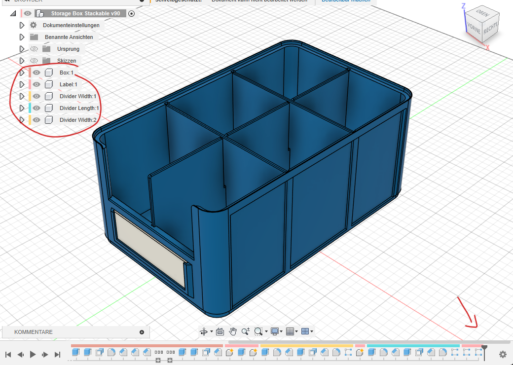

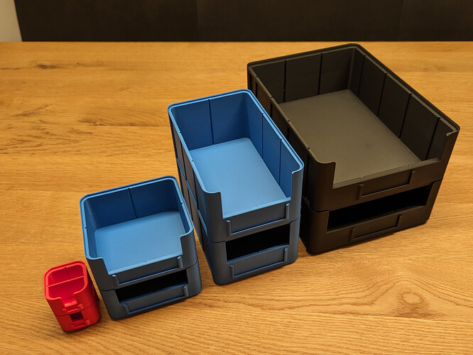

To showcase this new feature, @benjaminkott has contributed an excellent example: a customizable stackable storage box. Thank you for sharing it with the community! Feel free to try it out:

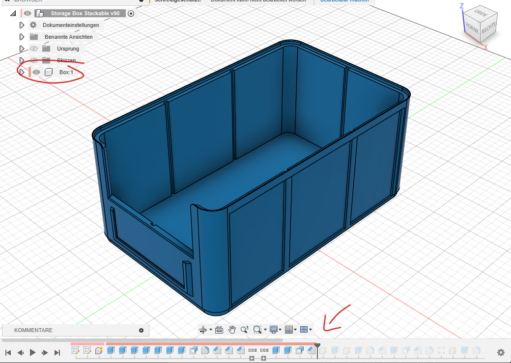

As far as my information goes, it´s currently not supported. But is something the development team is looking into. We also modified my sources to avoid using components for now, so it´s missing the dividers and label plate for now in the customizer.
State for the Customizer:
Full Timeline:

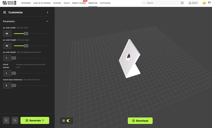

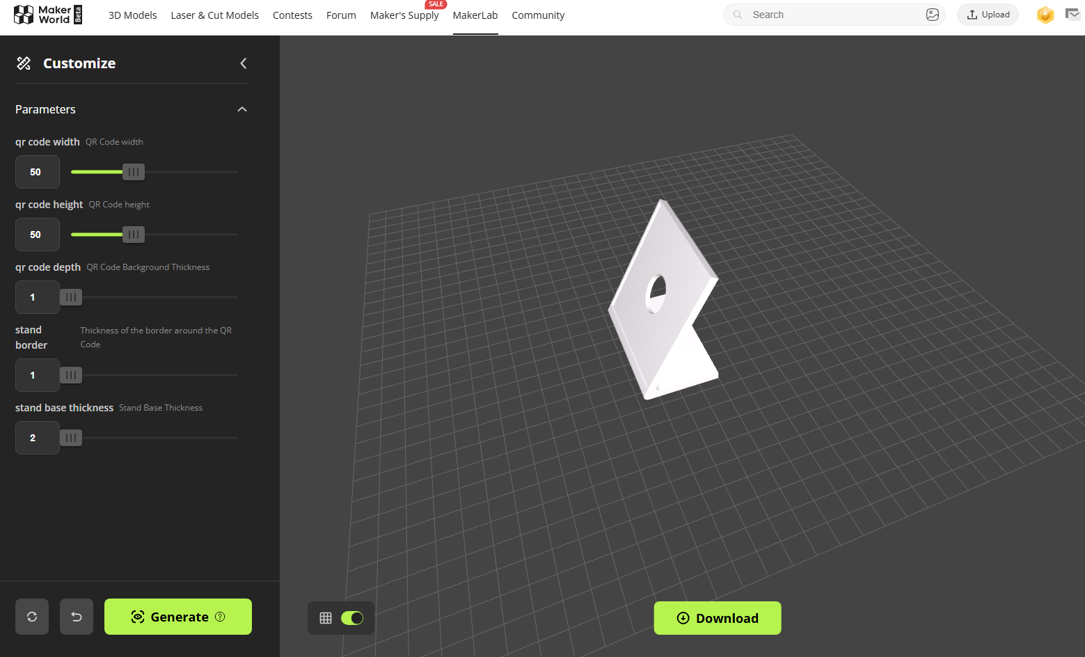

On my profile, I have a few Fusion 360 models. I’ve been updating the ‘QR Code Stand’ model to make the QR code creation process (and its stand) fully customizable via the web.
So now I have:
  • QR Code Generator (OpenSCAD model already customizable through the MakerWorld web interface)
  • QR Code Stand (Fusion 360 model now customizable through the MakerWorld web interface)
Amazing! :partying_face:

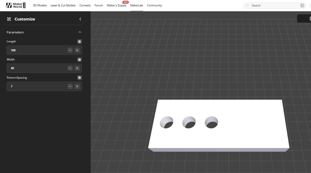

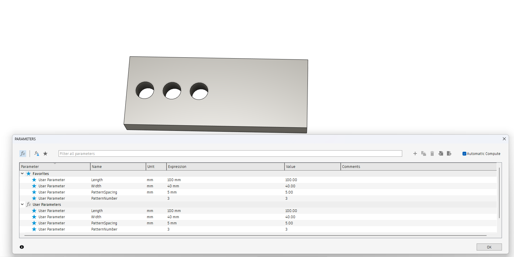

I tried this quickly with an existing file of mine but it didnt seem to pick up all the parameters. Namely this one “UNumber” which drives a pattern doesnt appear when trying to configure on makerworld. Does it not get picked up properly if its unitless or something like that?
Thanks!

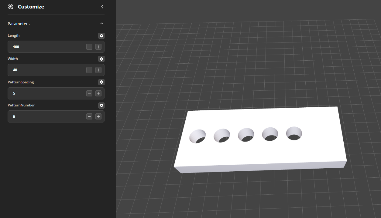

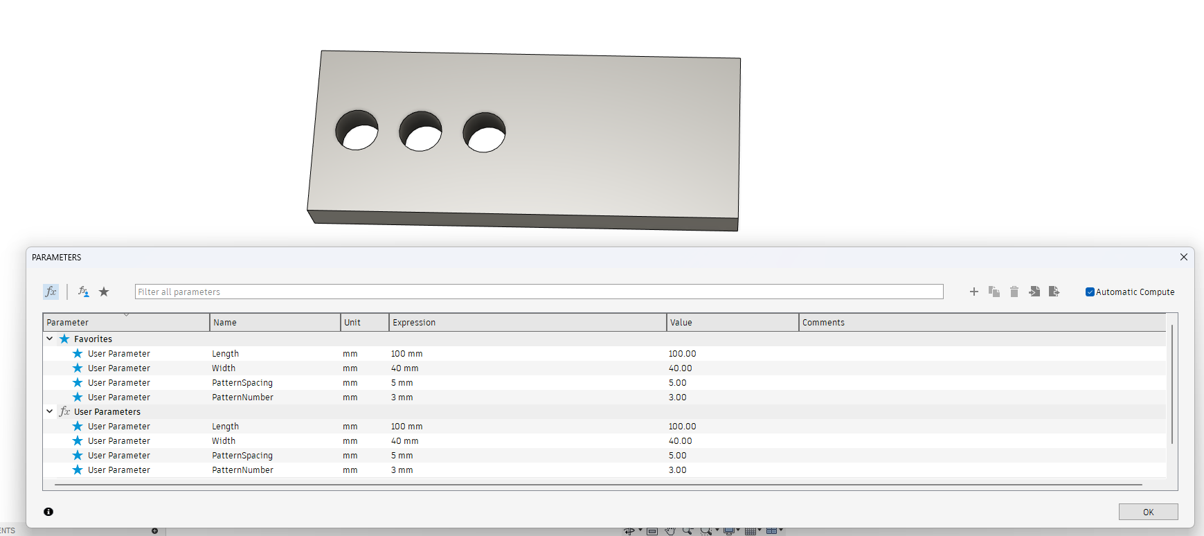

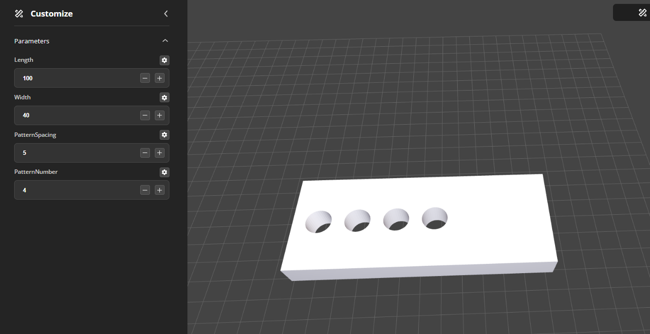

I made a simple example to test, and it seems the same problem again - cannot pickup a unitless parameter that was intended for number of pattern repeats. (or perhaps this just isnt supported?)
In this case missing the parameter “PatternNumber”
I would be too afraid to try this, as I have one of the few models that likely stress Fusion360’s computations with parameter changes. Nonetheless, it’s really cool to see this being implemented and would be helpful for new designs going forward.
Continuation of earlier messages:
Looks like I can fudge my way around the dimensionless parameter by making it have mm units, then dividing by mm when I make use of it in the pattern. Not ideal though!
