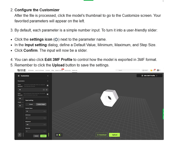

I tried to use the customizer to have it so one of my parameters would force the option that units had to end in .5. I set minimum 1.5, default 1.5, and step size 1. When i do that it rounds up the default value to 2 and then increments by 1. If any one has figured that one out please share.
Are you using fusion or openscad?
On fusion, what I usually do to “protect” the parameter(make sure that the user does not enter values that would break the model) is the following:
Let’s say I have a parameter called Height that can only be increments of 0.5. I usually have 2 parameters:
  • height: (favorite, visible to the user)
  • final_height : the corrected value, not visible to the user, here for instance the value would be floor(height)+0.5 or if you want to go more precise if(round(height)>height;round(height)-0.5;round(height)+0.5)
With this method you can make sure that the value used in your model is in the range that you expect. It won’t be the exact value that the user would have entered but it’s close enough.
What I ended up doing it similar logic. I forced the model to only allow full numbers. I expose a user visible parameter. But Fusion will add 0.5 to it. That way it will always be a value ending in .5. I was just hoping that Makerworld would have offered the control.
But thank you for your reply, your method is another way to solve for the problem. Hopefully others will be able to find either of our methods if they run into the issue.

Is #4 Edit 3MF Profile in above image no longer available. I dont have that option. I was able to only edit the below
Any way to bind it to an actual 3mf print profile?
