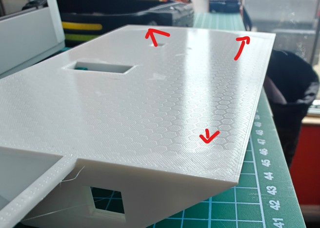

I have the bambu Lab X1 C for about a year now and overall it prints really well all the time. In the last few days I have been struggling with prints lifting on only the front left corner of my prints. I use a textured PEI sheet, I have a few and rotate them. I clean the plate with IPA after EVERY print. I washed the plates with warm soapy water recleaned with IPA, ran multiple materials from PLA Basic to PC to CF PETG but everything is starting to lift roughly in the same area. I inspected the hot plate and the magnetic sheet and everything looks good. Before someone said it the aux fan can be on and off with different materials and doesnt make a difference. Im really confused as I havent changed anything recently. Can any one offer any advice plz?

Example
That pic and the nozzle size info may be quite helpful. The text only description gave a different impression from what the pic shows.
Increasing bed temp by 5°C and nozzle temp by 5-10°C for the first layer only (!) could be helpful.
Mouse ears with a low brim gap may also help. There is a chance though that warping may lift the build plate off the heat bed. Clamps are said to be available on makerworld but to truly counter warping, you need to have a look at your chamber temp, layer height and speeds.
For example, you could lower the layer height since a high layer height puts a lot of warp inducing heat into each layer. That is particularly important since layer height is frequently coupled to nozzle diameter.
Do you have it in an enclosure/tent? The door leaks a ton of air (front left) and the other areas I wasn’t happy with for the same reason. Got an el cheapo 60$ 3d printer tent and my “random” warping issues ceased.
Thats very interesting thanks… i did increase my layer height recently and forgot about it. i will have to check to see if that works.
Thats actually good to know… its weird though bc it never happened before and there were other more severe temp differences previous to this. I thought a fan may have stopped working. I need to monitor the internal temps i think
Ya, drafts are the biggest warp causers imo, which is why I was so disappointed with the x1c “enclosure”. I wasn’t even able to get it up to the 60 celsius they advertised until I got the tent. Be sure aux fan and chamber remain off or lower, and part fan off for the first 4 or 5 layers. Another thing that helps prevent warping from the bed is for example, say you have a filament that is temp range of 200-240. For the initial layer, set it lower and the upper layers higher, to combat the temperature differential experienced during application. Meaning, initial layer: 230, all other layers:240. This way the bottom layer doesn’t cool as much because it’s because heated above and below, hopefully allowing more adhesion by the time average temperature settles. (versus if you do 240 on the initial and 230 on the above layers; that causes FASTER cooling of the initial layer, which usually leads to warping)
