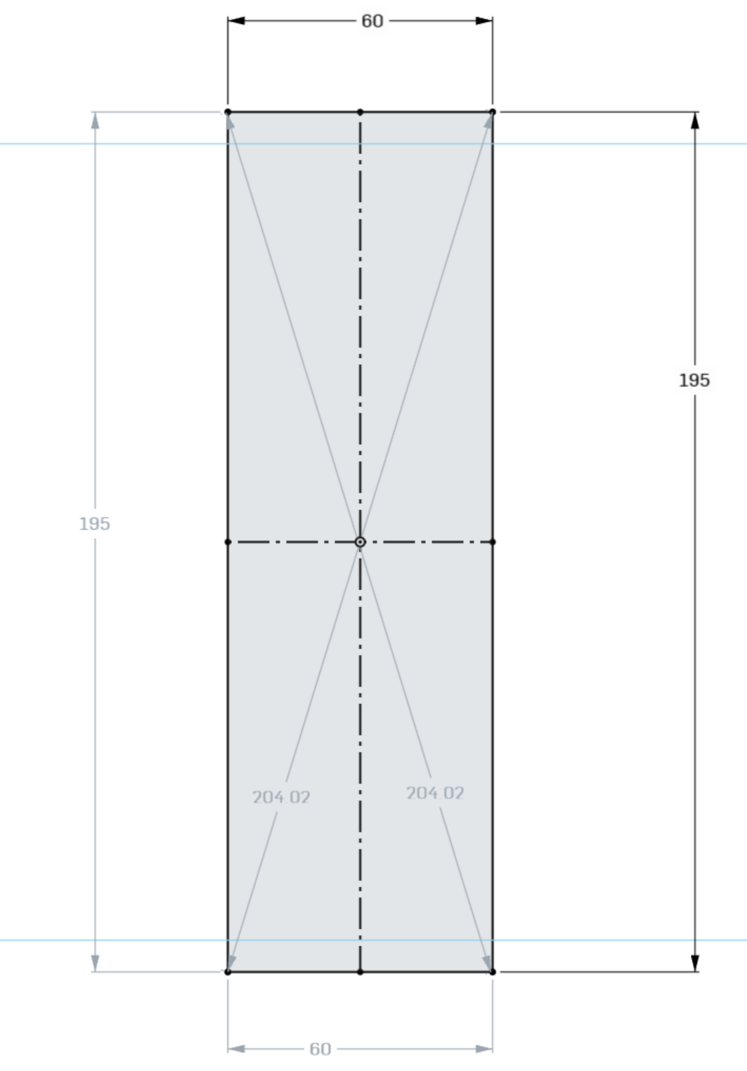

I have verified in my CAD software that the parts I created are 100% perfectly square. However, part after part that I print are not square.The longer the part, the more pronounced the out of sqaure issue presents. I am using a P!S about 6 months old. I have calibrated the plate several times. I have tried Bambu and Elegoo PLA set at proper temps usng the standard print profile on a supertack plate and textured PEI plate with glue. I am using a hardered .4 MM nozzle and and verfied it is tight. Other than the out of sqaure issues, the prints looks perfect. I printed several sized rectangular objects from different CAD programs using different project settings and they are all of our sqaure to some degree. Any help would be appreciated. Thank you.
Here is the image from the CAD sofware showing perfect sqaure.
Here is an image showing out of sqaure, and I did try two different sqaures with the same exact result.
