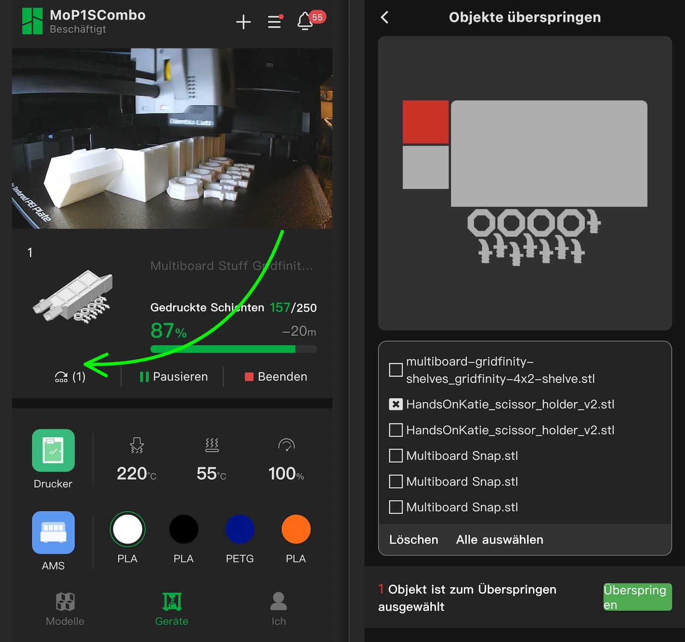

Is there a way to pause during printing and remove an object from the plate and tell the printer to stop printing that one object?
I had the following problem, I had four parts printing and one of them came off the print bed and I had to remove it so it wouldn’t come off the other parts. After that, the printer wanted to continue printing the removed component and produced a lot of spaghetti because it printed into the air. Is there a way to prevent this?
YES, there actually is!
It seems you can currently only do it via the mobile app - Just tested it out: I paused the print, then tapped onto the small icon with the 3 boxes and the curved arrow and the text “skip”, then you see a top view of your print bed and can select the model directly and chose to skip it!

One thing to note, my P1S will finish the layer it was on even when I skip that object. So you may need to “babysit” the print until that layer is finished.

Hi, I did not even pause the print. I just went into the mobile app and followed the instructions above. And when printing the next layer, the printer just skipped the selected part.

It is in the current Studio beta, only for H2D and X1C with the newest firmware so far

When slicing, if one plate has multiple objects, the slicer will give each object a number in Gcode. When you use the object skip function to skip an object during the printing process, the printer will skip the Gcode that belongs to this object and not print. (Note the difference between objects and parts in Bambu Studio: Split to Objects/Parts | Bambu Lab Wiki)
You definitely earned a “thumbs up” for that one. Thanks! I knew that feature was there somewhere and don’t want to tell you how much time I wasted in Studio looking for it. As soon as I saw your post I went back and saw the tiny curved arrow icon in the Printing Progress window. D’Oh!

This has already been answered bit i thought I’d point out that not pausing when skipping is better than pausing then skipping, the latter sometimes misses a bit, or it did for me anyway. Just skip mid print. Best feature of all time.
