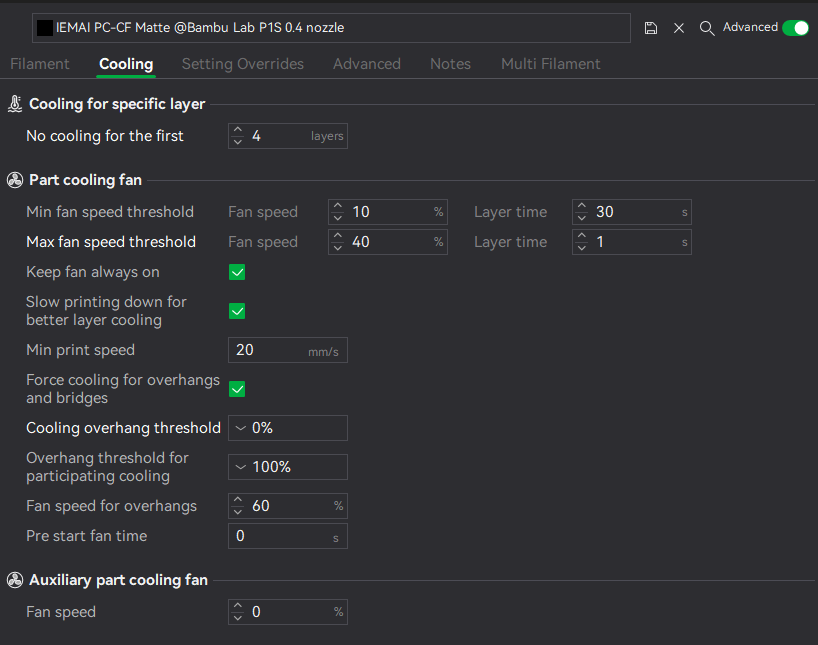

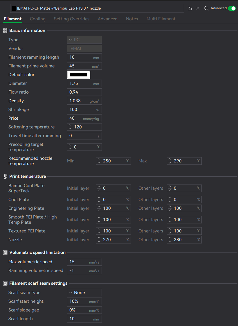

Using the TDS and MSDS sheets, I made my own profile in Bambu Lab for this specific vendor/filament. I decided to just jump in and print a benchy. So far so good.

Was this the pc-cf? What temps are you running? You may have better luck using the textured plate. Youll also want to add a brim of atleast 5mm with 0 brim to part gap. Also want to let the chamber heat soak a bit before starting by running the heater bed at a high temp. Fans off for printing. Including exhaust
Oh and as always, make sure the plate is clean. Dry with a paper towel
Yes the same I mentioned in the top post.
Decided to slow it down and see if that makes a difference as well but now I am using the cryogrip frostbite plate.
Done! Not too shabby
For anyone interested. Here is the successfully printed nose cone for my son’s rocket project.
I used the cryogrip frostbite build plate to make the parts stick without glue. I even got the printed weight prediction pretty dialed in. The slicer said that it would be 246g as configured and it ended up being 249g.
Thanks to those of you that contributed!
Hi @WilliamXO – can you share your bambu studio filament profile file or share your settings… I haven’t been successful at getting PC-CF to run on my X1C. Thanks in advance for any help
Here is a link to the zipped up IMEAI PC-CF filament I was using for these nose cones.
@WilliamXO thank you so much…
