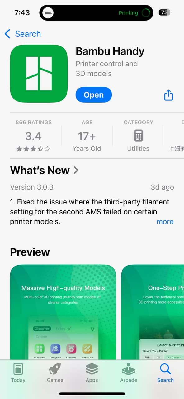

similar issue
pc apps works fine
doesn’t work on ios but does work on pc slicer
reboot phone
logged in and out of app
ios app won’t view camera or sd files
pc app works fine
Do you have LAN Mode on or Connect Via Wifi? Because if it’s via LAN it has to be on the same network and you need to enter the access code.
It can be a factor as it happens with my A1.
