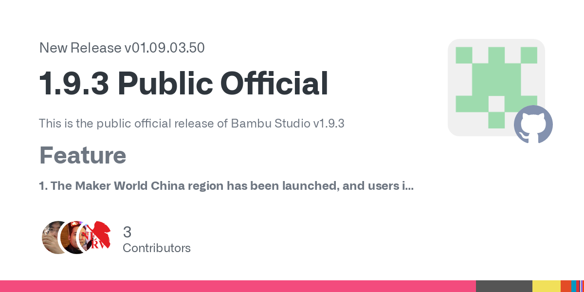

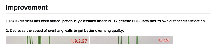

also pray tell, where did you learn PETG is being replaced with PCTG?
Thanks for the link! (how did I miss that mention!? gotta read closer lol)
