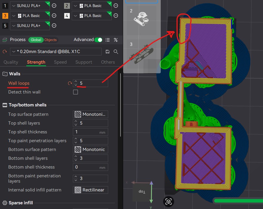

Perimeter wall thickness, what's that and where is it?
Some models mention parameters to use while printing, some of them are :
  • 3 perimeter wall thickness (for .2mm layer height)
what’s that and where is that parameter?
Hi @razorree,
I think that you are searching for “Wall loops”
This setting can be found under the “Global” or “Object” Process in the "Strength" TAB
What this do is simply making the wall thicker.
Here are 2 examples where I changed the values:
Standard 2 walls : you see one orange outer line and one yellow inner line
Adapted 5 walls : you see one orange outer line and four yellow inner lines
I hope this was the answer you are looking for.
Br,
Muloo
thx. wasn’t sure if wall loops was the same as “perimeter wall thickness”
