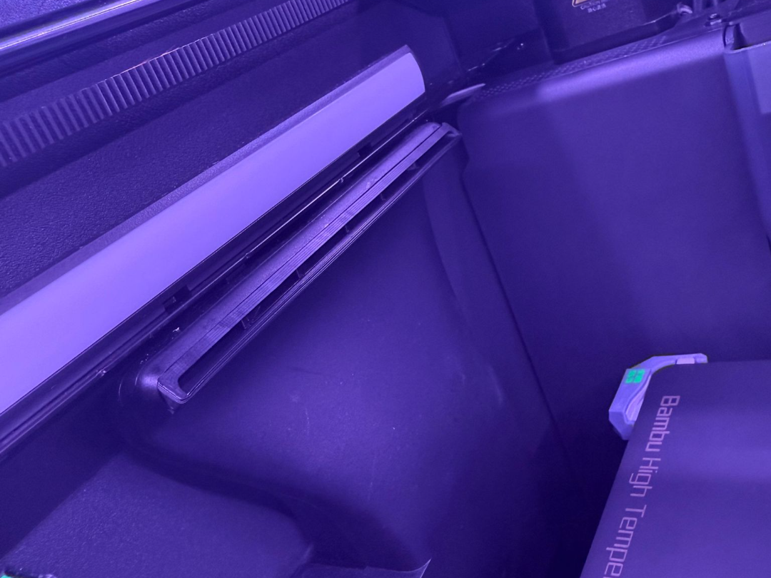

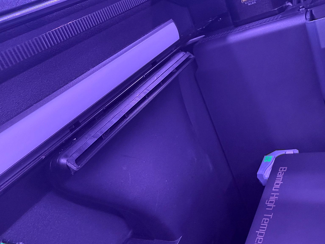

PS: Dont judge me on the bubblegum pink. I inherited a fabulous array of random 1-2m long samples of dozens of colors. My only regret is not realizing a long time ago that the secret to printing with TERRIBLE old dry PLA filament without it curling up is
  1. Print a diverter for your aux fan which aims it upward at least 45°, so it doesnt actually hit your print but provides circulation
  2. Open/Prop the Top - because I’m one of those poor suckers who, if I close my machine entirely, it will IMMEDIATELY heat creep 100% of the time.
  3. CLOSE the door - keep the fresh air from flooding in, but the mild circulation caused by the diverted aux fan and the open lid lets out any excessive heat, which prevents heat creep.
The diverted fan keeps the air circulating with the top open to preclude heat creep, but without directly cooling your print, and keeping the door closed keeps the chamber warm which reduces the cooling gradient between the freshly printed upper layers vs. the consistently bed-heated bottom layer which, even on small footprint items, if printed with garbage filament, will almost ALWAYS curl and get all wonky, with laughably no help from Rafts/Brims whatsoever because that old filament wants to WARP and there is no physical way to stop it!! … except to reduce the thermal psychics which make it warp in the first place. Boom.
Oh, and this works as a panic fix if your prints ever start grinding at the corners (a sign your corners are starting to lift, that thing when the infill starts getting bumpy and/or stringing, and then catastrophically fails from impact). You can boop the door shut and kick the aux fan on (PRINT THE STUPID DIVERTER) and it’ll almost immediately stop grinding and go back to printing like normal again. I’d rather risk a heat creep clog than a busted printer from an impact and/or due to a print curling up and releasing mid operation.
