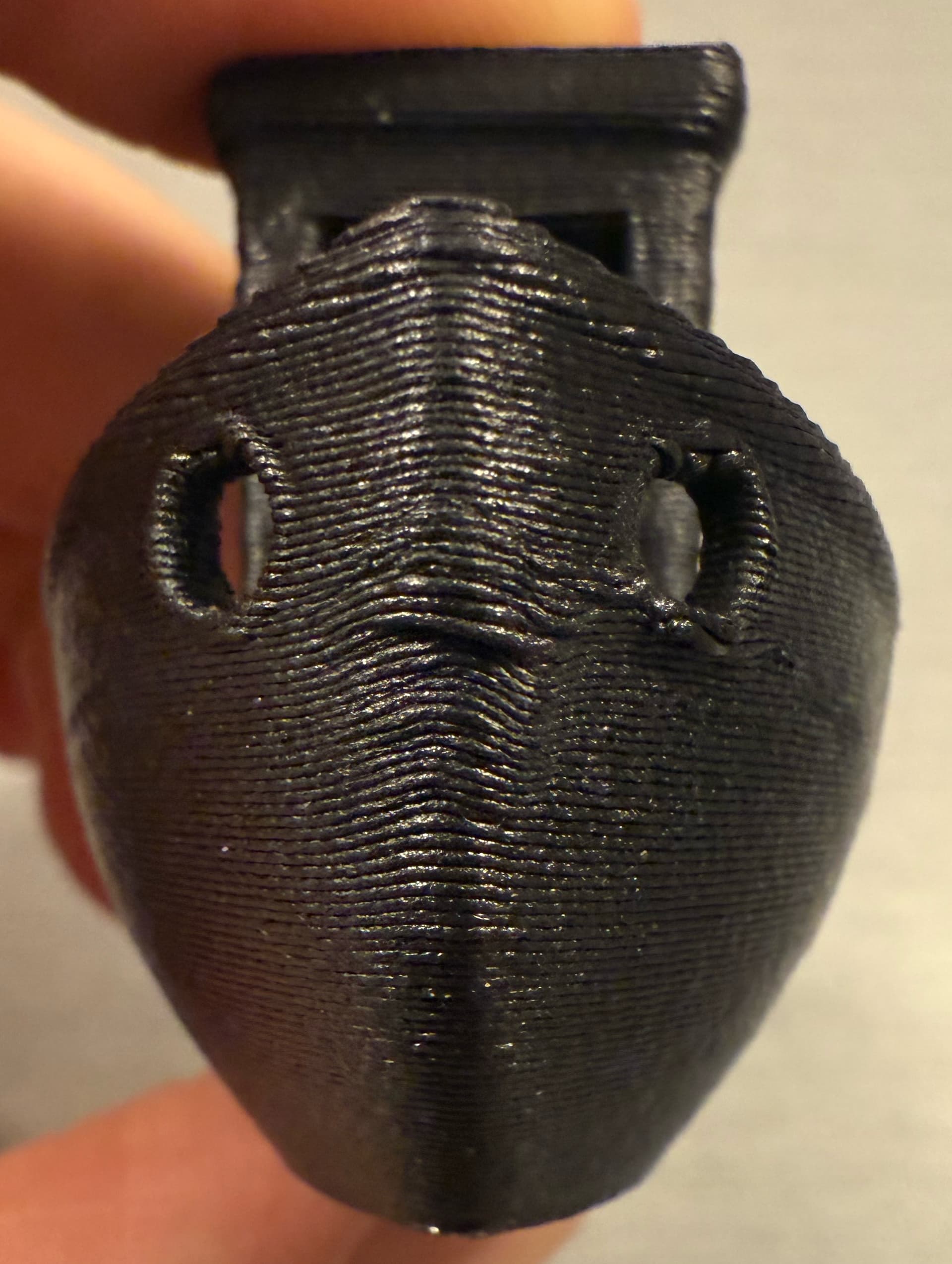

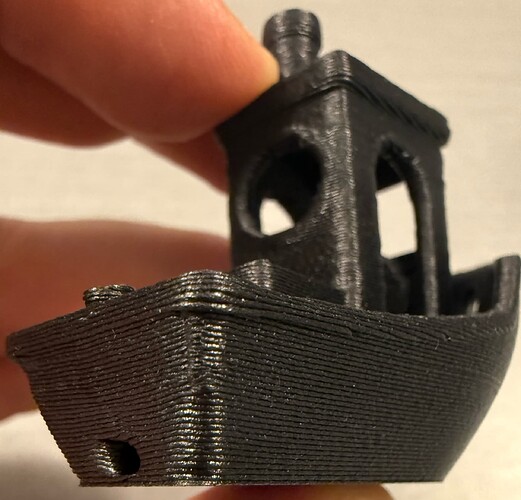

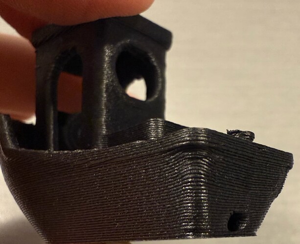

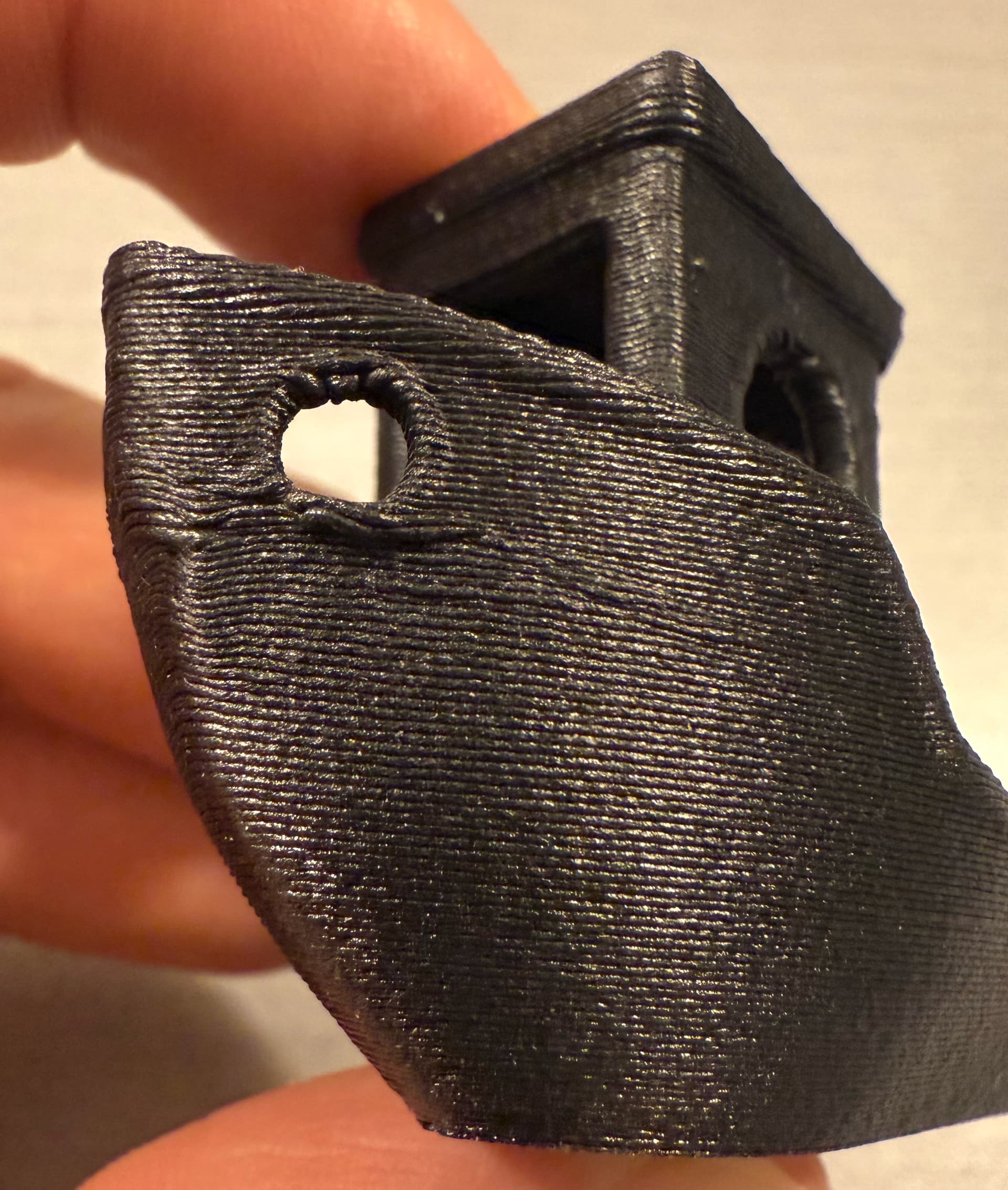

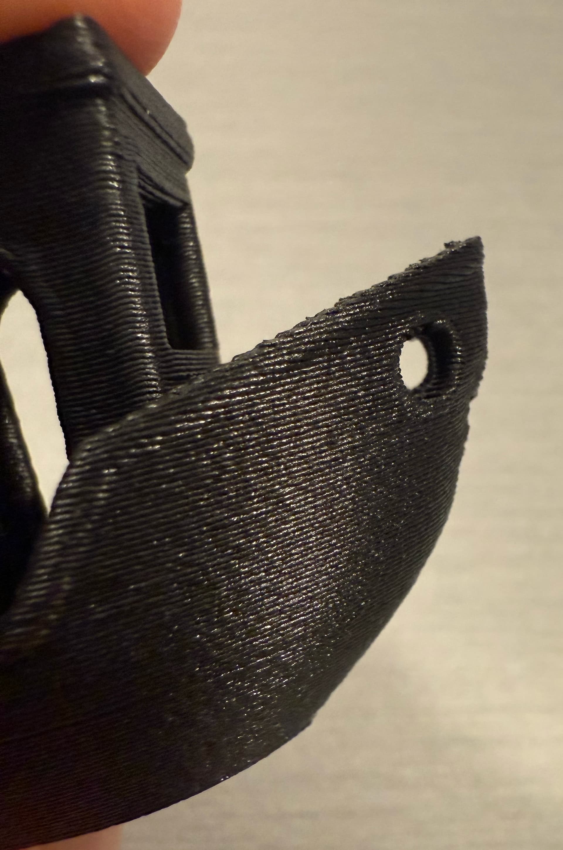

  • 0.24 mm (default): terrible hull results: rough surface, misaligned lines, front hull apex denting inward, and back corners of the Benchy is curling up.
  • 0.30 mm (default): hull lines greatly improved but still getting the same front dent at the apex of the hull and back side of the Benchy corner warping.

I suspect the issue might be chamber or part cooling. The PET-CF may not have enough time to cool down before the last layers of the hull are laid rapidly near the 2 horizontal holes. The caving on the front and lifting at the rear could both relate to uneven cooling.
I’m wondering if anyone has fine-tuned chamber fan parameters on the H2D for PET-CF? The defaults are min 10%, max 30% (now set to min 0%). Should I try allowing a higher max fan threshold, enabling aux fan or increasing the minimum time per layer to improve layer stability ?

  • I’ve attached pictures of my best Benchy so far. You can clearly see the front dent and the misaligned hull lines on the upper section along with the rear side.

Since you’re new to 3D printing, you might not know that PET-CF is HARD to print, but now you know.
PLA is a gift to FDM 3d printing, because it melts easily, and it solidifies easily, low shrinkage, not too wet, and it’s pretty strong most of the time.
Which is not the case for almost all other filaments.
You need to learn about the materials more I think, it’s not your fault, it’s just how this hobby/profession is like. You would soon understand that the machines we have nowadays are almost as perfect as it could be, but the filaments are the real limitation.
