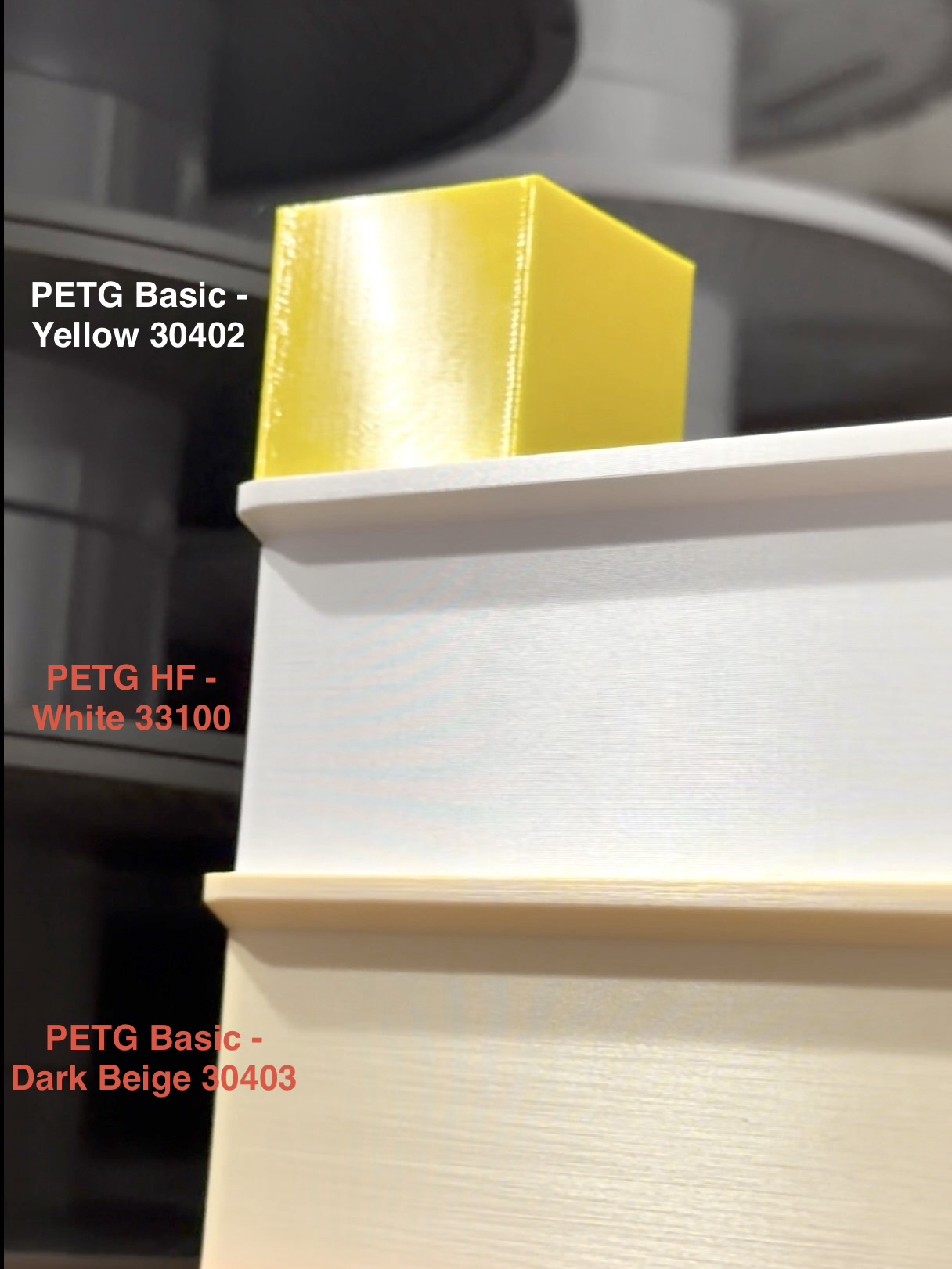

Since the discontinuation of HF I’ve only printed new Basic Grey(30107) and Dark Beige(30403), both offered similar finishes to the old HF - scatter light no matter the angle. Not matte, but nice.
But Basic Yellow(30402) has, across multiple batches, consistently the same oily finish - TPU 95HF level oily, in all kinds of indoor lighting. All samples are sliced the same - full manual calibration vs. all default, same models vs. simple cubes, I’ve tested everything - same night-n-day contrasts. (Grey, not as good as Dark Beige, but nowhere near Yellow bad)
Longer contexts:
Temp: Non-factor. I normally print higher, but default 245C also produced exactly the same differences;
Calibration: Bed, vision, flow rate, pressure advance, shrinkage, blast oven, freshly bone dried, EVERYTHING, and consistent across all test pieces.
Model Geometry: Tested on the same models, tested on Cubes, Boxes, no differences.
“across multiple batches”: Yellow(30402) with batch number ending in D, and now ending in H, no differences.
