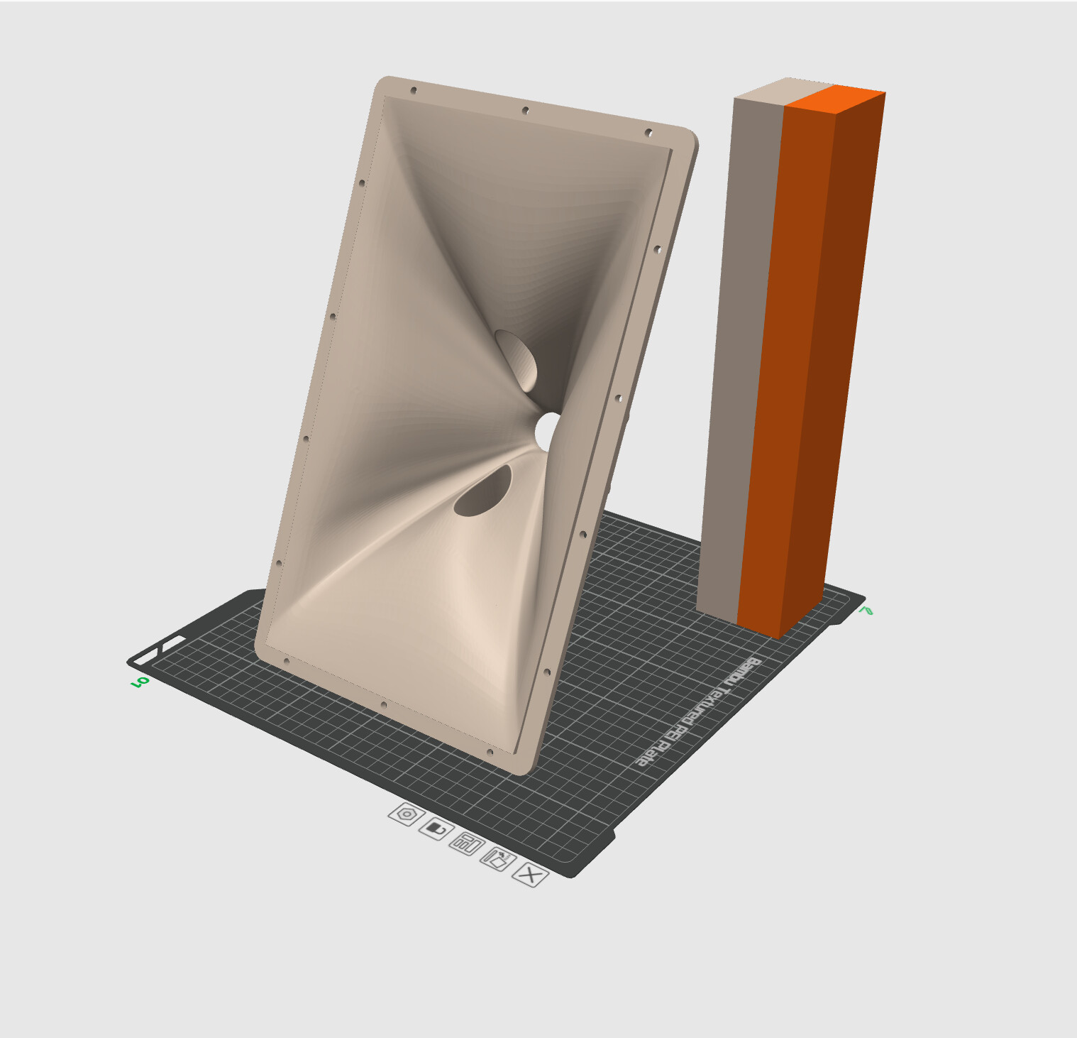

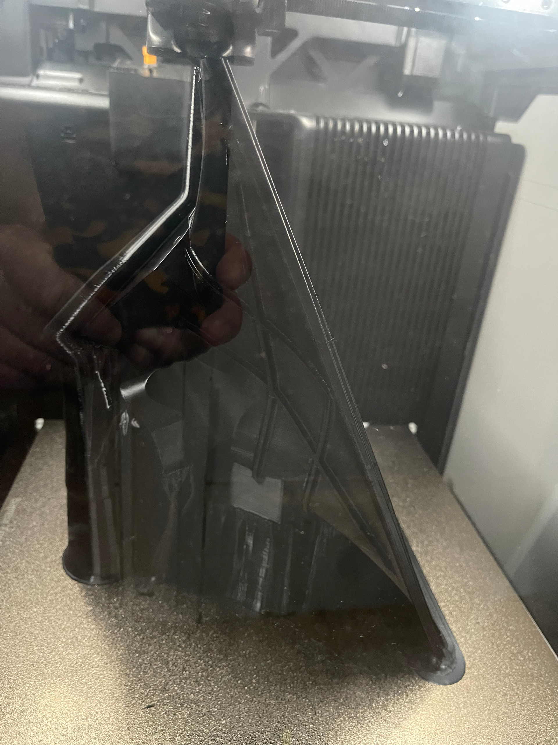

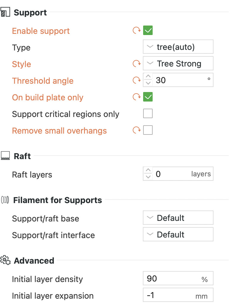

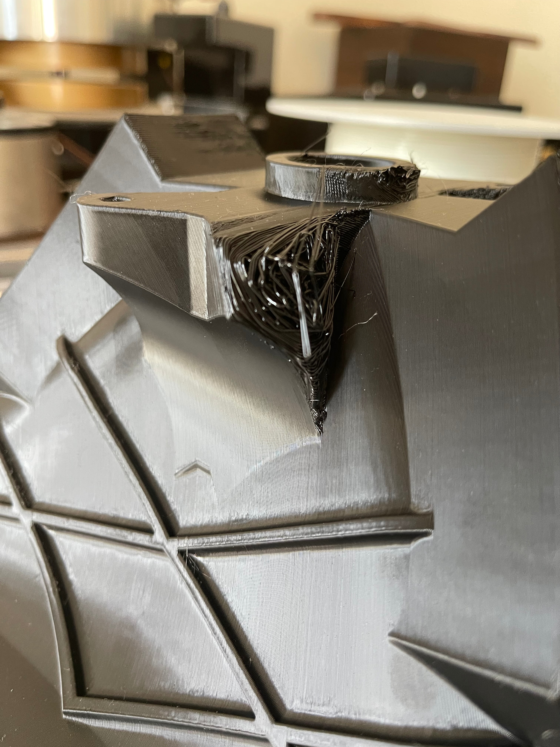

I have only had my H2S for a couple of weeks and only used PLA basic and Petg basic so far but having trouble with poor quality on overhangs. I have tried strong and slim with various advice from AI but results are still not great.
Are there any ways i might try to improve this or is this to be expected?
I have read Petg is not great for tidy overhangs.
Thanks in advance.
Si.

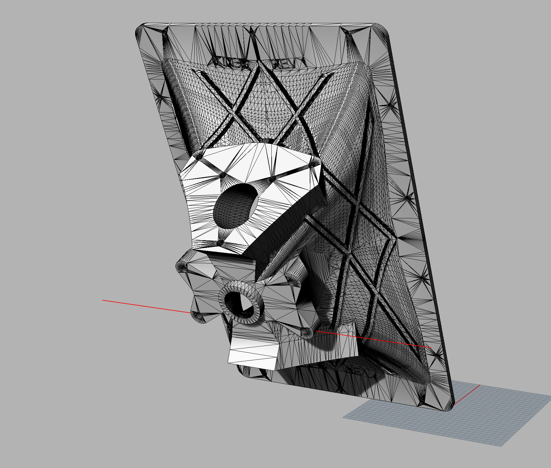

How steep are those overhangs? I have difficulty to relate orientation of the finished part to the picture in the printer. Maybe you can mark some of the features on both pictures?
Ah, maybe I get it now: The big flat area is almost touching the build plate?
Then I would say, this might be as good as it gets without support interfaces in a suitable support material. Maybe you can tilt the part a bit more, so that the big surface is parallel to the build plate? That would probably make it better than this very light slant. If you have an AMS, it would also allow to use PLA as support interface on just 2 layers, so with minimal filament swaps.

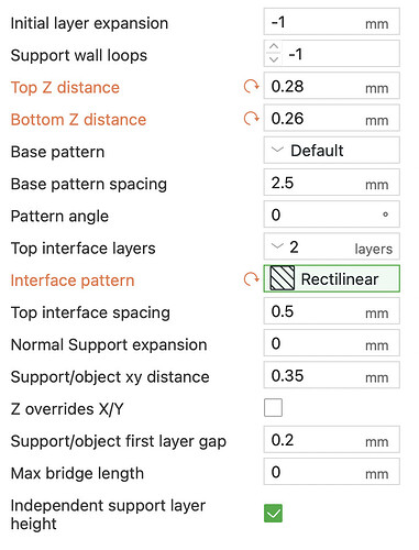

What do your support settings look like currently?

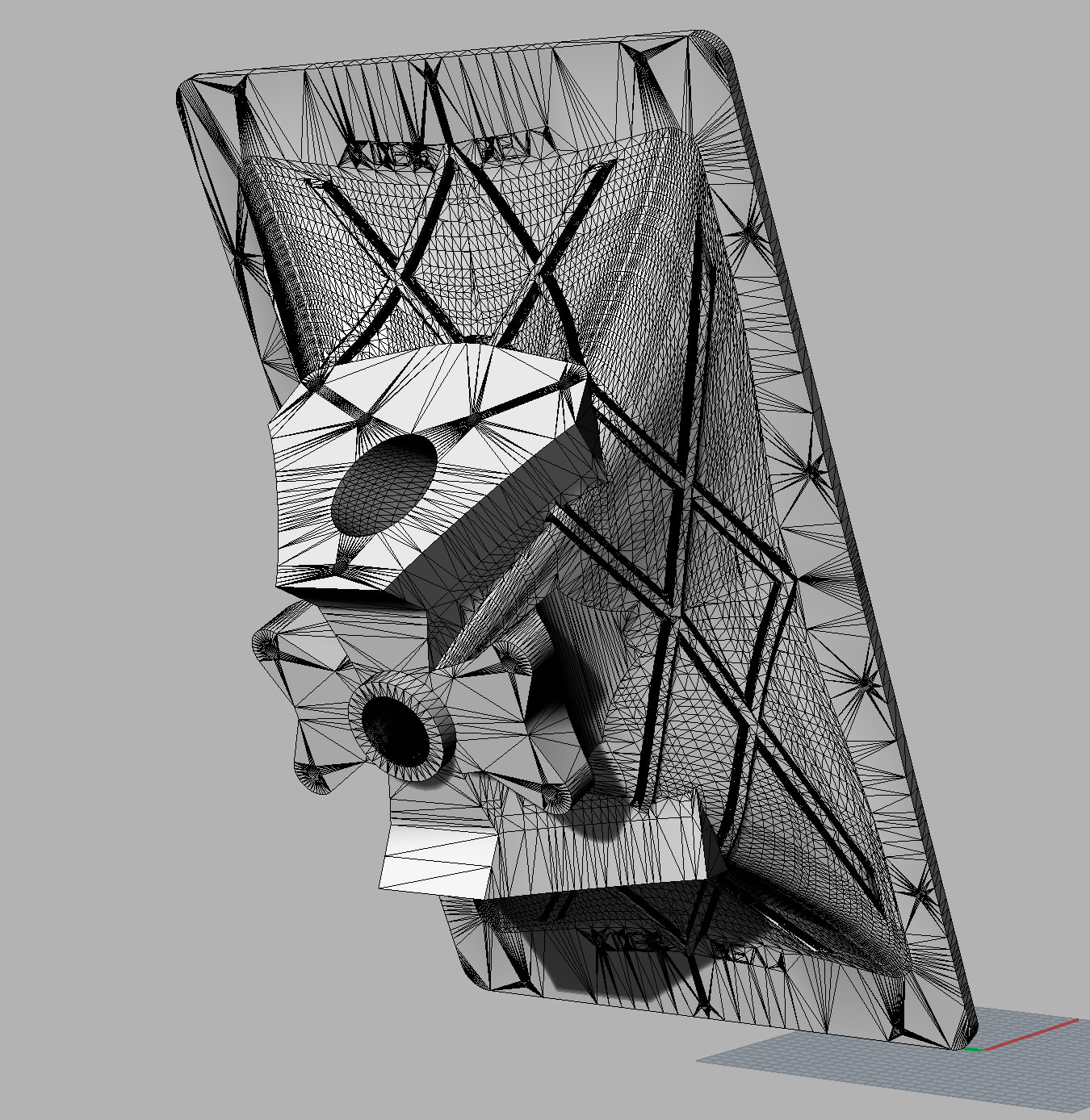

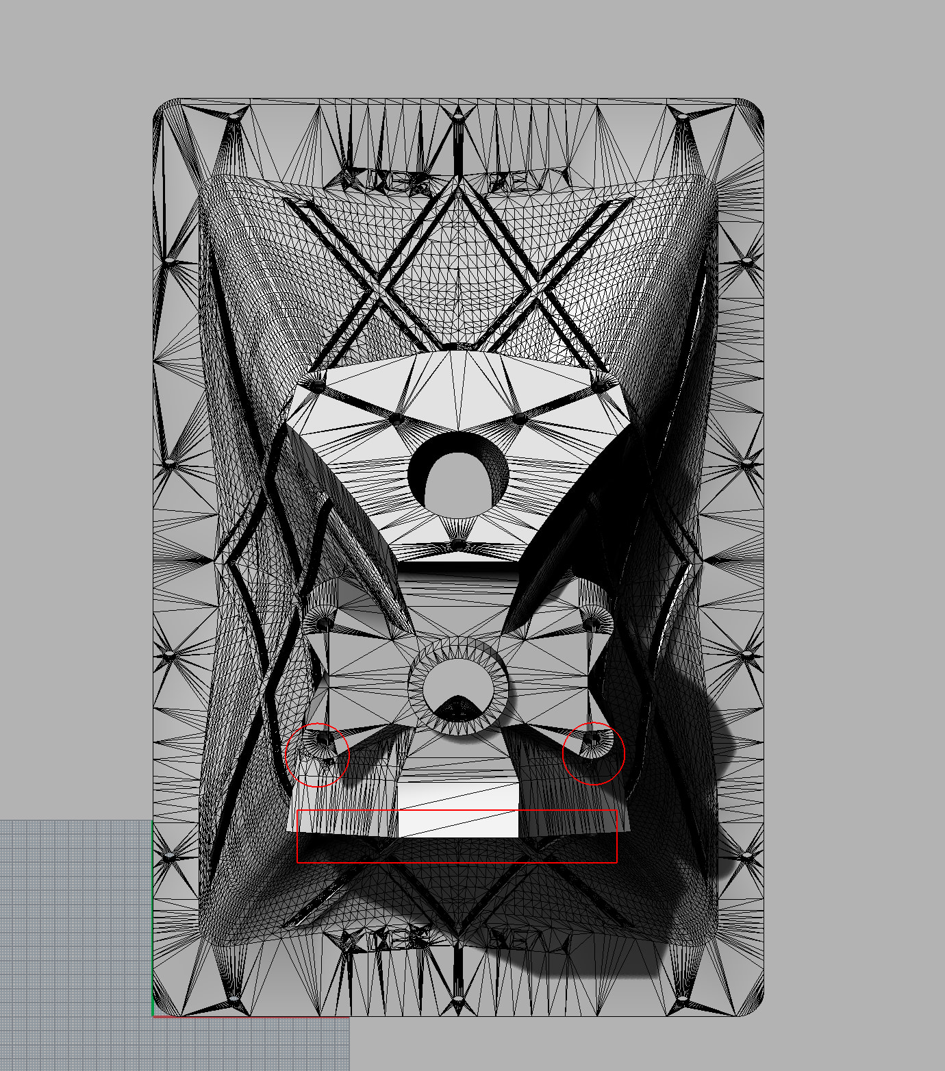

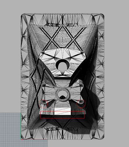

Many thanks for the reply, here are some more pics to show things in a bit more detail and have shown the problem areas in red.
I do have an AMS, some PLA basic and some support for PLA.
perfect, now it is easy to understand.
I think the 30° overhang threshold are asking a lot from PETG. I would increase that to 45° to be save. That should mainly help the two small upper problem areas.
As I wrote above, tilting the part slightly more, so that the big surface is exactly parallel to the build plate, should make it quite a bit nicer. I think in Bambu Studio, you can select your part, then press F and select the surface and BS will align your part accordingly.

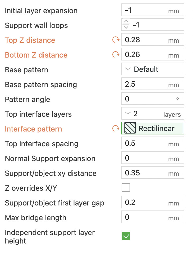

You have those 0.26mm top Z distance. That is quite a lot. I wouldn’t use much more than 0.2mm.
BTW, what is your layer height? More layer height typically also worsens overhang performance.
And then the fundamental question, why that tilt on the edge? Is it to fit the part into the printer? Would it be possible to tilt it to the right instead of to the left? That might completely make supports unnecessary.
Of course it would fall over at some point. To avoid that, I would manually create some rib supports on the right side. Let me find that video again…

If there is good reason to tilt it the way you did, I would really think about PLA for support interfaces. It needs a bit of tweaking, so best experiment a bit on a small sample part. There is also a dedicated article in the BambuLab Wiki, using PLA as support for PETG and vice versa. Most importantly: set the flush volume from PLA back to PETG really high, otherwise, some residual PLA can completely destroy the layer adhesion of your PETG part, so that it breaks easily.

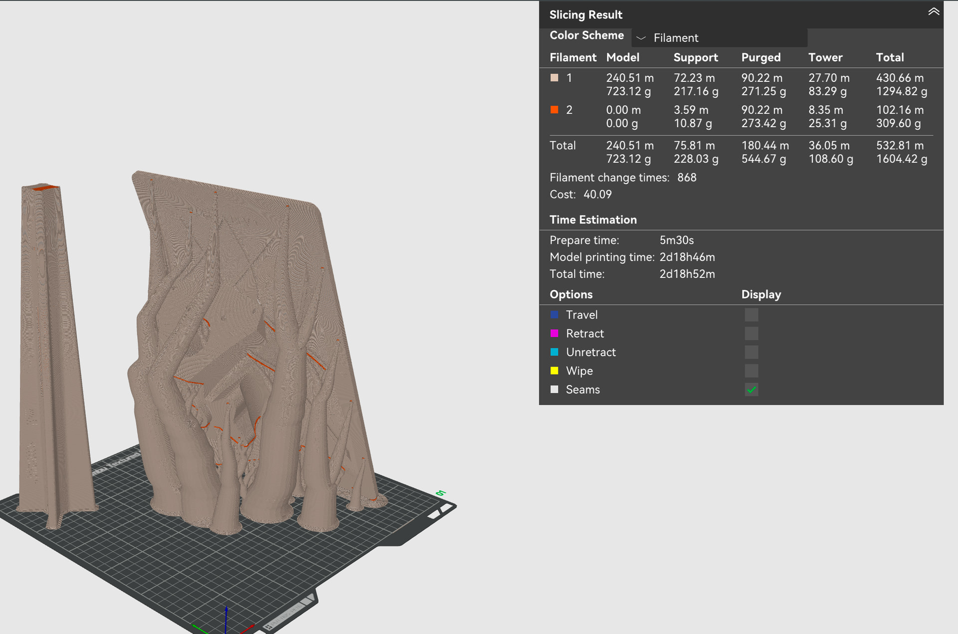

Just implemented a few changes with pla basic as an interface and set z distances to 0 but print time is 2d18h with 868 layer changes.
Its orientated this way to fit as its 361mm wide across the width of the mouth.

I think if those surfaces are hidden inside the cabinet, I would accept a certain roughness and skip the interface material and use regular supports as you did before with the other adjustments I proposed that should already vastly improve the overhangs. You could sand the surfaces where the drivers are attached to get rid of the roughness from the tree supports.
one more idea:

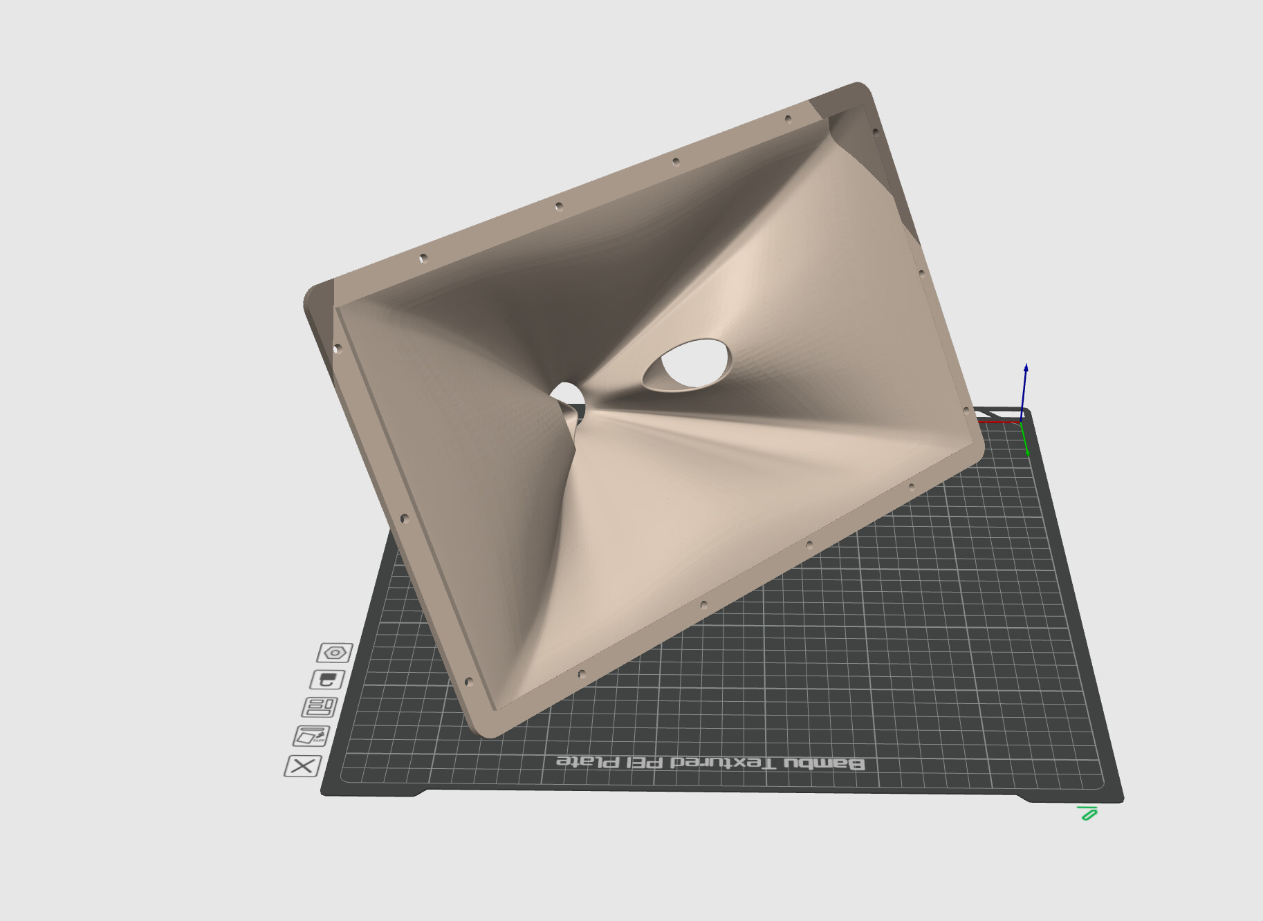

Can you rotate the horn 90 degrees so that it lies on the long edge and place it diagonally on the plate? Then the functional surfaces would be (slightly tilted) side walls, that don’t need support at all.
Like this?…it does fit.
yes! i think like that you only need support for some corners, but all functional surfaces don’t need one.
but i think the top top corners are slightly outside the build volume. Maybe you can move it a tiny bit to the front right.

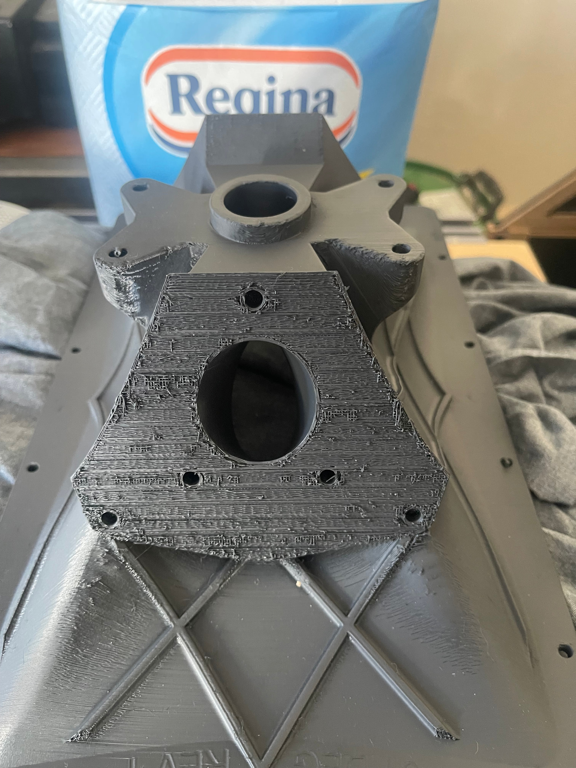

You’ve got more scraping to do. There’s still support material still on the surface. Don’t cut youself with a woodchisel. This area is so large maybe a “card scraper” would work.
If you print again maybe tweak the Z gap settings a little.
Looks like the upper corners are not fitting?
