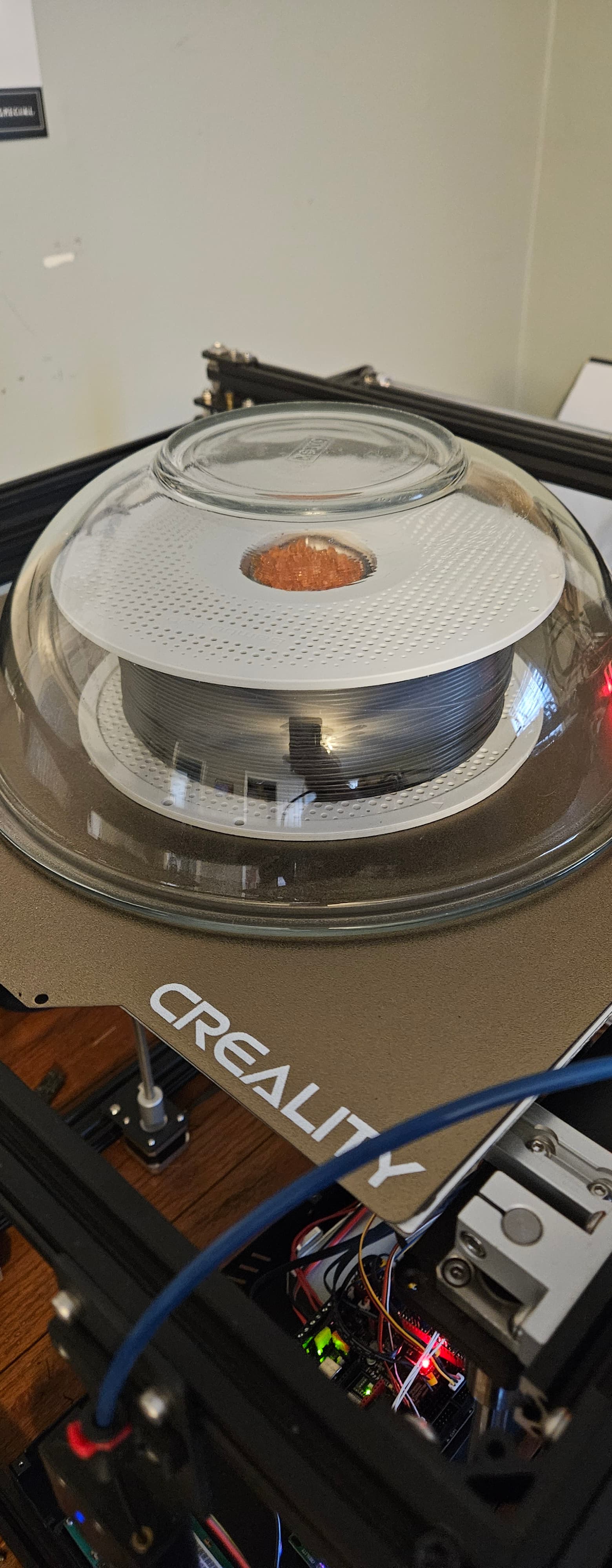

I unloaded it from the AMS and made a macro for my ender to hold 70C for 4 hours and loaded up some desicant and will see if there is any change.
You may want to double the time as well as enabling moist air to escape during drying (my dessiccant will also dry at 70°C, so it’ll not do anything for the air humidity until it cools): Filament Drying Recommendations | Bambu Lab Wiki
While the bowl seems like a good idea, it doesn’t allow any of the moisture out which defeats the purpose of drying.
Even with a good amount of desicant loaded up in the bowl as well? The humidity in the room is about 40%. I put my hydrometer underneath the bowl and its down to about 25% at 110F
25% humidity at 110f is a LOT of moisture in the air.

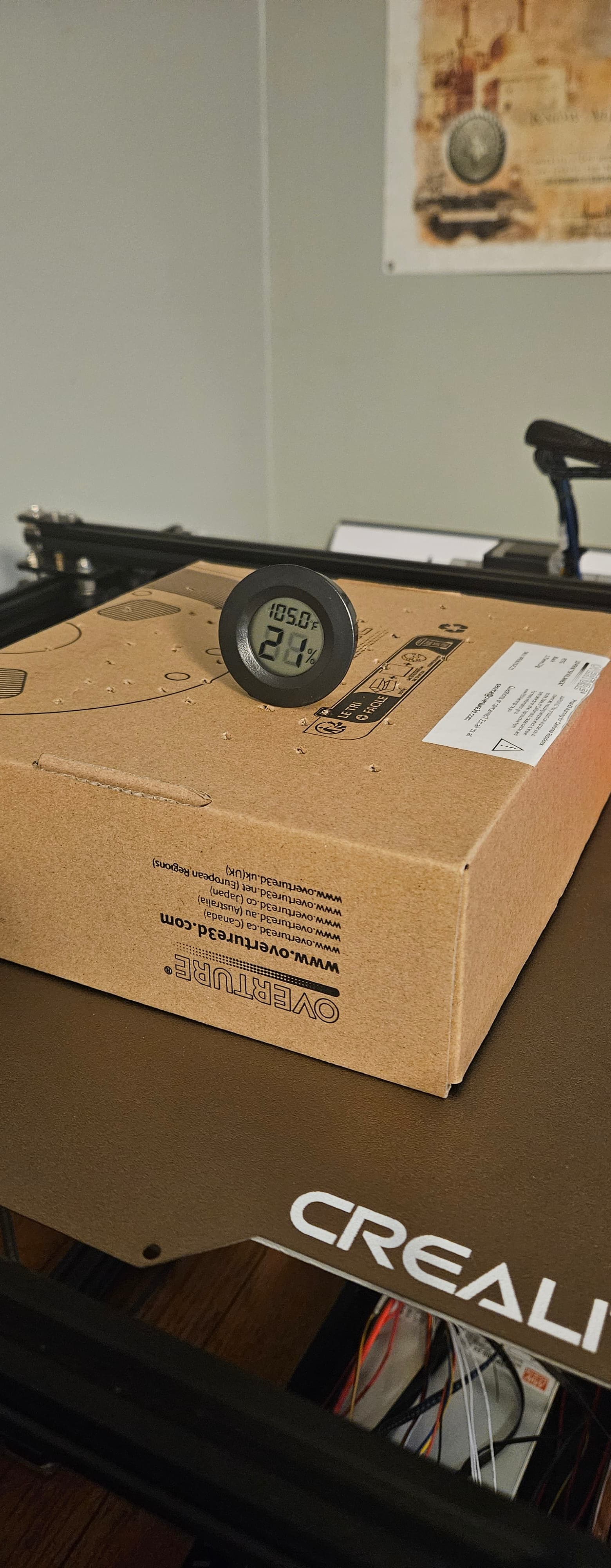

Yes, you need air flow. You can take a box like what Bambu filament comes in, cut the top off, then poke a few holes in the bottom of it with a pen or the Alan key that came with your printer and then place it holes up over your filament.
I dry PETG like this at 65c for 6 hours and then flip it over for 6 more when using a printer bed to dry. I tried to attach a picture but makerworld is complaining about the megapixels and I don’t know how to adjust that down to get it to post.

I’m not sure if the desiccant in the middle will do anything as far as drying the filament is concerned, but if it doesn’t help in that regard it should at least be recharged by the time the filament is dry.
And that’s exactly what I had in mind. That’s my preferred way to dry filament and it actually works better than most out of the box filament driers.
I truly hope that this helps with the issues you are seeing.
I have the gen 1 sunlu heated spool holder and it has no air flow so it just gets hot and holds the spool. Ill report back once its sat overnight.
That’s the exact problem with many filament dryers. They don’t allow any or enough airflow.
There are videos and write ups that explain why that’s important that do a better job than I could so I won’t bother. The short version is that your print bed with a box over it will work significantly better than a filament dryer with no airflow.
For desiccants like silica gel, you heat them to regenerate them. Their water capacity goes down as you heat them. If you heat desiccant with your filament in essentially a closed container, the desiccant needs to very, very dry because the heat compromises its ability to absorb other moisture. It can work but it needs to be fresh.
You don’t want to do that. Desiccant packed with the filament will be carrying a water load just like the filament. Actual amount of water will be different but they will have equilibrated together in the bag.
If you want to put desiccant in there to soak up liberated water, it needs to be fresh or at least at a lower equivalent water content than the filament.
