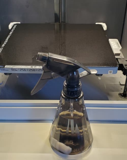

I have your issue too but with textured PEI. PETG-CF gets badly stuck to the bed.
@8orgman I think as plates get old they can go both ways, either too good or not enough. Treating them as such you can extend their life but its usually a sign to replace. Note, this is when all other possible causes have been treated.
Similar to your case, I’ve used a very light coat (very) of hairspray on PEI beforehand to help release models and it seems to work better.
in my case the PEI is quite new. I have it for less than a month, only used it for few prints. thanks for your suggestion about harispray.
here is a photo of the disaster :smiley:
