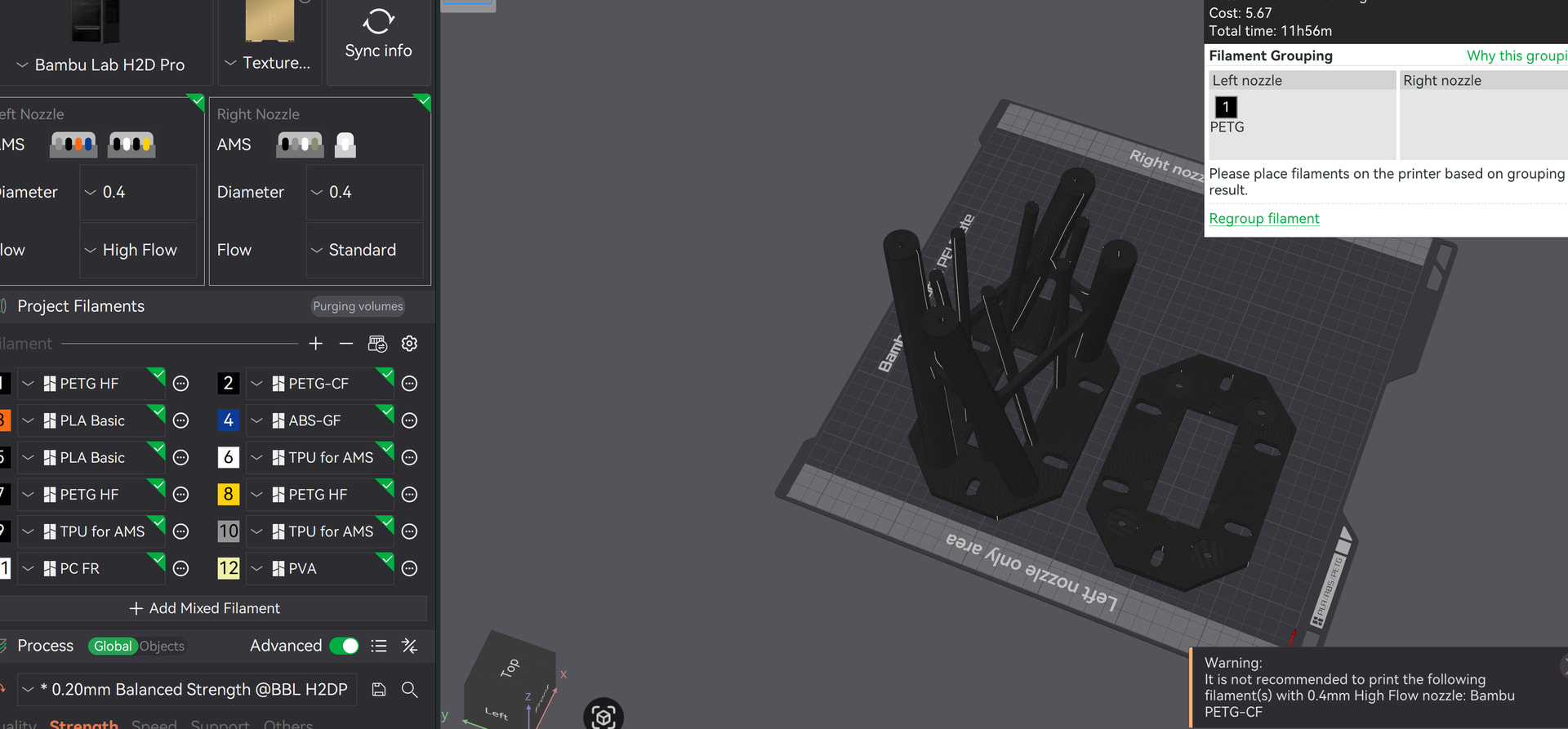

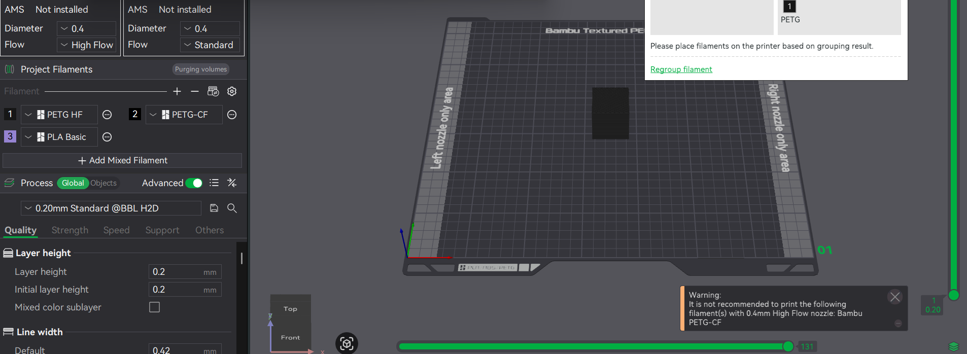

Setup: H2D pro, PETG HF in left AMS, 0.4mm HF nozzle (left)

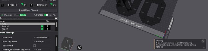

Slicer warns PETG CF is not suitable for use with the 0.4 HF nozzle, the print time is not reduced from the Standard when changing to the High Flow nozzle (11.45 hours for both).
I believe this may be a bug because the error message is for PETG CF, if not the error message may need to be updated.
Due to the addition of carbon fiber, PETG-CF requires a more wear-resistant hardened steel nozzle. While a 0.4 mm hardened steel nozzle can be used, a 0.6 mm hardened steel nozzle is recommended to further reduce the risk of clogging.

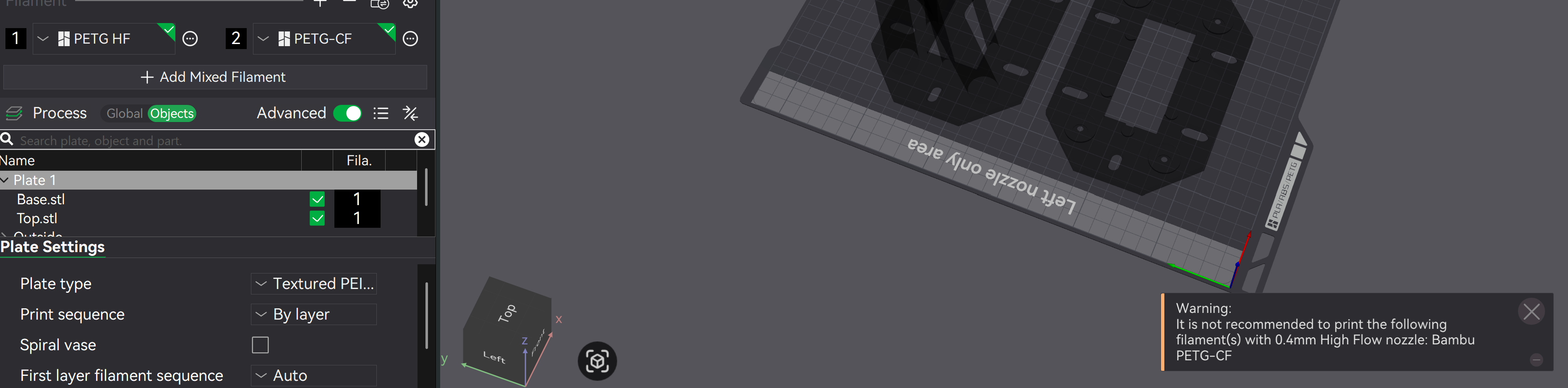

Slot 1 is correctly assigned and PETG HF is being used during print. When the PETG CF is removed from the list the message dissapears and re-appears when added back in. Print time does not alter?

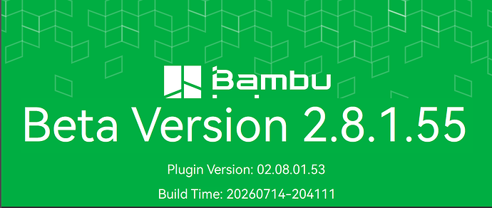

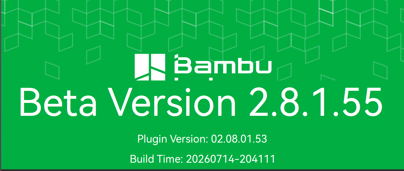

That’s interesting. Seems like a bug then. Have you checked if the same happens on the non beta version of bambu studio?

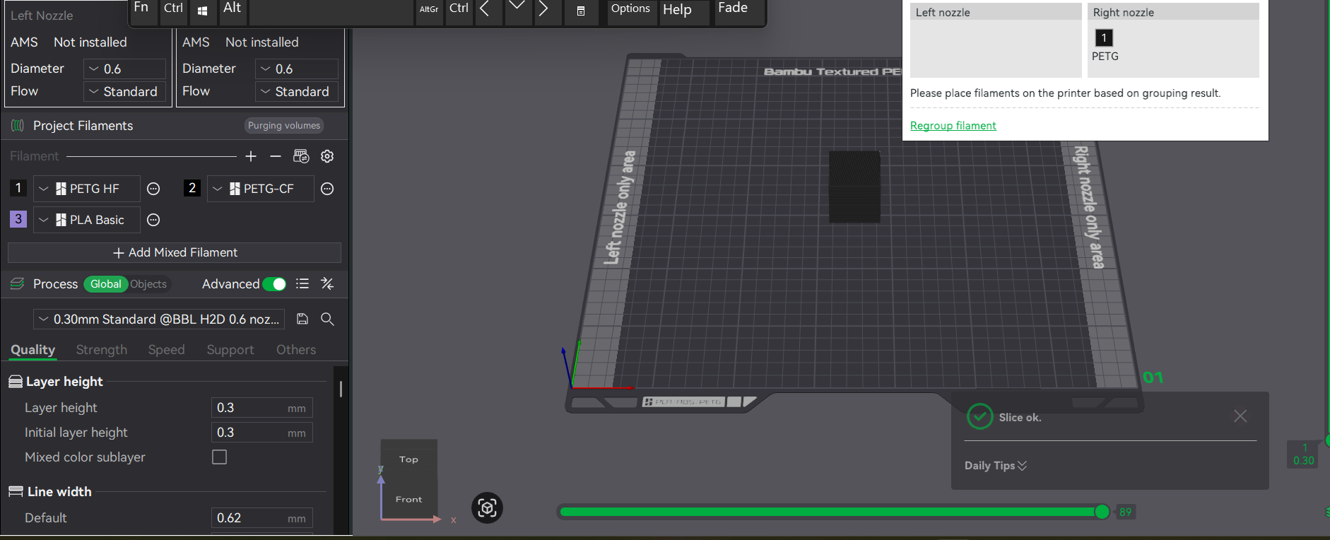

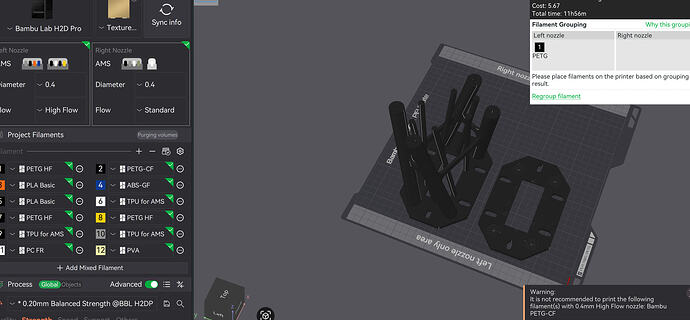

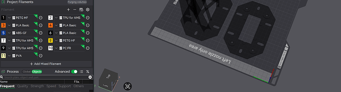

Can you see the same issue ? its listed and also not used , the printer has selected the hf to print with. Changing the nozzle size removes the warning
