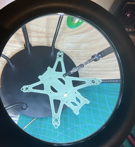

Here’s my frame, this is the bottom of it. I used a smooth plate but definitely should’ve used my textured pei. I put brim but there’s a few blemishes on the first layer, nothing serious, purely aesthetic.
Thank you!

OK. Thanks for posting such clear pics, it really helps take a lot of the guesswork.

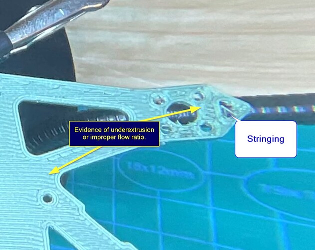

I’m guessing that this is the top down of the model and you may have opted for zero top layers.
Your model is small and I’m guessing that this is no more than 1-2mm in height so that may present other challenges due to the sparse nature of the filament.
I might suggest performing a manual calibration of your filament. There is a lot of room for improvement based on what I see in these photos. I would focus on these three areas.
  1. Temperature - I would use a properly Calibrated Temp Tower(Orca Slicer)
  2. Flow rate - I would do this after verifying the correct temps. Your flow rate is way off in this example.
  3. Pressure advance - Again I would use the Orca Slicer PA Tower utility as it will give you the greatest accuracy. It will help a lot with stringing.

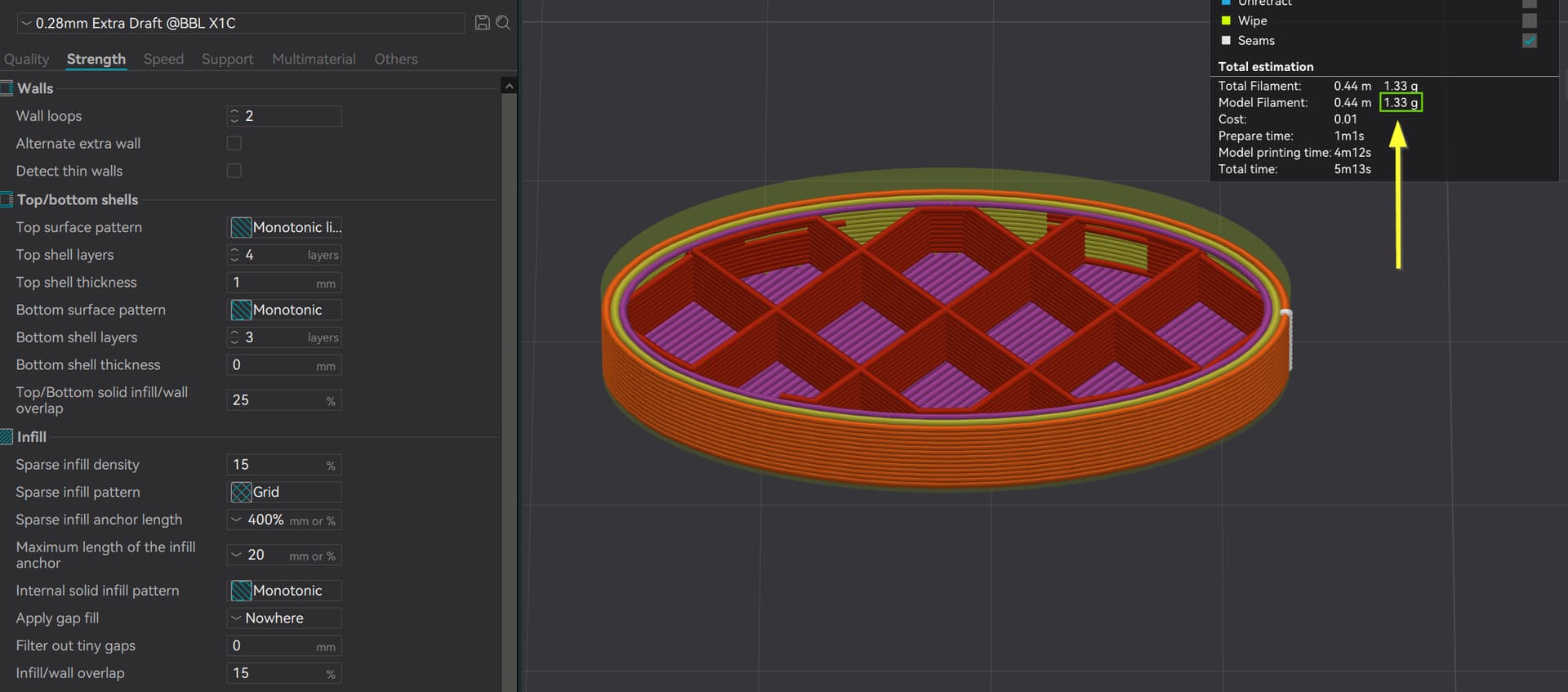

You may want to experiment with using a thicker print and increasing the wall loops while decreasing the infill. While a thicker model may seem counter intuitive, here’s how that works.
Using a 30x15x5mm Circle primitive ellipse with default settings.
You save 12% weight by using these settings. Note the Amber changes.
By increasing the height of the model and increasing the walls, we make a far sturdier structure who’s strength:weight ratio is greater. Try creating a few cube primitive blocks and experiment with bend strength vs height and wall loops and you will find that you will quickly zero-in on the sweet spot of what will work for your project.

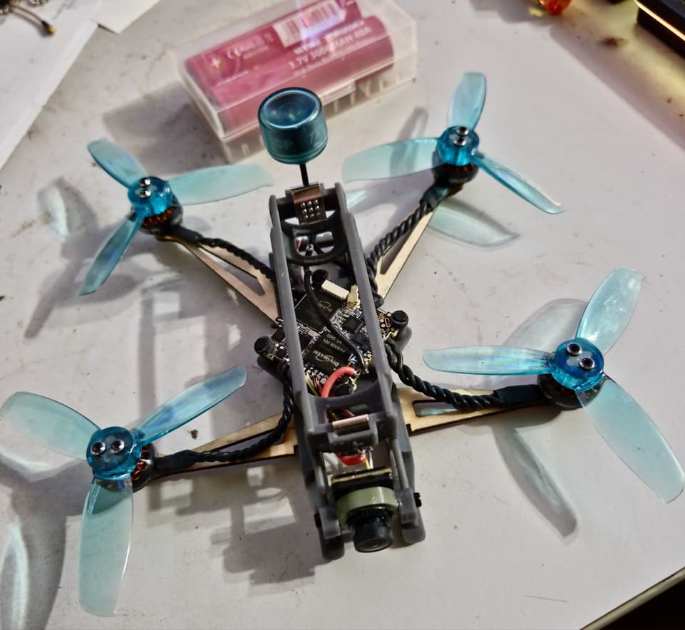

Quadcopter frame, printed in PLA. For something like this, strength is actually more important than weight. PLA is not a good choice. Breaks too easily. I actually prefer Nylon. You want plastic that can flex in a crash. But for quick tests of the design, printing in PLA is fine (and less expensive).
This was designed to see how long I could fly on a single battery. I get 25 minutes on a 18650 Lithium battery cell.

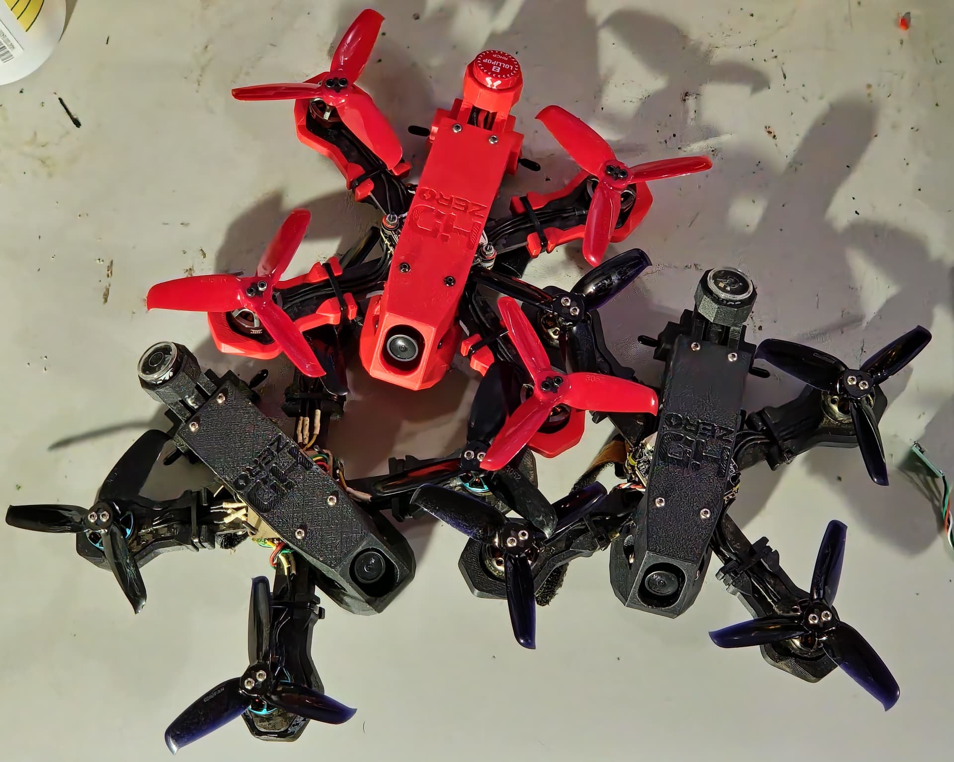

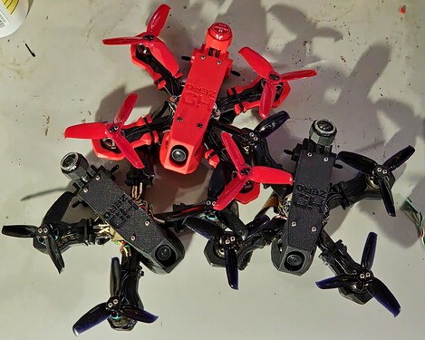

Yeah. Someone came up with the idea and posted about it in the RCGROUPS forum a few years ago, where I saw it and decided to make my own. I’ve gone through a number of iterations using both FDM and SLA printing, and even one with SLA printed “fuselage” and laser cut thin plywood motor arms.
A couple of companies came out with a production version. But the design is so simple, I don’t think they sold very well, easy enough to spit one out with a FDM printer.
This one is SLA, with the battery holder integrated in to the print, and laser cut ply motor arms.
I print tons of stuff related to my Radio Control hobby… some examples:
“Ride Along” monitor for people to use to see my video during a race.

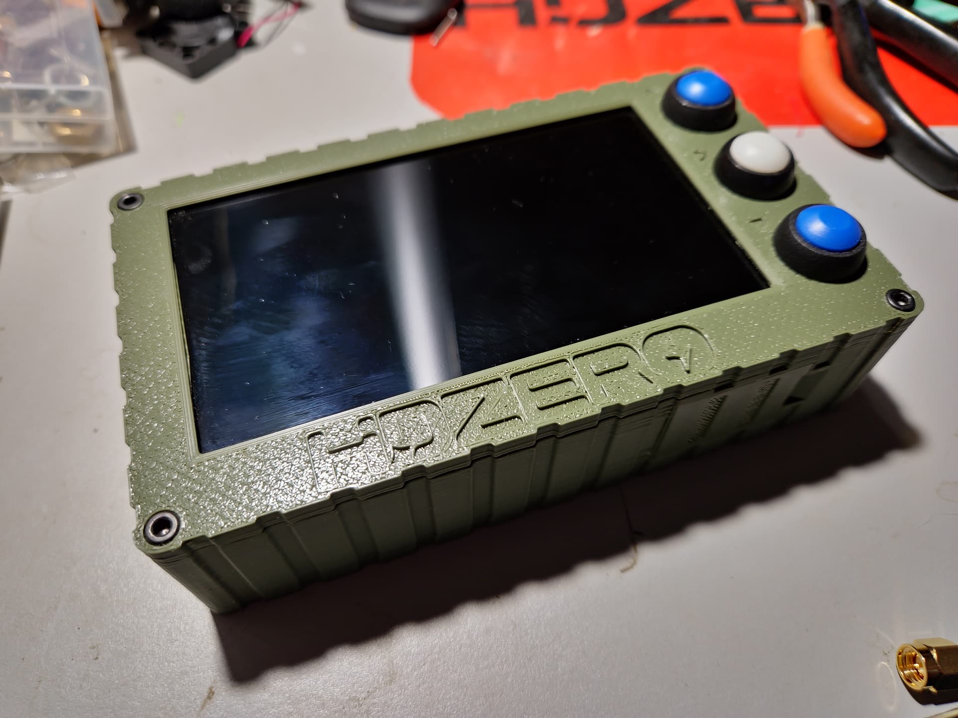

Literally, the first thing of my own design that I printed with my X1C/AMS, this goggle case.

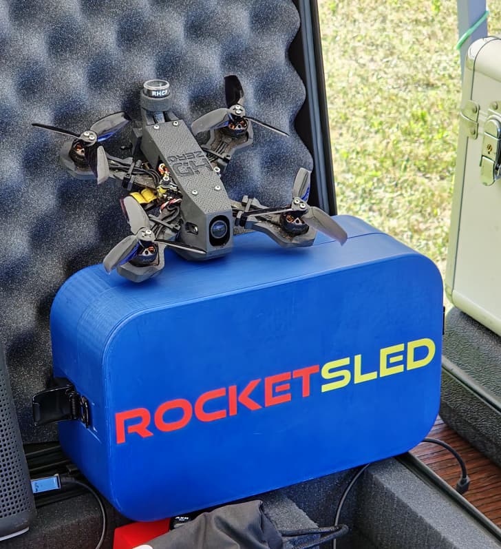

The little quadcopter is for racing. The canopy (the part that says HD Zero) and the antenna holder at the back, and the bumpers on the motor arms are all 3D printed (Nylon).
Racing is tough on these things. Crash in to something when you’re flying at 60-70MPH, not a lot that can survive the impact forces. Gotta have spares if you’re hoping to spend the entire day at the track. We race outdoors in a big field.
