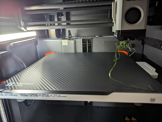

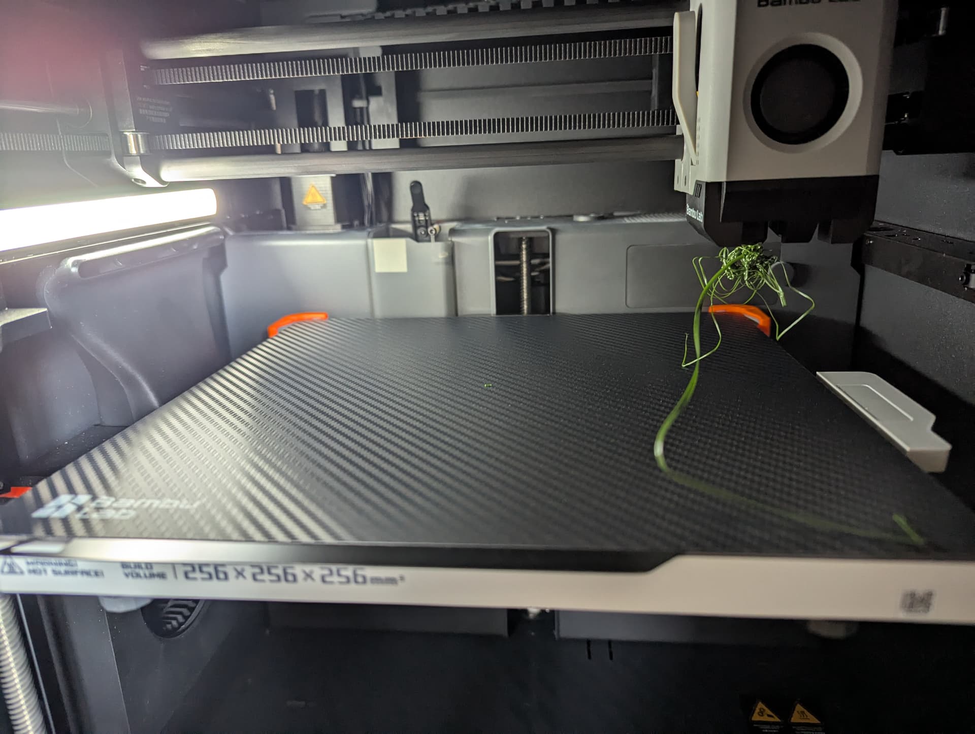

Tried all types of plates, bed temp up to 75.
This, on photo - just opened carbon sticker, first print on it.
Does anyone has solution to this problem?
