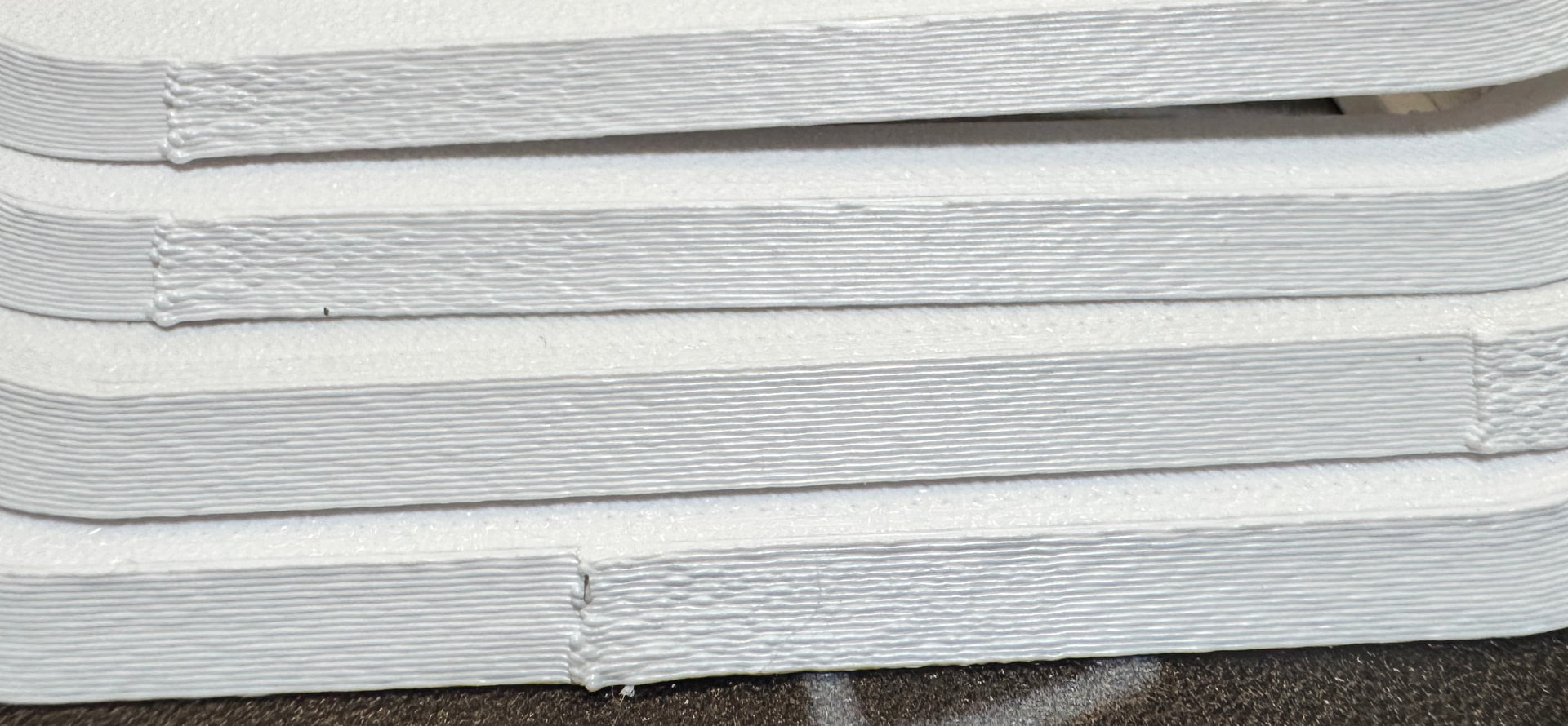

On an X2D with the 0.4 High Flow hotend, printing Bambu PETG HF, I have a seam/witness line on a 45° overhang that will not go away. The key clue: fuzzy skin completely removes the seam on vertical walls, but on the 45° overhang the same line is still clearly visible. The defect is unchanged by print speed, line width, and scarf settings. Looking for people who have actually solved PETG HF seams on sloped surfaces on this machine — not generic “slow down” advice, which I’ve already tested.

  • Vertical walls: fuzzy skin removes the seam entirely. Clean.
  • 45° overhang: the seam/line is still clearly visible, even with fuzzy skin on.
That difference is the whole reason I’m posting. Whatever the defect is, it behaves differently on sloped surface than on vertical surface, and fuzzy skin’s surface noise is not enough to mask it on the slope.

Pics of prints might be of use here, also slicer previews showing the same region

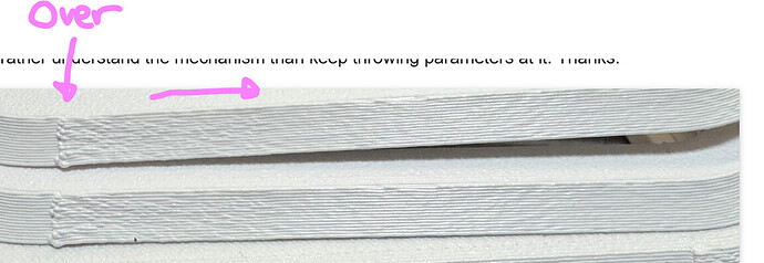

To my eye this looks like [pressure advance/flow dynamics/k factor/same-thing-diff-names] and/or filament dryness
It starts the extrusion line very overextruding, but then quickly evens itself out, which is kinda what happens with not-perfect pressure advance after a travel, and/or what happens with wet filament during any travel.
Any chance you can paint the seam on a non overhung part of the model? Or change to a more overhang friendly “inner/outer” wall order? inner/outer/inner writes the final two lines like this - outer wall printed with a gap [air to left and right] and then the final inner wall is placed:

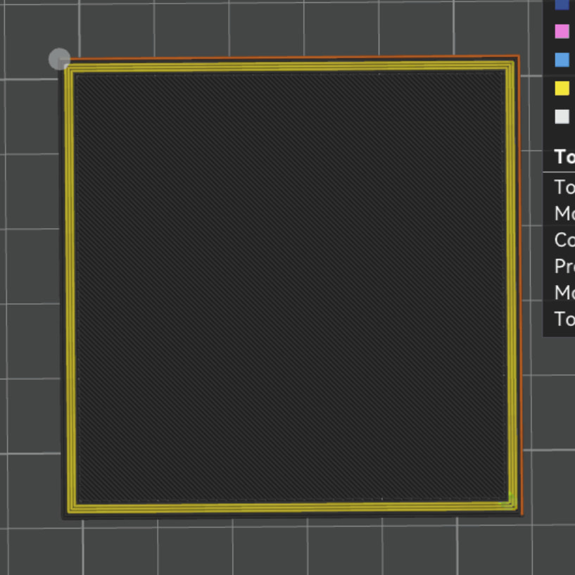

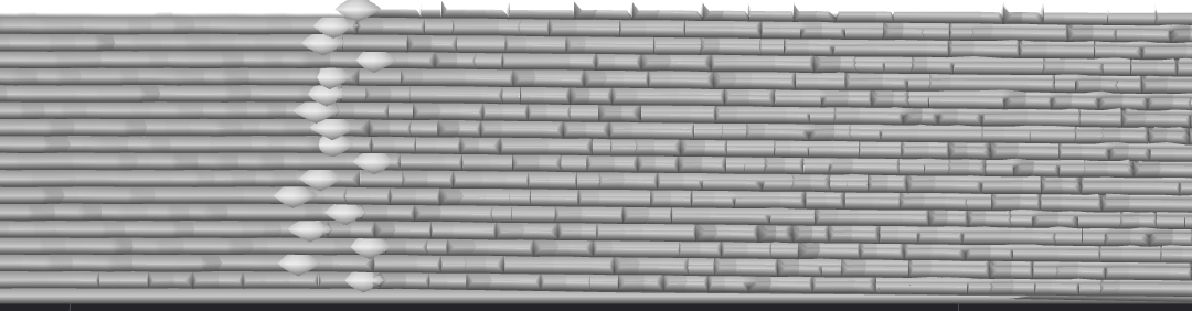

Do you have a top down slicer preview showing the start points of the fuzzy outer wall?
I have a feeling that overlaying an overhang with a fuzzy skin will locally increase the overhang angle. While not usually an issue due to the short wavelength of a fuzzy skin - leading to additional support from the area the nozzle has already traveled over - this is not true for the outer wall start point. If the local overhang at the start would be pushed beyond supportless limits by a fuzzy skin wave peak, it’d be a mess…

@Bullocks and @EnoTheThracian were right about the mechanism: over-extrusion at the wall start point after a travel, consistent with pressure advance. Calibrating PA manually helped a lot:
  • Manual flow-dynamics ¶ calibration with the pattern method, value 0.03 for PETG HF, saved to the filament profile (and auto-cal disabled on print so it doesn’t get overwritten).
  • This took the defect from obvious to marginal — but not to zero.
The residual would not go away no matter what. So I isolated the one variable I hadn’t: the material.
