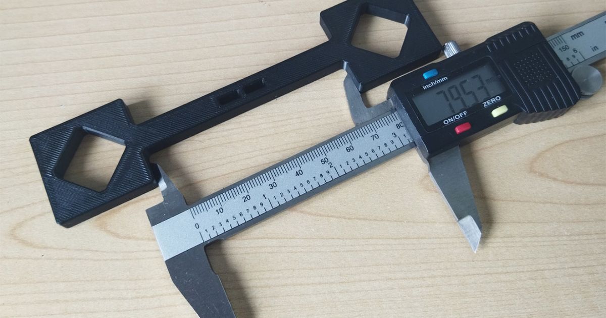

Hey Alex,
actually, I did this when I first started with 3D printing. Obviously, I was lacking the knowledge.
I was using this to calibrate my materials:
But, I will check out the cauliflower from Stefans video. I already saw that video a while ago.
I hope it is ok to advertise my calibration model here :wink: I think it is superior: ShrinkingTest V4 by Alex_vG by Alex_vG - MakerWorld
