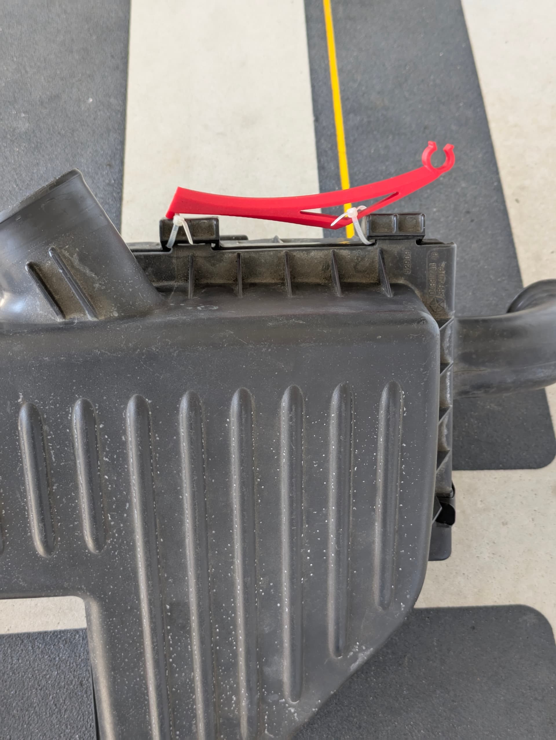

I have a part for under the hood in Florida.
I printed it in PETG, but I had to do a slight re-design. I was printing in ASA that day so I just did it in ASA.
I have the PETG part sitting on the center console. I plan on leaving it there for a few weeks, then I’m going to ziptie it somewhere under the hood.

It’s been a little over a month & the model has no sign of any issues inside the car.
Today I zip tied it to the back of the air filter box.
Had to work on the car today, so I took a few more pics.
The Red PETG print is still doing alright, no signs of stress or weakness.
The Black ASA is alright also, I expected it to be fine.

It’s white, but it’s Florida & not in a garage…so it get damn hot.

It’s been almost a year & it’s still looks fine.
I’m kind of surprised myself.
Everything I’ve printed for the car so far has been ASA.
But in the future, I might give PETG a shot.
With that said, I did have some PETG warp outside this year, but that was in direct sunlight & was 3 sided.
