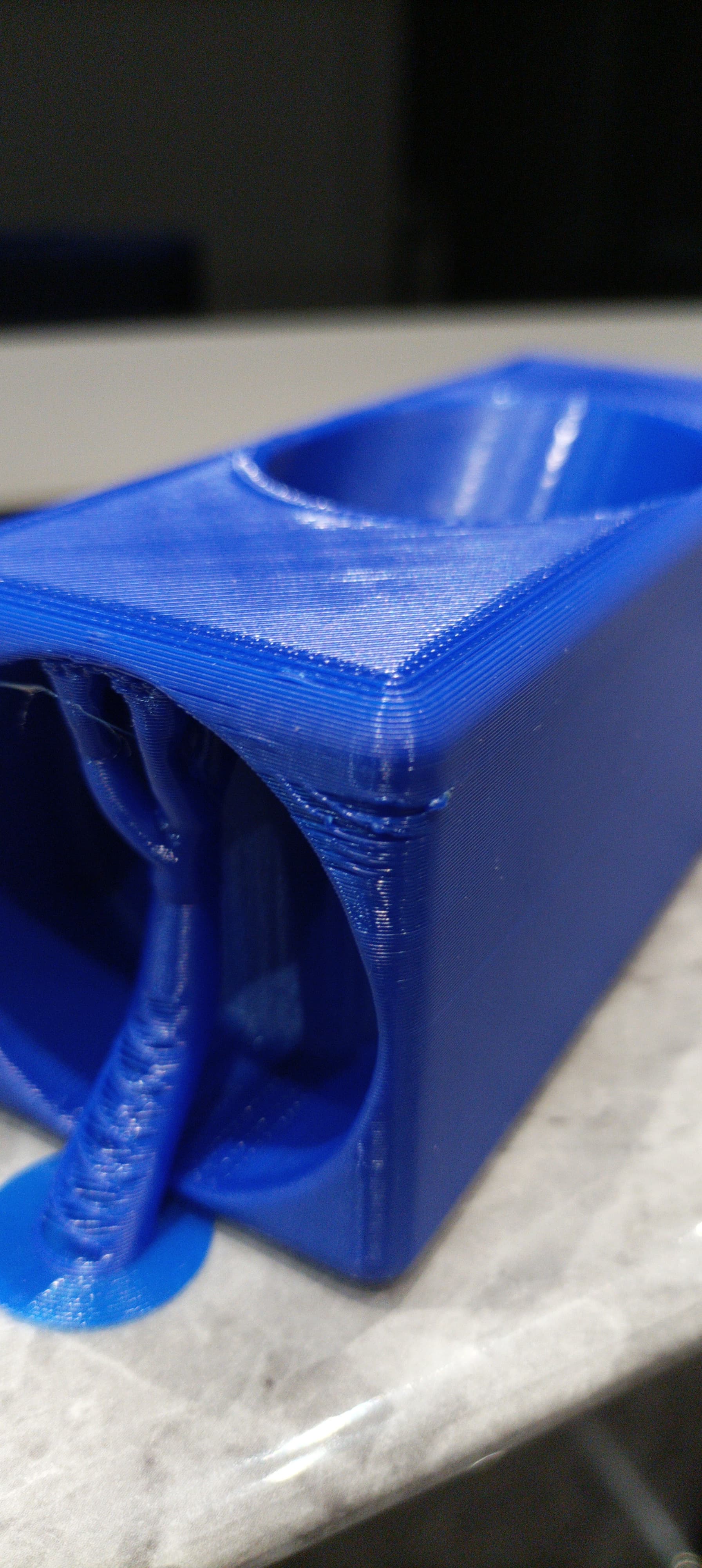

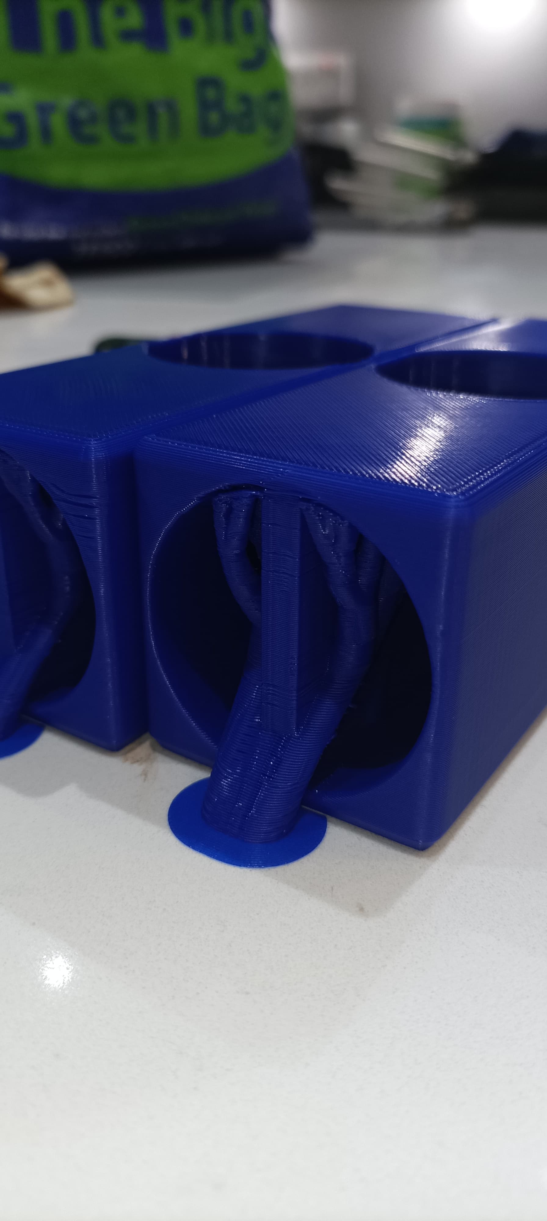

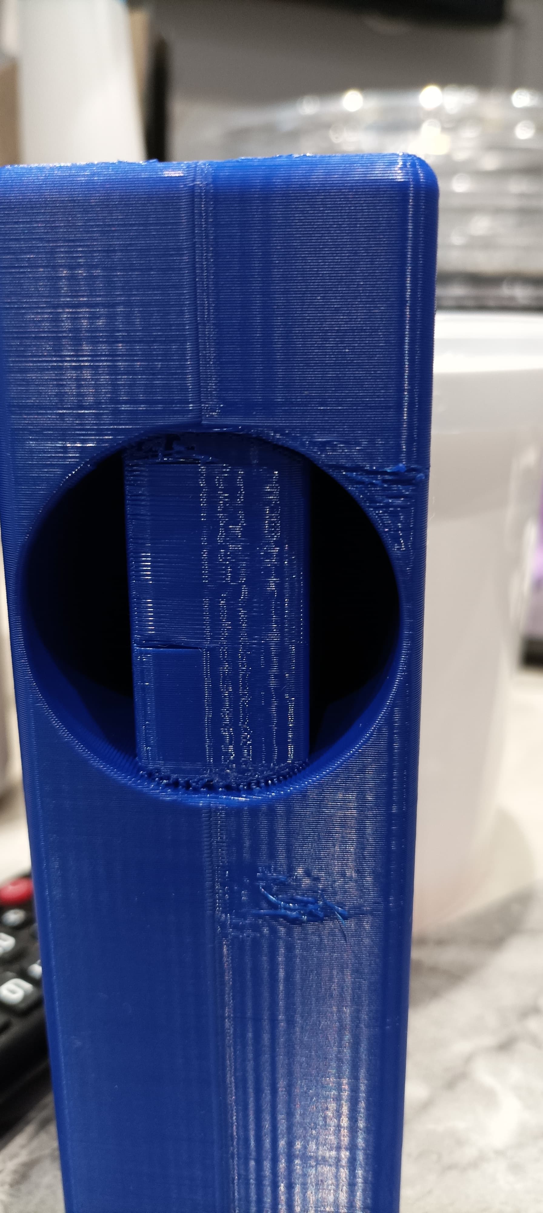

I’ve been using my x1 Carbon for almost a month now. Loving the quality (on the whole, but I’ll come to that) and the useability of it. I have done multiple PLA prints, using mostly the stock profiles and the speed and quality are excellent.

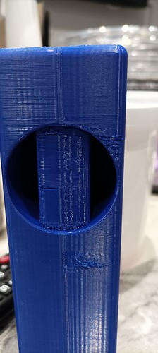

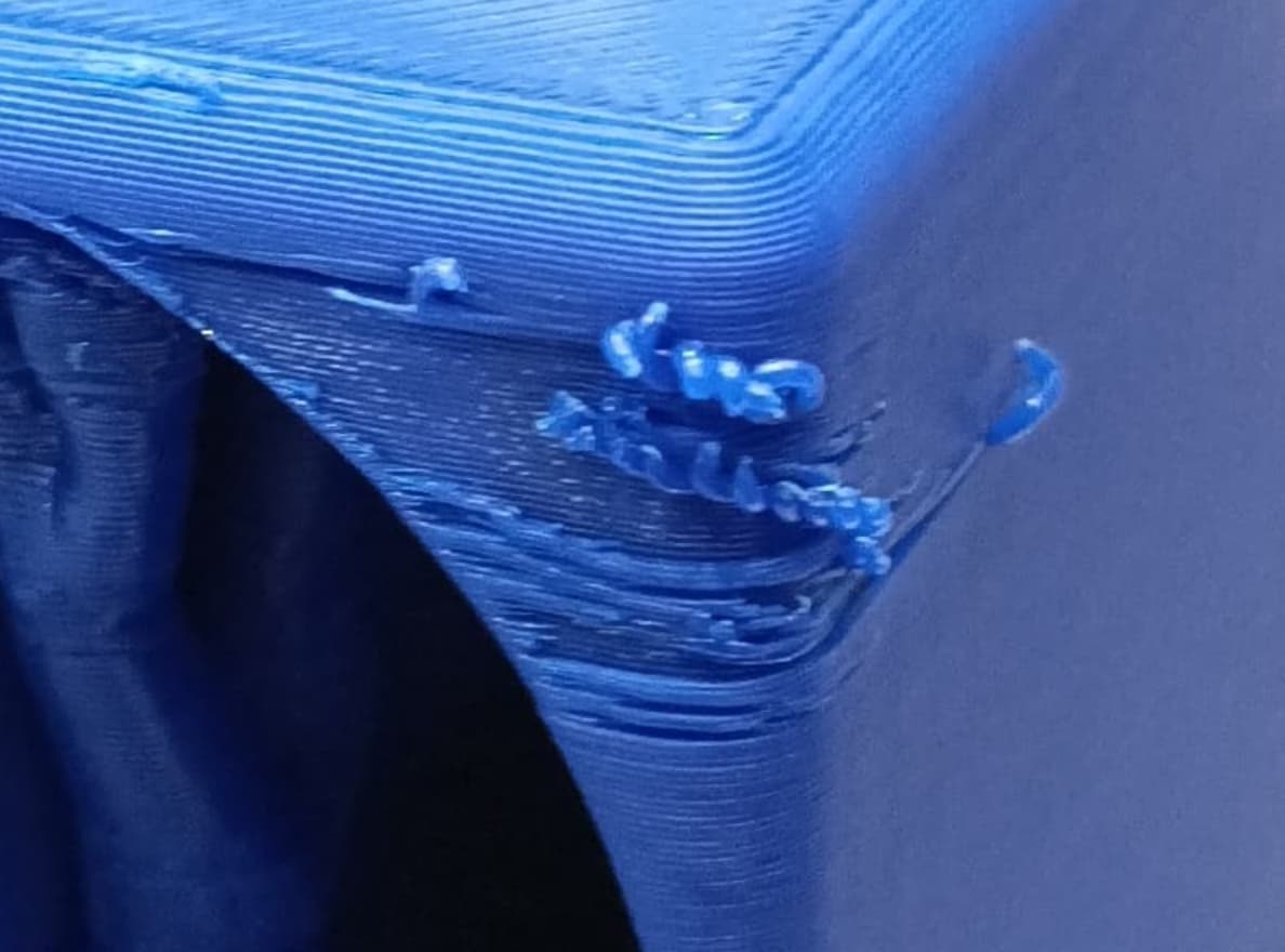

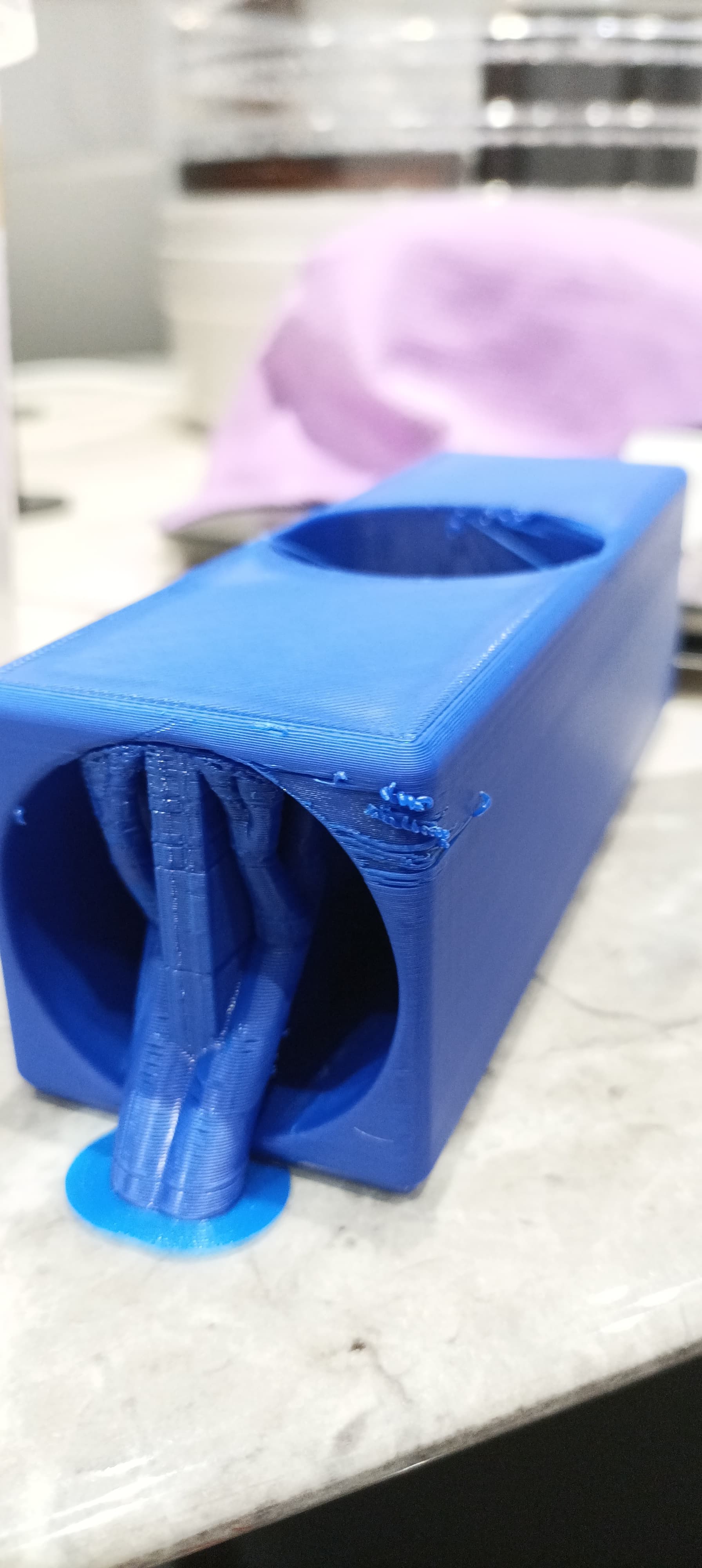

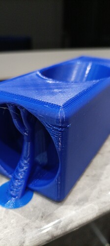

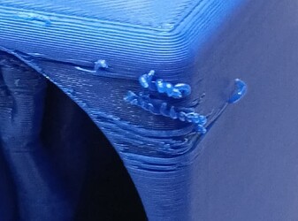

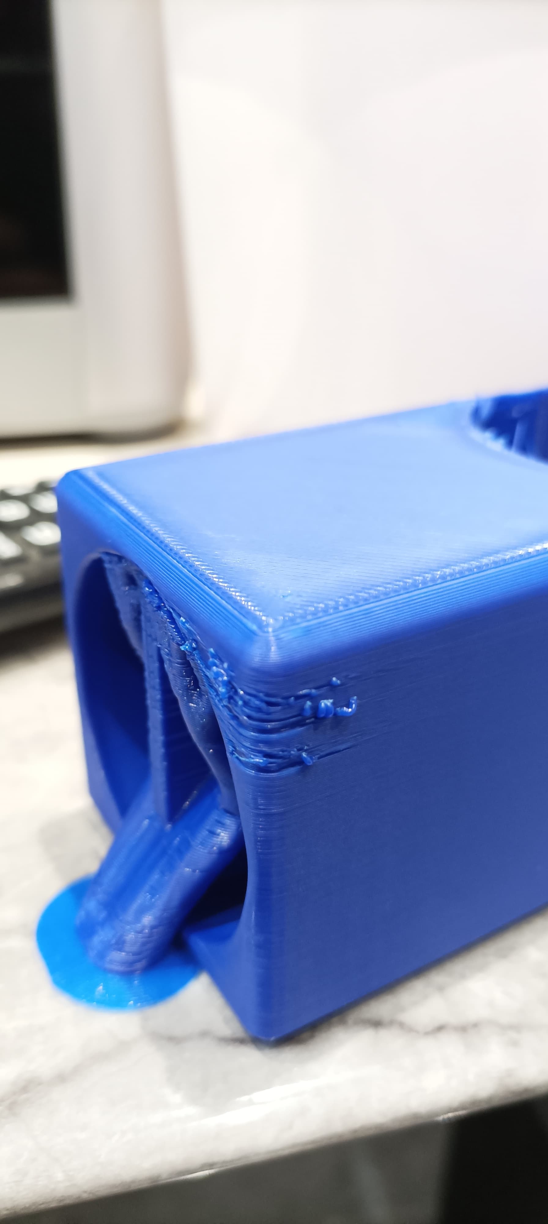

Onto my PETG prints. I’ve attached some photos of my parts, for reference, the hole you see is approximately 45mm in diameter. The parts are printed in the orientation shown. The photos are using Bambu PETG basic filament, and the stock “Extra Draft” profile. With the exception of the supports, the setup is as the profile.
I am getting what I can only describe as surface scarring. It looks as if its down to an accumulation of pickup on the nozzle, which eventually gets deposited or "ploughs through the print. In 99% of cases, it occurs at a corner, the corner you see is a radius of approx. 4mm.
I have not done and dynamic flow calibrations for this filament (my understanding this is not required for Bambu filament).
However, this is the troubleshooting I have done so far.
  • Bambu filament using the “Draft” profile (0.2mm LH): same indications.
  • ESUN PETG Filament, uncalibrated using the Generic PETG profile: same indications.
  • ESUN PETG using automatic dynamic calibrations (in the setting AND prior to print): same indications.
  • ESUN PETG using manual dynamic calibrations: same indications.
I have trawled the community, and although I have not found excactly my problem, there was a thread talking about the “Reduce Speed For Overhangs” setting causing issues. Does anyone have any experience of this?
Has anyone seen issues like this before?
I might be completely missing a trick here by not calibrating my Bambu filament - if so apologies.
Many thanks for sticking with it to the end!!!

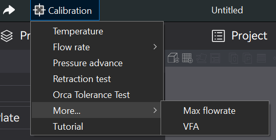

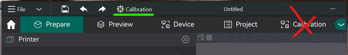

Ok. These are only suggestions and YMMV. The first thing I would do is ditch Bambu Studio. Unless your really wanting to use it for MakerWorld downloads, there is zero and I mean zero upside to using it. If you haven’t tried Orca, there is no penalty in loading it side by side with Bambu Studio and you can do a bake-off and judge for yourself. They can coexist on the same or different systems. What’s more is that they are based on the same code so you would be forgiven for not noticing a difference at first glance.
Why am I so adamant about Orca? Because after Studio 1.6, BL practically abandoned us in pursuit of the POS site they called Makerworld and it was clear that they made a concerted effort to put all their enhancements in promoting themselves and delivering on features that nobody wanted or asked for. Whereas after 1.6 the 3D hobbyists at Orca continued to innovate and produce quality of life functionality that we all wanted and many of them features we didn’t even know we wanted until they were there.
The biggest feature in my mind is the baked-in calibration routines. You won’t find this menu in BL Studio.
We might eventually get to see this added into BL Studio. BL dropped some hints when they payed Homage and nodded to some features that they included from Orca but that was back in 1.6.6 and frankly, it was not nearly enough. I don’t even know why they bother with their calibration tools and you might wonder the same once you experience Orca.

If I look at this corner, it looks to me like you may have a combo of issues possibly including adhesion, layer delaminating and last but not least, max flow which it sounds like you could use more time validating your max flow or just simply cut it below 13mm³ for PETG. BL has their’s set for 13mm³ but that doesn’t mean you have to keep yours there.

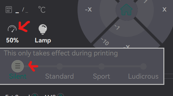

You can also as a quick check, put the printer into quite mode which reduces all movements by 50%. You can do that on the fly and change it back mid print from the console. If that fixes it, then you know that it is either Speed, which can be experimented with in the Speed tab or it’s max flow rate. Since the rest of your print looks OK, I’m wagering it has to do with speed not flow rate although addressing flow rate may improve speed too.

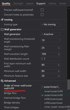

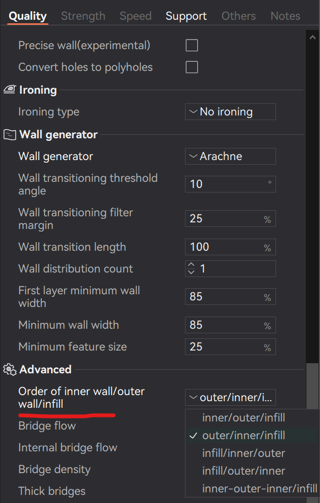

And if you haven’t tried changing the wall order, from the default of inner/outer to outer/inner, that will also make a big impact since it will print the outer wall first which is where that corner picture above shows issues. Truth be told, I haven’t found a use-case for the default inner/outer yet and in all my prints where I have dimensional accuracy issues, that setting is in the wrong position, so I permanently set it to outer/inner.
And you know what? Now that I think about it, I also never have any external layer issues anymore either and I use PETG and PC for more than half my prints. :thinking:
You’ll have to check the advanced mode to see this menu but I suspect you’ve already done that.
I have some other thoughts on the “consistently inconsistent” results you reported​:blush: but these suggestions above would be the one’s I’d try first. If you do try them, let us know how it works out so that others may share in your discovery.
Hi there, thank you for the comprehensive response. I’ll address the Orca point you made initially.
I will certainly look at getting Orca. I currently use my works computer to model and slice (it’s very convenient) so I’ll have to ask nicely to see if they will install Orca too. If not, I’ll put it on my personal laptop.
I took the part in the photo and did a bit of dissection. You are right, the outer layer hasn’t adhered, and the layers essentially curls away. Good in a way that this means it is not the nozzle build-up and “ploughing” I’m so used to seeing on the Ender.
Onto the investigation… All of this was still done in Bambu Studio.

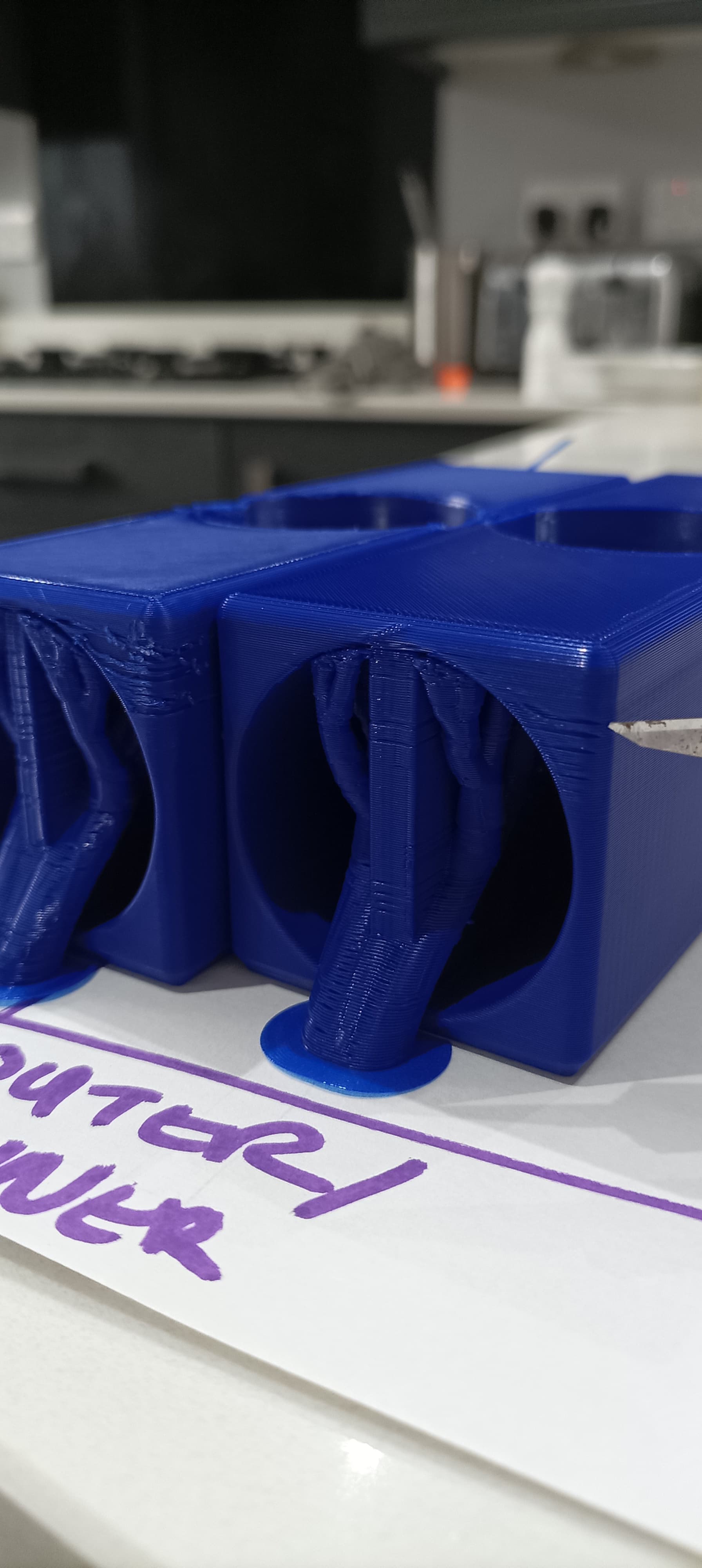

I changed the setting to print outer wall / inner wall / infill. I printed the same part you returned in your reply. I kept an eye on it when it began to print the problem bit, and I could see the indications begin to appear. At this point I switched the printer to “Silent Mode”, as you say, reducing speed. See below side by side by side comparison. THe part on the left is from the photo you returned, the one on the right, is as described above. THe scalpel blade shows the approximate height at which “Silent Mode” was triggered. You can also see the surface sheen is different (which I have read about, but this is a second order problem).
You can see the problem is almost completely mitigated after the switch.
So, the conclusion from this is (correct me if I’m wrong).
This is speed related, or more broadly, dynamic.

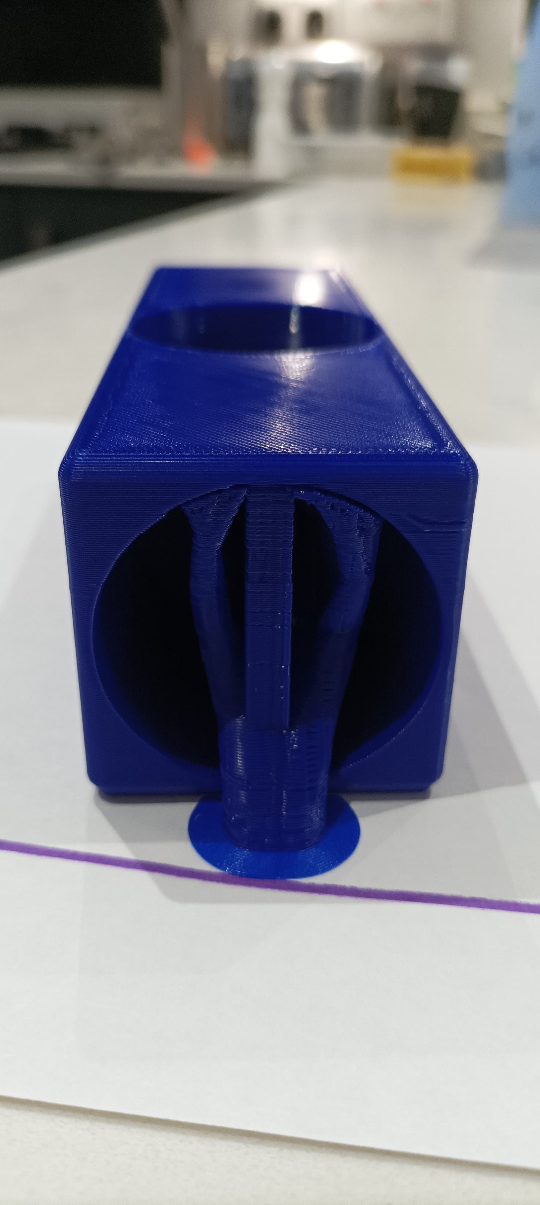

This test part was AFTER doing the manual calibrations for PA and flow in Bambu Labs. For reference PA came out to be 0.04 (I have no comparison to the stock profile). Flow Rate came in at 1.0136 compared to 0.95 Bambu stock profile for their filament. Remember this is the Bambu PETG Filament I am using. I didn’t calibrate max. flow, this is still at 13mm^3/sec,
See below photo, this is the same file with the exception of the calibrations.
So my very important takeaway point from this is trust your gut. I was kind of expecting to just throw models and filament at this printer and it be able to cope, this is coming from someone who has gently held the hand of his E3v2 for a few years now and tuned it nicely.
Although I am not counting my chickens yet, as my Bambu filament has now run out, I will be moving back to ESUN, which I will be calibrating for flow ratio and PA first.
If the simple calibrations are the solution, which I am fully expecting them to be, I’ll be putting this one down in my big book of “User Errors”. I’ll put my hat on, and go and stand in the corner to think about what I have done!!!.
In all seriousness though, it’s been an interesting exercise for me, not to take your eye off the ball, otherwise you will get bitten. When I first got the Bambu my goal was increase speed and consistency. Speed is definitely there inherently, consistency will take a bit of learning!!!
I’m kind of kicking myself with this one… I compared the original part with one of my PA calibration models from the E3v2. It looks almost identical to an untuned PA. I really should have engaged brain before emotion.
