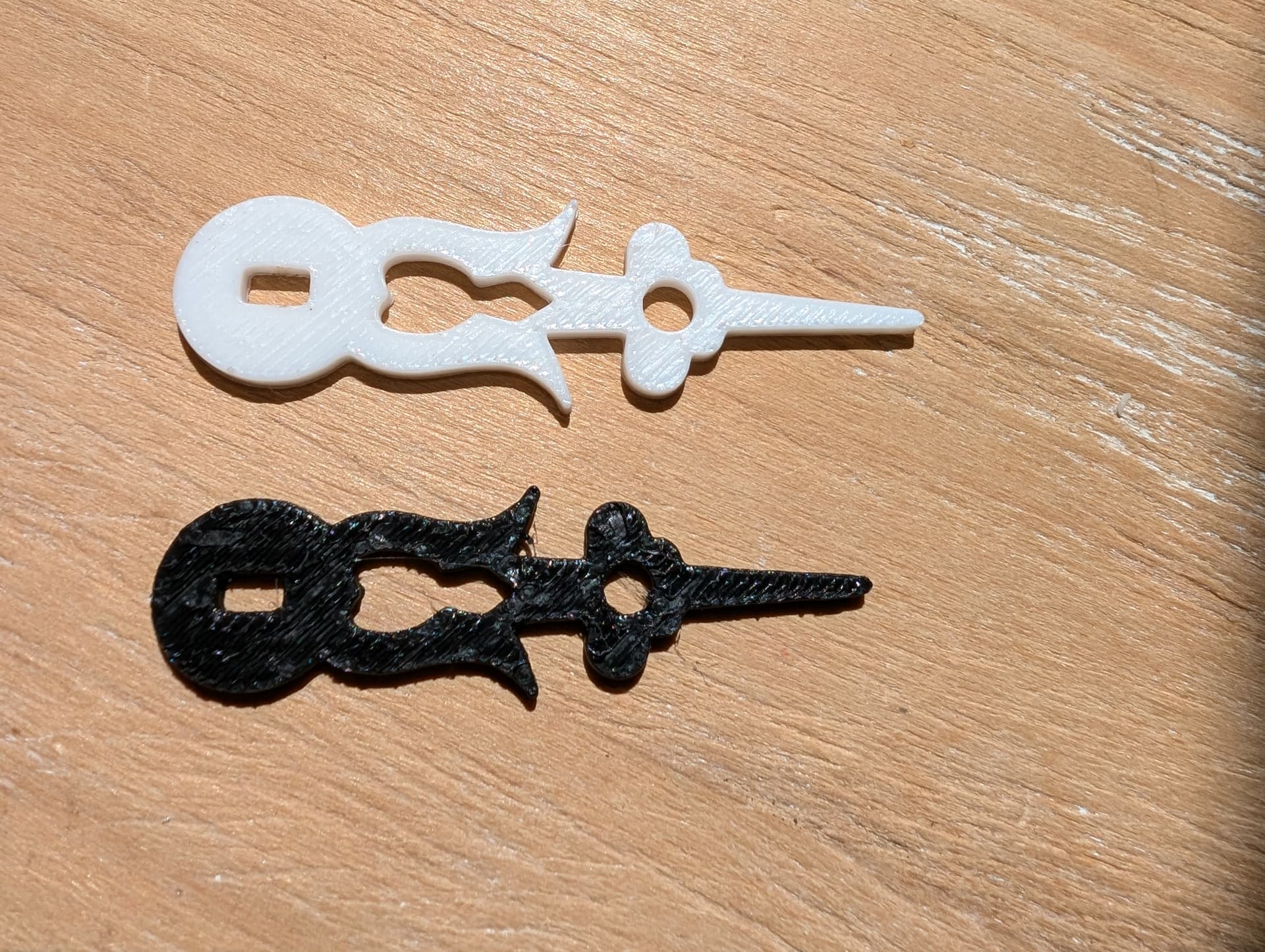

Did you manage to solve your problem? I wonder if i have a similar problem with the bambu black basic. this is my first printer, and i almost finished a spool of white pla basic, the results were incredible. But since i started this spool of black, it is not satisfactory at all.
The Bambu PLA that was reported as having issues was fairly easy to spot because the surface finish of the filament was really smooth and very shiny. The black and white basic PLA that has been ok has more of a satin finish at least in my experience.
I will only have this photo for now; I’m not sure if I can tell whether one is satin or not.
The bottom one (black) looks like it needs to be dried.
Thanks, that was the subject I was starting to look into. I had just opened it, but I read that sometimes you have to dry it anyway.
I was referring to filament on the spool before being extruded. It was really shiny stuff. But good you posted an image so Malc could answer.

I would start by drying the spool, even if it is freshly opened. 45C-50C for 8 hours should be enough to give you confidence that PLA is dry enough. THEN run the manual flow calibration from Bambu Studio to derive the k value.
The images seem to show the black filament has had some moisture absorption
