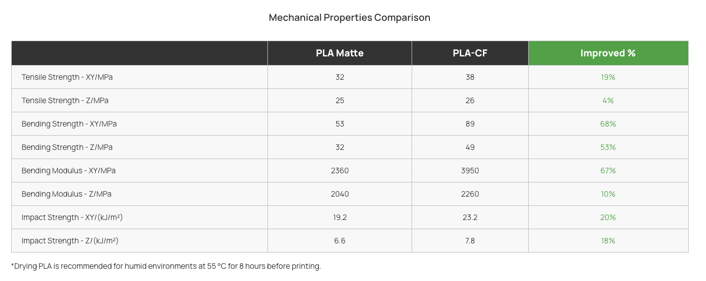

Both PLA-cf and PETG-cf have bundle sale going on. I am thinking of getting some.
Question on PLA-cf:
Does anyone have experience using it? I am interested in the strength comparison with regular PLA.The store web page only shows the comparision between PLA matte and PLA-cf.
Question on PETG-cf:
The web page of PETG-cf shows good improvements over traditional PETG in terms of numbers. Do these numbers translate into real improvements?

On the physical properties:
Mostly those carbon fibers increase stiffness and reduce shrinking which in turn reduces warping. That is why usually soft materials like PA get much easier to print with CF. In addition, many materials have an increased temperature resistance with CF.
At the same time, impact strength and layer adhesion is reduced by the fibers. As far as I know only long fibers really can increase the strength in the XY plane.
If by strength you mean stiffness, then yes, it improves with CF. If strength is the force that you need to break something, then most filaments actually are weaker with CF.
Regarding PLA-CF: I think the benefits are purely cosmetic ones: You get a very very matte and quite rough surface that conceives layer lines almost completely. I think it has a very appealing and high quality appearance. As PLA is already very easy to print, I didn’t see much difference in ease of printing. I get along very well with all PLA basic, matte and CF at default settings. Temperature resistance is not improved as far as I remember.
I’m not surprised that Bambu compares it to PLA matte. That probably is the closest alternative. I have measured layer adhesion of basic and matte PLA from Bambu. Matte did break at ~ 1/3 the force needed for basic. I guess that PLA-CF is somewhere in between. Since the findings I wrote above, I got rid of all my rolls although I really liked the surface a lot.
I have one roll of PETG-CF that I still haven’t opened since buying it, so I can’t give first hand experience. I think you can expect reduced warping especially on an open printer as well as much stiffer parts than regular petg. I could imagine that temperature resistance is improved. But you should find those information in the data sheets.
by strength, I meant all of them: tensile, impact, flexural, compressive, and tear.
But what Bambu Lab puts on their mechanical property comparison table are good. I made a request yesterday for a table that includes all types/subtypes of Bambu Lab filaments, linked below. I think it will be very helpful.
