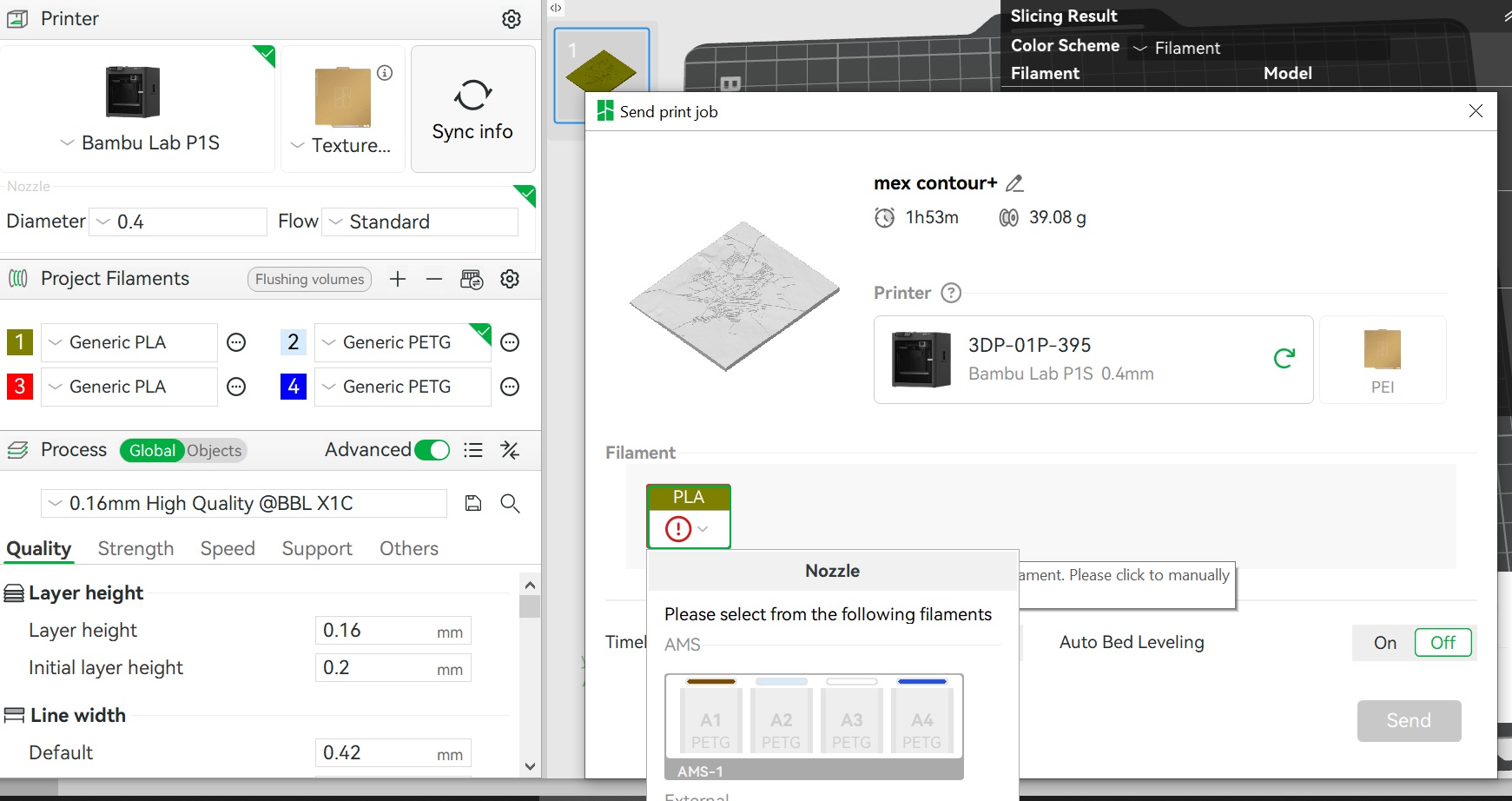

I have 2 reels of PET-G, 2 PLA in my AMS. When I try to use PLA, there is no option on the print window. It does work with both PET-Gs
.Any ideas what is happening
Thanks
You need to set filaments correctly in the AMS. You can see that the AMS believes that it only has PETG loaded.
Here is a link to the wiki
Yeah, had to set filamnt type in device. Not just in the prepare window.
