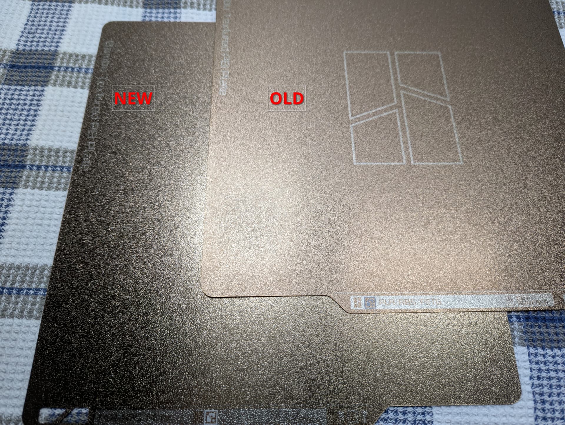

I had the same issue with warping. I tried adjusting print bed temperature and reducing aux cooling. That didn’t seem to help. Adding brims definitely helped. What I believe the root cause is I printed several spools of PETG for a while. When I went back to PLA it didn’t stick well. Maybe cleaning and maybe just wore out. I have 1648 hours on my original textured plate and used both sides. Changing to a new textured plate worked!! I couldn’t believe how well the PLA stuck on the new plate. PLA didn’t want to stick to the plate with PETG residue build up. Here’s a photo of new versus old.
