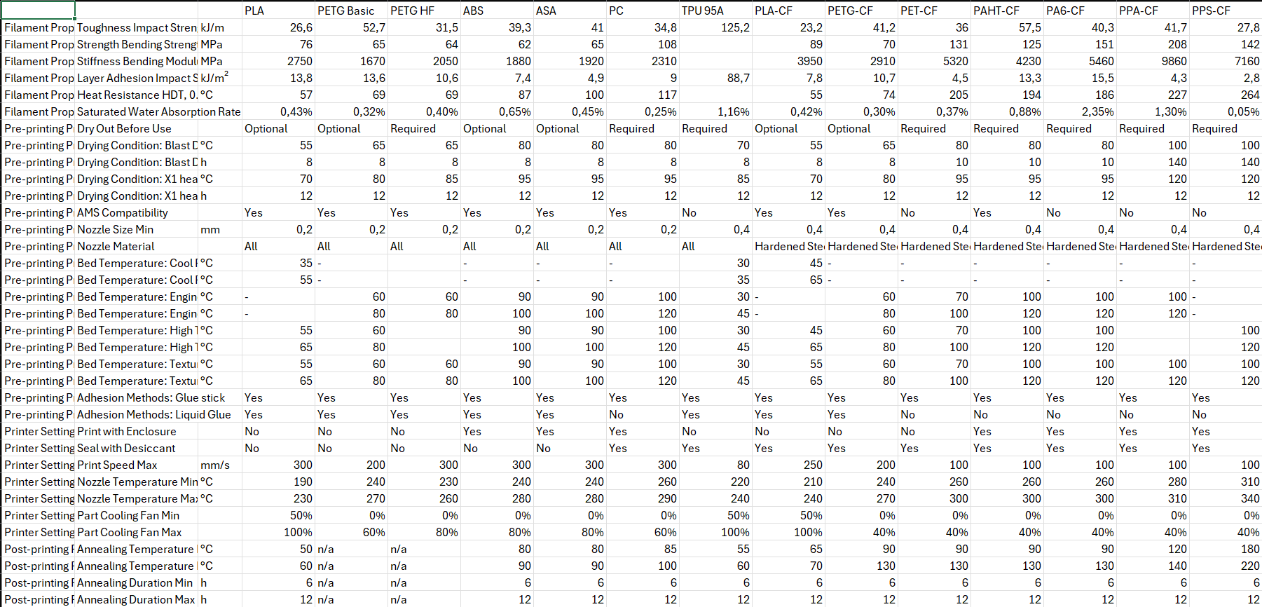

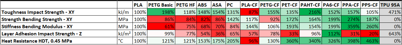

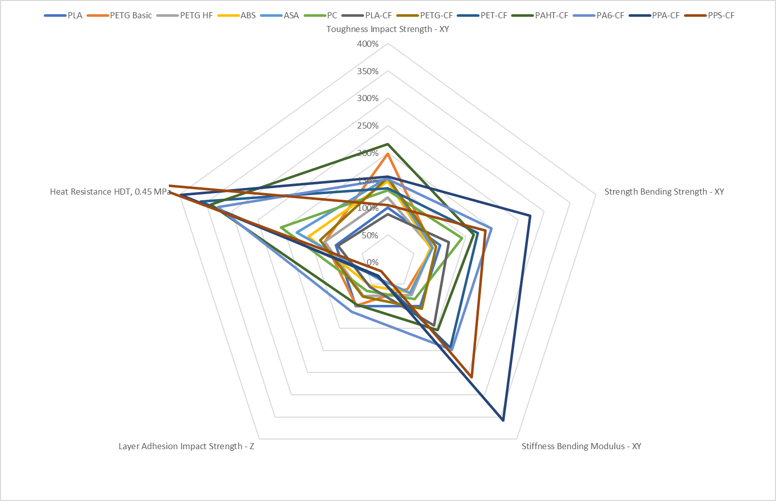

I did make a comparison chart a while ago here:
I have updated it since (except for PLA Tough) but do not seem to have posted it yet. Will do when back at my laptop.
