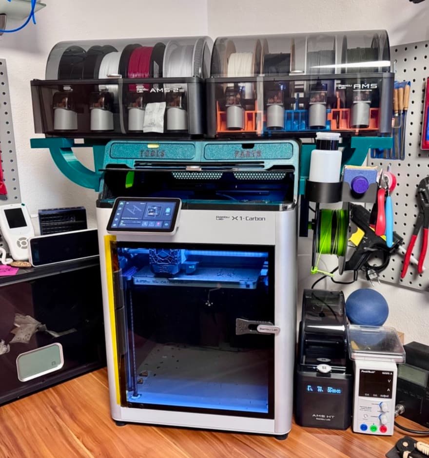

This is how I connected two AMS units to my X1C. Uses a minimum amount of space in the corner and works smooth for more than 1100 hours of printing already.

You’ll want to ensure the buffer has enough room to expand properly. The PTFE tube from the hub to the printer must be able to adjust its effective length—a straight run won’t work; you need a bow.

I’ve finally got round to adding the the second AMS I purchased early December in the BF Sale and would say the optimum place to position them would be to the right hand side of the printer especially when using the standard PTFE tubing that they come fitted with.
In my case the space to the right of my X1C is taken up by a laminator and my original AMS is on a shelf just above the printer itself so the logical place in my setup would be to the right hand side of the existing one.
Initially I thought placing them equidistant side-by-side on the shelf directly above the printer with the gap between them directly above the centreline of the printer would be aesthetically pleasing and would satisfy my OCD but if using the pre-fitted PTFE tubing then the left AMS doesn’t really have enough ‘loop’ in the tubing so leaving the original AMS directly above and positioning the new one to the right solved that for me.
Of course using the longer length of PTFE tubing supplied with the AMS would have enabled me to do just that and in fact solve most placement issues but in my situation would have impacted where my filament dryer would go.

I was considering something like that but in the end just couldn’t abide all that weight sitting up there so high in the air. I ended up getting two of those inexpensive Walmart Hyper-Tough 14x24 3-shelf black wire shelving units, and combined the parts to make a 4-shelf unit. It’s 44 inches tall, plenty of room for the lids on the AMS units (4 of them) to open. It sits beside the desk that holds the X1C and all the cables and PTFE tubes reach the printer, no problem. There’s also room for some Polymaker boxes. Nothing on top of the printer so it is easy to service and see what is going on inside. The two shelving units cost me about $70 and I didn’t have to burn a bunch of filament and machine time to print the top mounts. I’ll try to arrange for a picture if you are interested.
