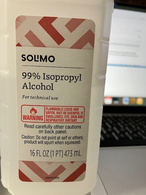

I use soap and water (scrub well) every 10-15 prints (preemptive) and about after doing that 3-5 times I use 99% Isopropyl Alcohol and scrub it well. 99% Iso is a cleaning solution (note on the bottle (“technical use”) and it works as a cleaning solvent in manufacturing to “clean and degrease”. I do not use lower percentages of alcohol as it won’t work as a solvent.

Amazon is where I got my case (12) bottles. Here’s a similar link Remember only 99% for technical use (It’s a “cleaning solvent” at 99%. Lower levels like 91-87-81% wont work…Amazon.com: Amazon Basics 99% Isopropyl Alcohol First Aid For Technical Use,16 Fluid Ounces, 1-Pack (Previously Solimo) : Industrial & Scientific?

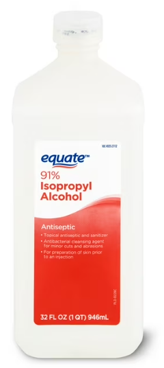

Walmart “Equate” brand 91% IPA (9% purified water) works just fine, ~$4 /qt, leaves no residue.
Chunks of glue stick dissolved in a small spray bottle of this 91% IPA works well to provide a smooth surface without glue lines - the viscosity is such that the liquid can level out before evaporating, leaving a thin layer of glue behind.
