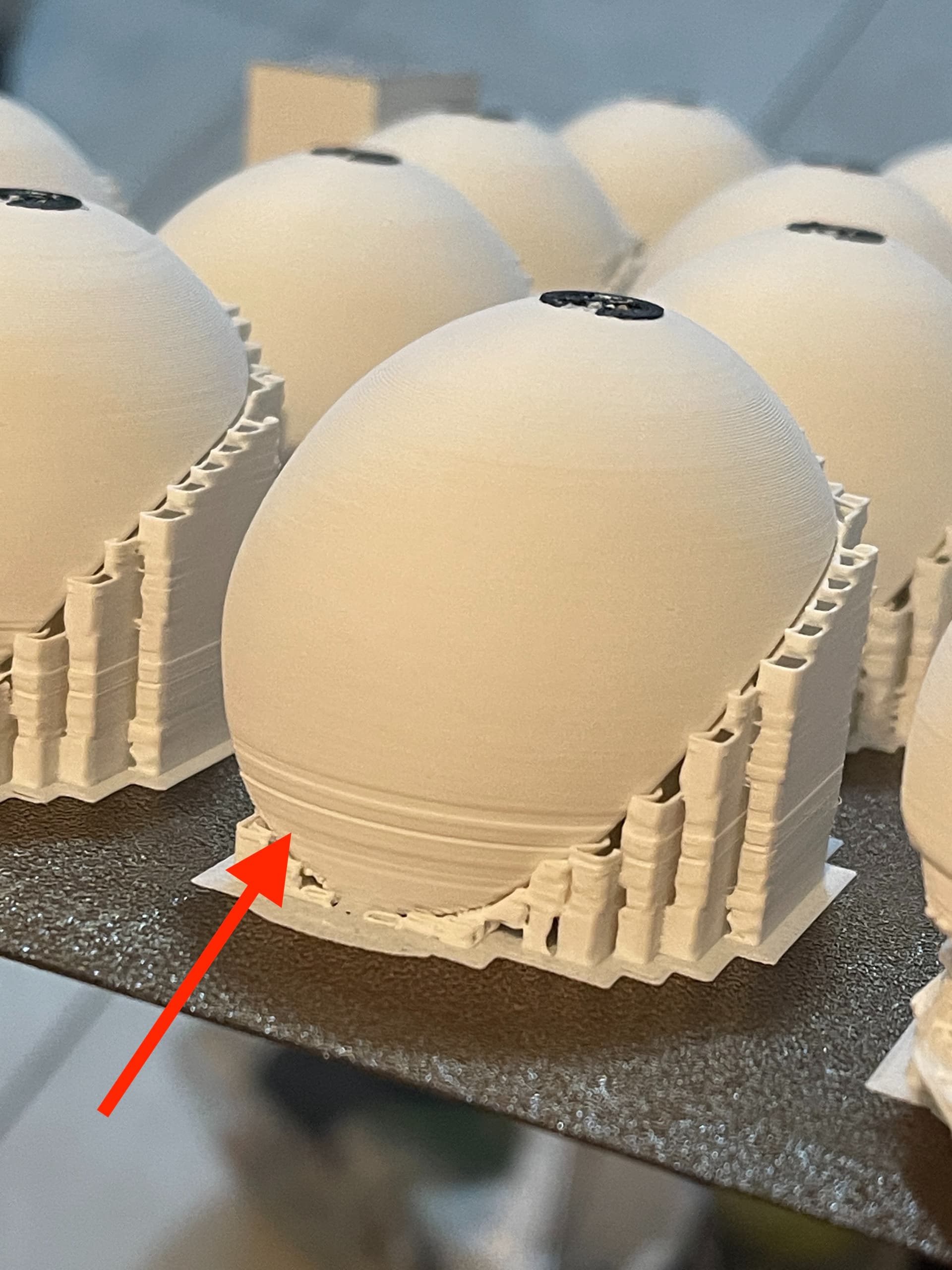

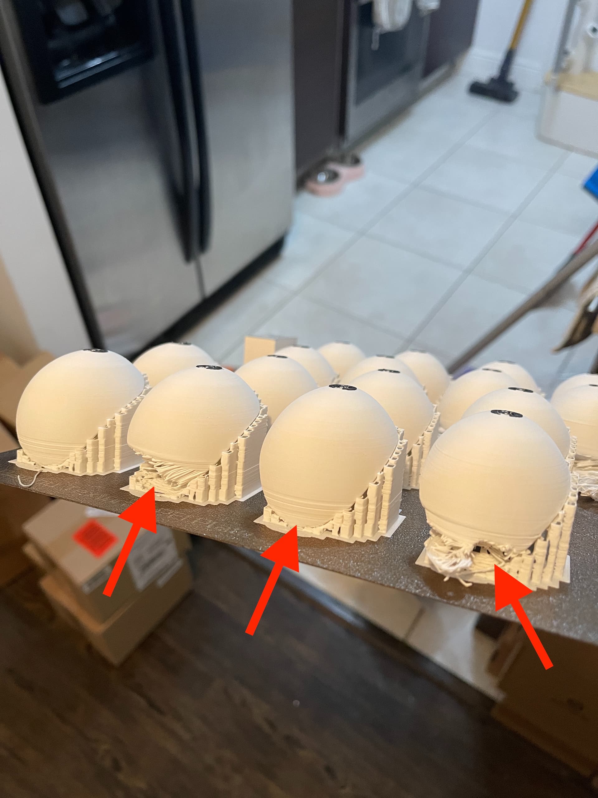

I’m having troubles printing this full bed, about 50% of the prints turn out well, while the other 50% end up like the result shown in the attached picture. Due to the shape of the eye, I need to print it at this specific angle.
I’ve also included the 3MF file. Could you advise me on what adjustments I should make to achieve consistent, high-quality results with every print?

If this is a P1S/X1C then retension the belts.

I have 6 P1S and I get the same result with all of them so I don’t think it’s the belts. Does anyone have another solution? I think it’s related to the slicing
…in this case which is showing,… and watch the support , i think it´s the filament and the speed and the temp…
print slowly and see what´s happend…
