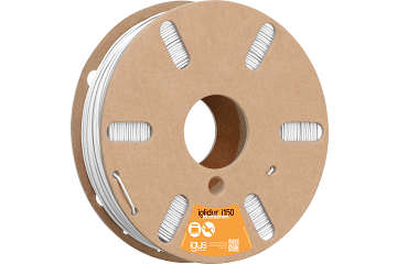

There are alternatives to POM with similar properties that I’ve seen sold in Germany, but they are expensive and my need to print a bushing was not that high.
This is supposed to be easier to print but similar properties. Around $100 a kg but in 750 g rolls.
