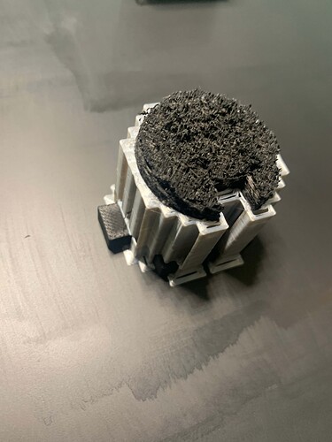

Poor infill final layers on supports
Once the print reached the final support layers, the top layers have poor infill.
Thank you for any help.

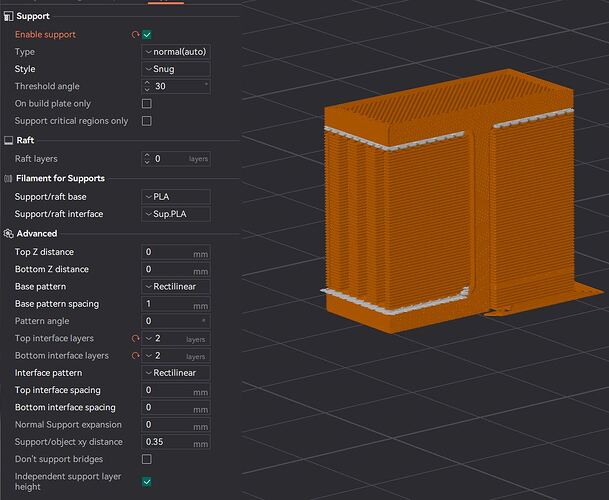

I am obviously new at this. I am using the PLA-CF and PLA support.
I had Support/raft base = Support. I notice you use PLA. Why not use support?
Style = default
My original file was a Step file. After further research, I noticed Bambu prefers 3MF files. Do you think this makes a difference?

Do to I did not know what filaments you was using the sample above was if your part was just a basic pla and we would use basic pla as the support base then use a pva or breakaway support for the interface layers this would allow less filament changes and the part will print way faster and save filament so look at your slice times and you will see what I’m talking about.

Style = default = This Link will show you why and when to pick your filament.
Being you are new to 3D printing, test out with basic pla and support combos use the cheap stuff save your carbon fiber filament until you have some good working settings.

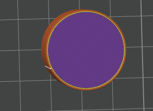

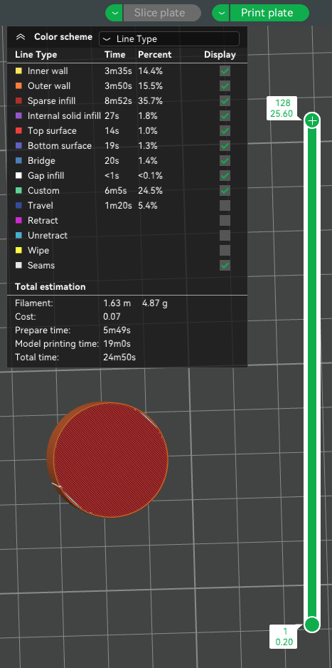

In the preview mode in the slicer use the slider on the right to move to show different layers. You can use the down arrow and it will go down 1 layer at a time.
The preview starts at the top layer. (Use 1 to change to a top down view.)
you are looking at the final top layer. Top surface is shown in red.
Now down arrow. You are now seeing the purple solid inner fill.
down again and you are seeing the bridging over the infill in blue
down again and you can see the infill pattern.

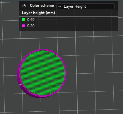

now I go back up one layer and I am looking at the bridging, but with line height selected. What you see is that the bridging line height is double the normal layer height. If you have a high density infill the layer will be too thick and cause problems for the following two layers. Normally with 15% infill and most infill patterns the double thick bridge just provides a good surface for the following layers. It just “settles down” into the infill and is effectively a normal .2mm layer.

I had a clogged nozzle with the PLA CF. What do you think about changing to a 0.6mm nozzle when using PLA CF?

Yes .6 nozzle will help with any carbon fiber filaments.
You can use pla or petg carbon fiber with the .4 nozzle just don’t go below 0.15 layer height and don’t print at high speeds you can lower your volumetric max speed set it to 9.25 with the .4 nozzle and see how it works out this will help keep the speed cap @ 150 mm/s max.
