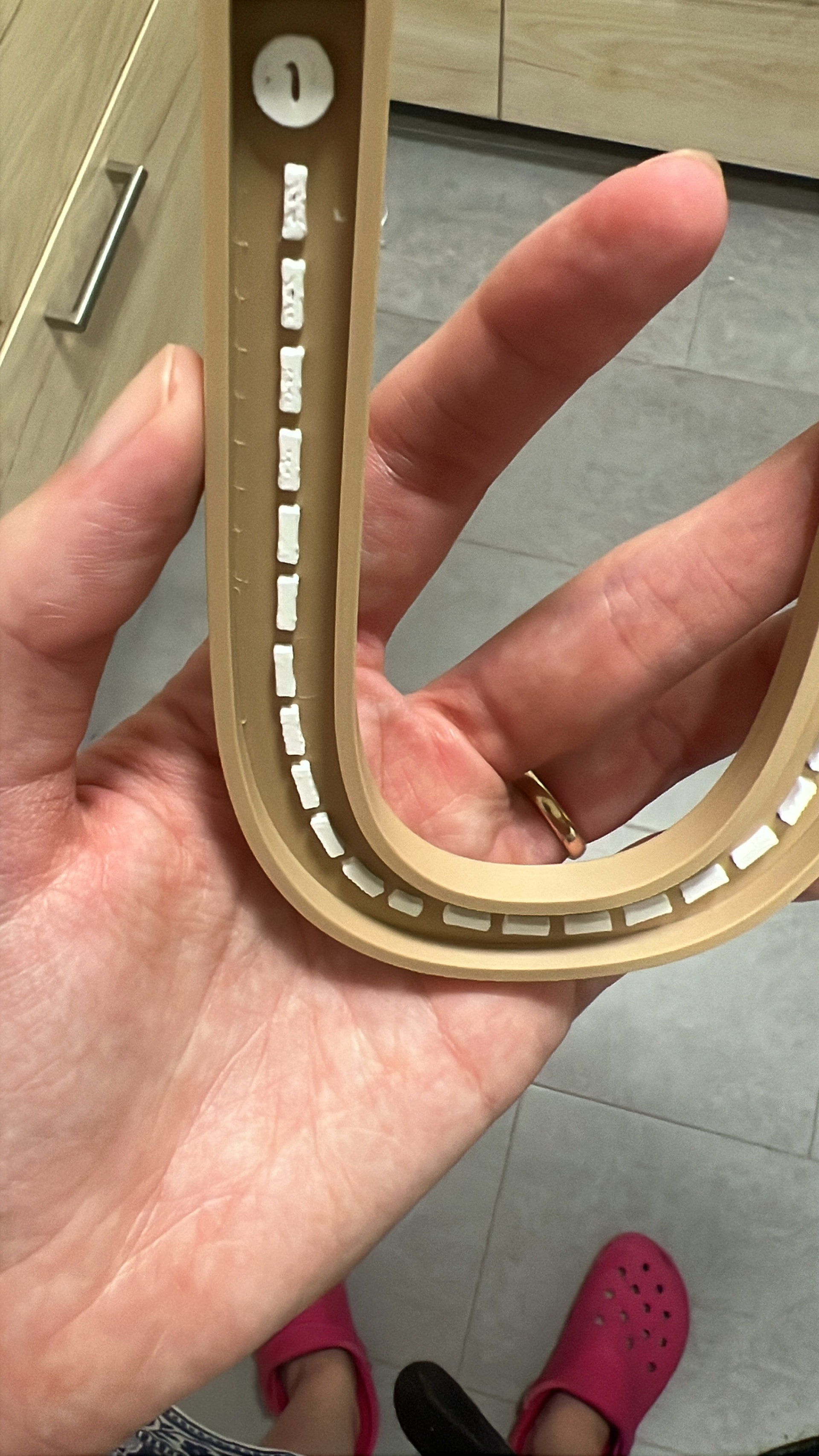

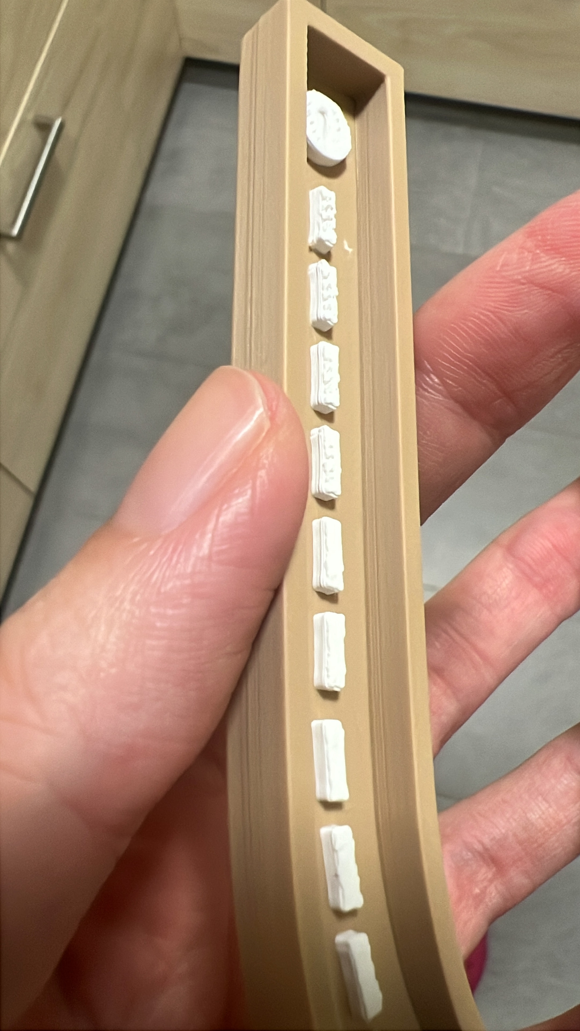

Hello there!

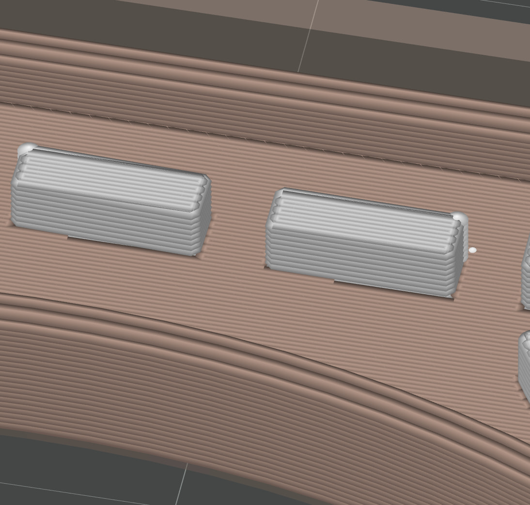

I’m having an issue with a two-color print in Bambu Studio and I’m not sure what’s causing it.
The white rectangles are recessed into the main beige body. Most of them print perfectly, but some have a rough and incomplete top surface, as if the top layers are not fully closing. The strange thing is that it only happens on some of the rectangles, while others in the same print look fine.
Printer: Bambu Lab X2D
Nozzle: 0.4 mm
Layer height: 0.20 mm
Filament: Bambu PLA Matte (printed in the aux noozle)
Flow Ratio: 1,006
Profile: 0.20 mm Standard Quality
Additional information:
  • The issue appears in both straight sections and curved sections.
  • The affected areas are very small color inlays.
  • It is not the final top layer of the whole model, only the top surface of these white features.
  • I’ve already tried reducing speed and adjusting flow, but the problem remains.
  • I originally had visible gaps and unfilled areas on these white inlays.
  • To improve this, I enabled ironing, which reduced the gaps significantly.
  • However, some of the white rectangles still have rough or incomplete top surfaces, while others look perfect.
  • The issue was already present before enabling ironing.
  • The model is printed face-up.
  • I dryed the filament and the problem got worse
Any suggestions would be greatly appreciated.
Thank you!

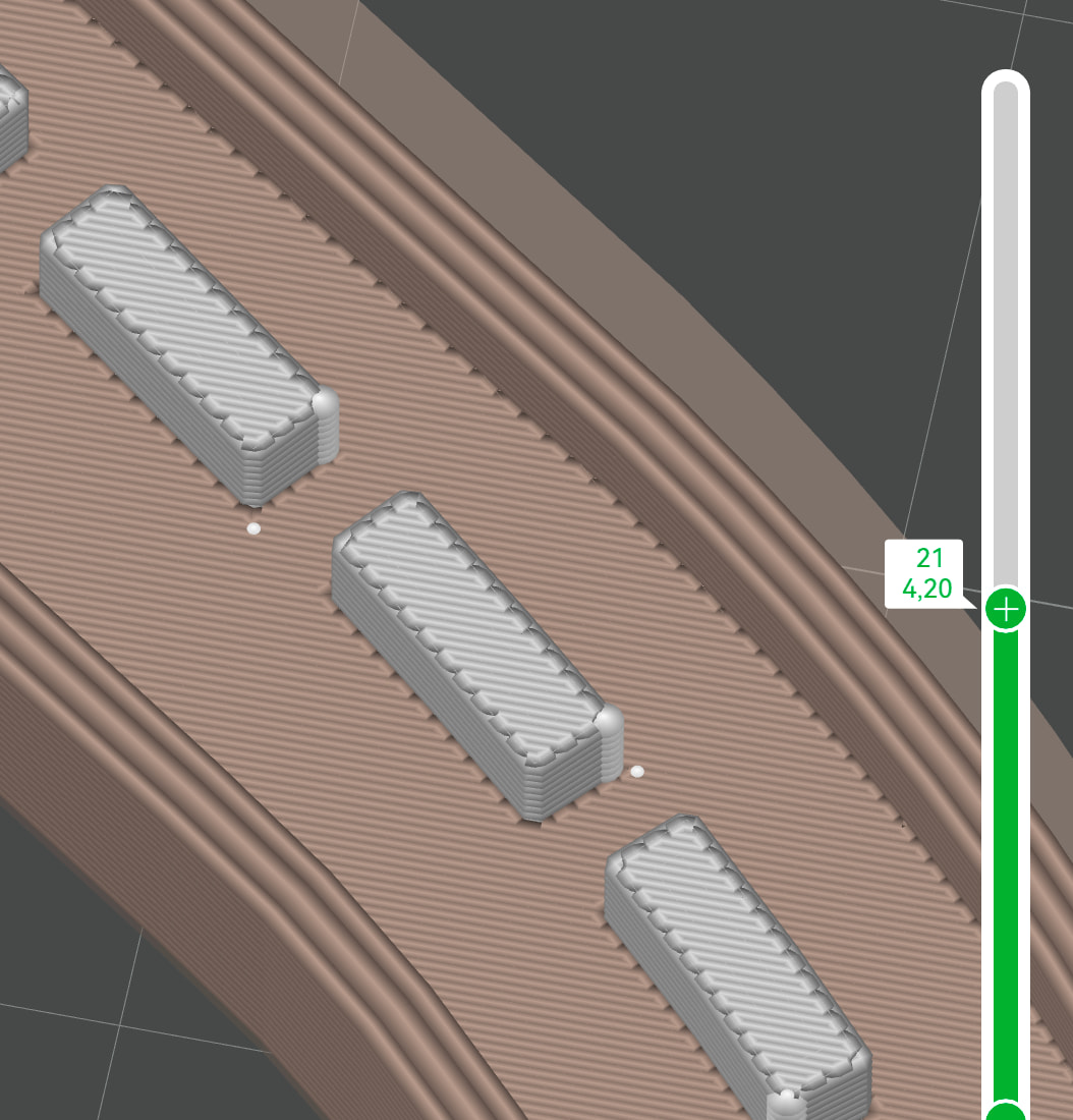

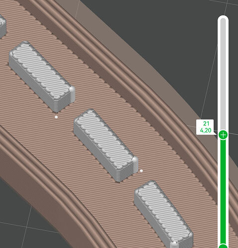

Sorry, but my Spanish is very poor so it was difficult for me to translate the settings. The one thing that caught my eye was the ironing settings.
First, do you really need ironing on the small features? This is concentrating a lot of heat in a very small feature and may be melting the part.
Second, 5% flow for ironing is quite low. When using ironing, everything must be in perfect condition specifically on small features.If your nozzle is worn you will have a very difficult time getting good results.
Third, I noticed that in the images of the top layer with slicing “on” there were small steps in the top layer of the small features. They do not appear in the images of the top layer with ironing “off”.
Thank you very much for your recommendations. I used ironing because if not, on the top part of the piece I can see the lines. I do not understand what you mean with the small steps… the final piece has more layers but they are not white. So do you recommend to disable ironing? Or change the settings of the current ironing? I just want the white pieces to look smooth on the top, no lines or rough surface.

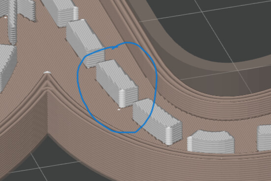

This is what I meant by ‘steps’ in the top surface. It may be an optical illusion from the screen capture.
Yeah I have dried the filament up to 28% but within an hour (and not opening the AMS) it increased to 40% :downcast_face_with_sweat: I don’t know how to maintain a stable humidity with so much humidity in the environment. Any tips? Also I will try to perform what you suggest. But since I am very new to all of this, can you guide me on how to do the “filament calibration for Pressure Advance (K-value) and flow ratio”?
I didn’t know if I said that the white filament goes in the secondary noozle, I don’t know if that has anything to do with precision but in this way I do not waste filament with the change of colours. Can I perform that pressure advance and flow ratio with the secondary noozle?
Oh and the steps I think it’s and optical illusion. However, I am noticing that they have two different finished styles on the top layer, right? How is that possible? I have the ironing activated. Do you recommend to disable it to do the tests you propose?

I think the direction difference of the lines are due to the position of the small features relative to the direction of the ironing. The slicer does not adjust the direction for each feature for ironing. You may want to try setting the ironing pattern to ‘concentric’ so it will follow the shape of the feature.

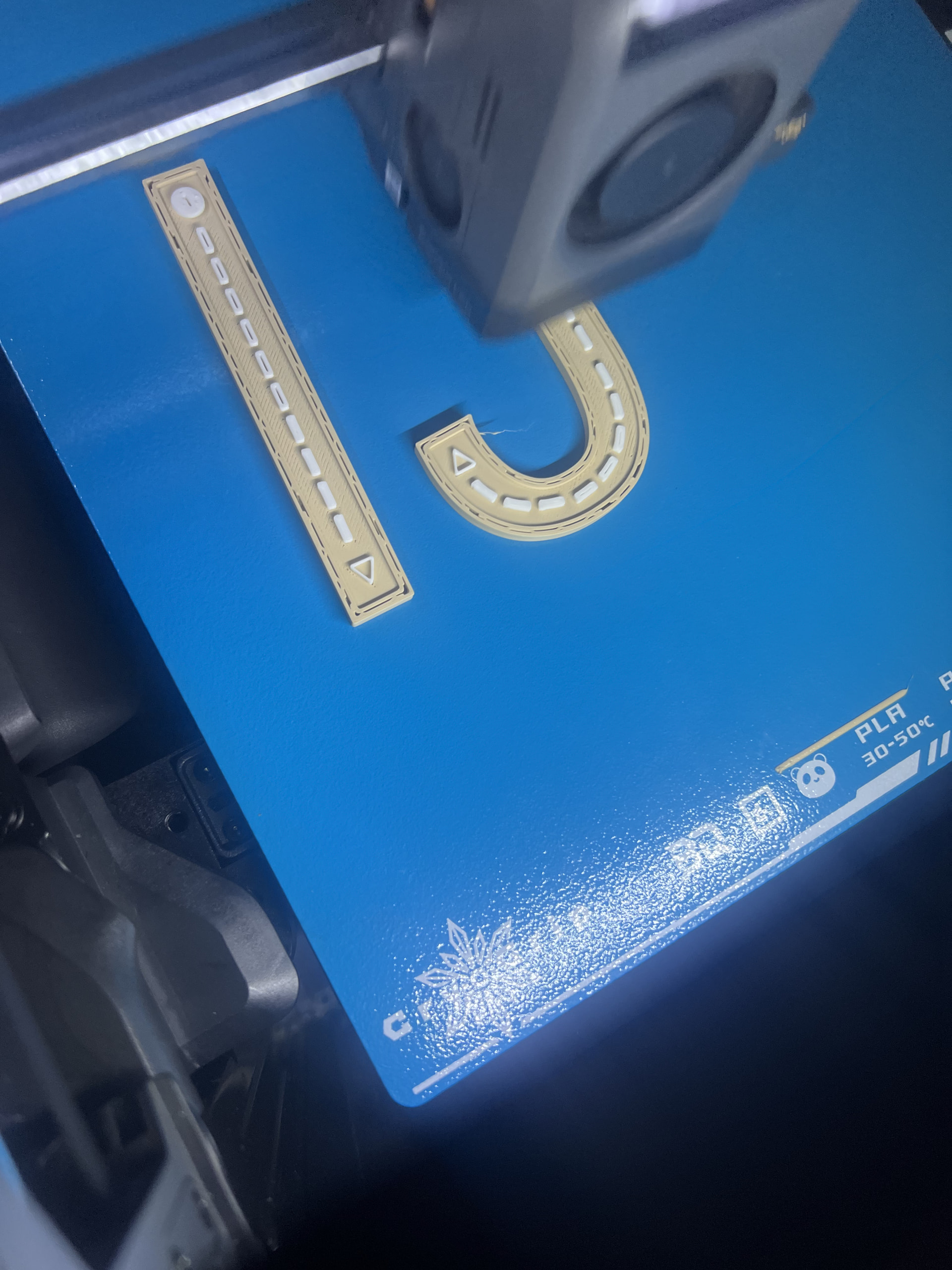

Thanks I will try to do the flow dynamics calibration. I also tried to change the ironing to concentric and in the sliced it look worse. I have thought to share a part of the file with you so you can look at it. I share 3 files. In the lowercase file, I do not have the same problems in the white pieces, at least not so evident. In the uppercase file i have the rough surface in some parts and in the “lligada” file, I have the rough surface in a great part of the white pieces.
abecedari LLIGADA JUNT copia.3mf (138.4 KB)
lowercase.3mf (131.0 KB)
UPPERCASE.3mf (98.9 KB)
I have noticed that it leaves a hole in the white piece from the beginning but the last layer it has been ok (I have changed to the primary noozle both colours). I really think it has something to do with humidity too. I will print the dessicant holders and buy reusable silica bags, maybe that helps… the humidity has increased to 50% in two days without opening the AMS. However if I plan to use the white filament in the auxiliar noozle outside, that filament will be wet too because of the environment. I’ve actually had worse results when I dried the filament and then left it outside the dryer, mounted on the external spool holder, than when I took it straight out of the box and started using it without drying it at all. Does that make sense?

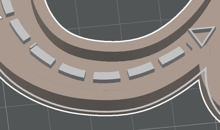

I looked at your .3mf files. Since I have a P1S I cannot duplicate exactly what you have. I did see some very small features in the “lowercase” file that appear to be fragments of something. Those probably won’t print well.
Also there are some small features such as the arrows that look better sliced using ‘Classic’ walls than when using ‘Arachne’.

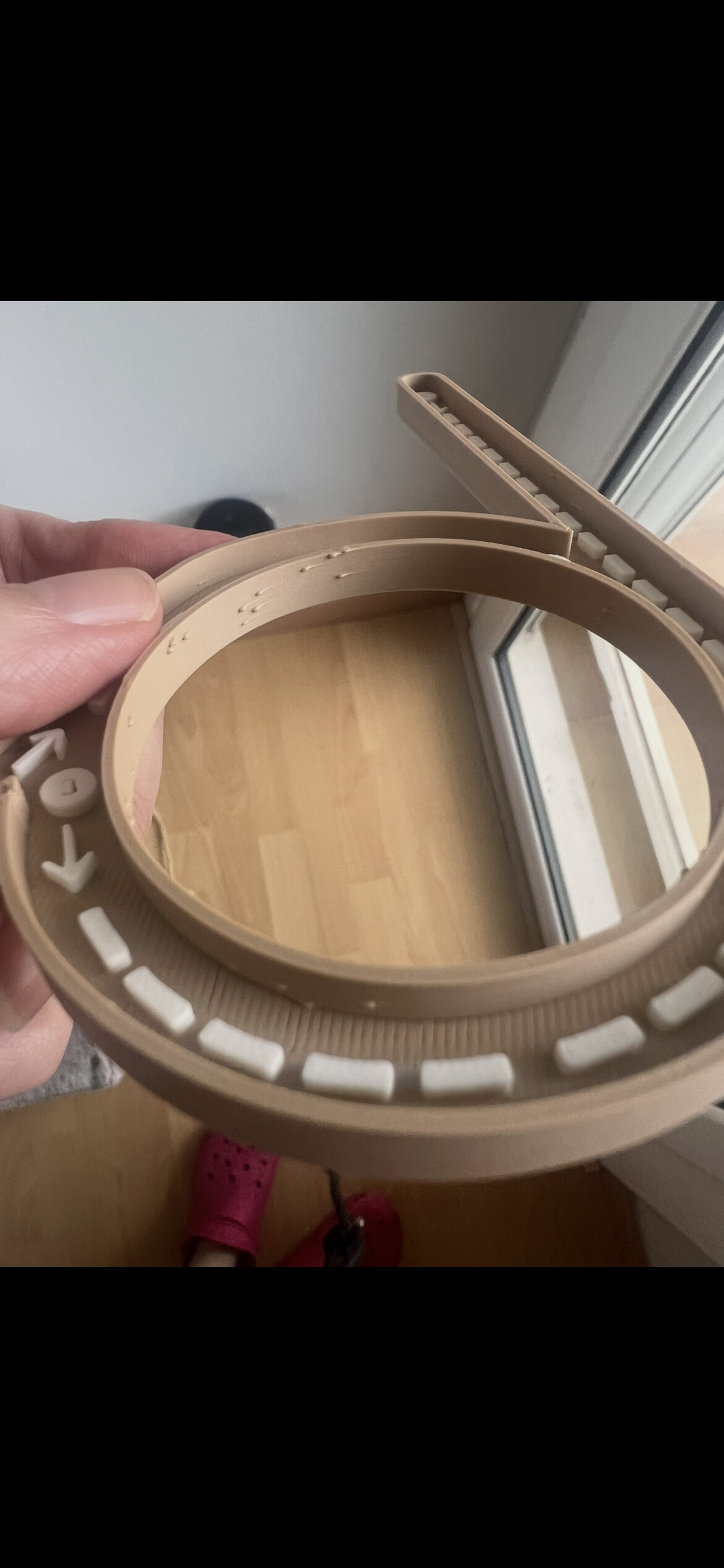

I have done a flow dynamics calibration on both the principal (automatic mode) and the auxiliar (manual mode). I have a question for you, the experts hehe. When I print then, do i have to disable the calibration process, put it in auto or on?
My pieces have improved significantly using both filaments in the AMS, however there are a lot of filament waste doing it like this. Is it possible that the aux noozle is less precise?

One of he fragments is just behind the triangle on the right side of the picture I posted. The other one is on the left side of the 5th block behind the the triangle.

It sounds like wet filament is the most of your problem based on your improvements. Is the area where you have your printer air conditioned? The heat could also contribute to the issue and make it more difficult to dry your filament. I cannot print much this time of the year because my printer is not in an air conditioned space.
Thanks again for your answers. It seems it was the humidity. I changed the filament and put it inside the Ams (before it was in the exterior and I printed with the auxiliar noozle). I think I waste more filament like this but the quality of the printing is significantly better. I also printed some dry containers to put silica inside the ams and the level of humidity dropped. However I have now another issue related to the sewing. I attach a photo. I tried aligned and random sewing and the results were not satisfactory. Any guidelines on how to improve this? You can take a look at the file on previous posts, it’s the “ligada” one.
