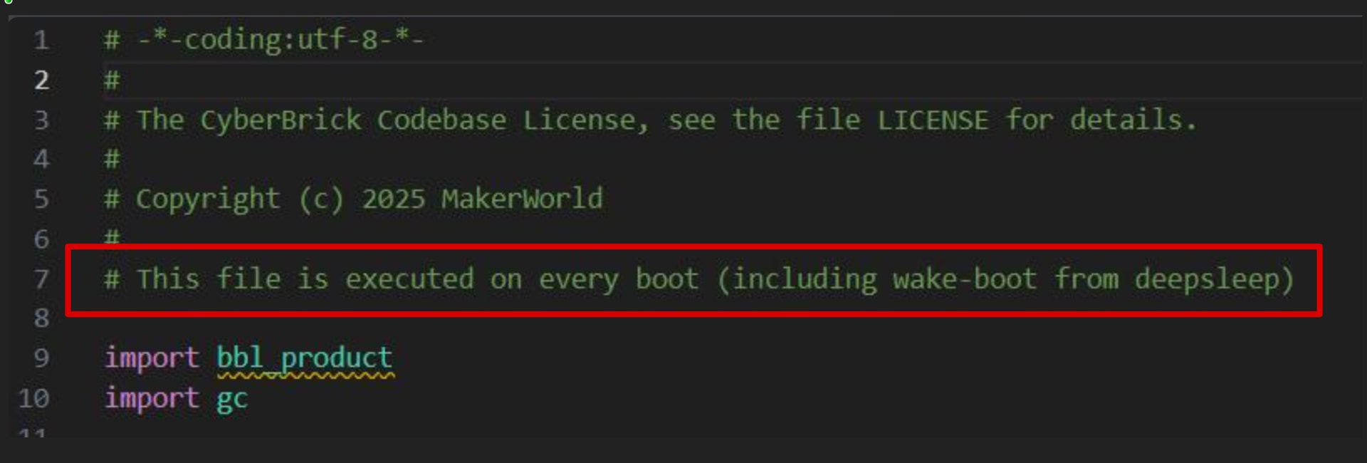

Is there any chance this is what you’re looking for?
However, the code must be written in: MicroPython and total file size of the source code shall not exceed 800 kB. Not regular Phyton.
Composition description of the custom project
The composition description of the custom project shall meet the following conditions and operate according to the rules below.
  • A custom project must contain a boot.py file.
  • The boot.py file must be located in the root directory.
  • Boot.py files will be executed when the core board is supplied with power. After execution, the program will stop running and reset. Thus, boot.py performs the core function of the custom project.

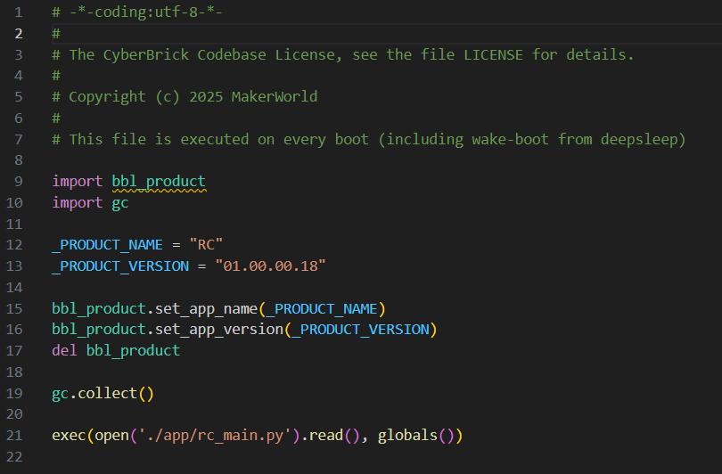

I also found the boot.py file that the screenshot shows, for me it looks similar:
>>> print(open("boot.py").read())
# -*-coding:utf-8-*-
# The CyberBrick Codebase License, see the file LICENSE for details.
# Copyright (c) 2025 MakerWorld
# This file is executed on every boot (including wake-boot from deepsleep)
import bbl_product
import sys
_PRODUCT_NAME = "RC"
_PRODUCT_VERSION = "01.00.01.01"
bbl_product.set_app_name(_PRODUCT_NAME)
bbl_product.set_app_version(_PRODUCT_VERSION)
del bbl_product
del _PRODUCT_NAME
del _PRODUCT_VERSION
sys.path.append('/app')
import rc_main
rc_main.main()

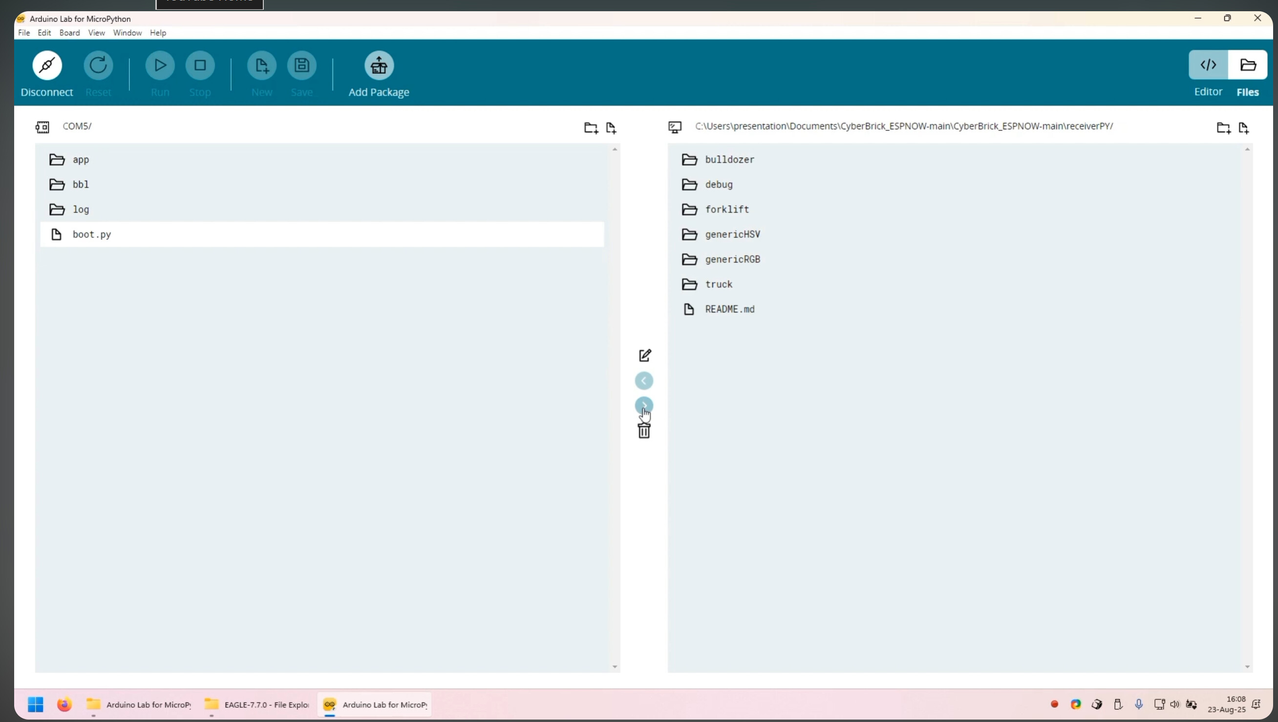

No problem, but what you want to do is complicated - there’s a lot to learn.
boot.py is what gets saved on your Cyberbrick. It says so right there in the text:
You copy boot.py to the CyberBrick by connecting via USB and using a MicroPython file manager to transfer the file into the device’s root directory. Once copied, reboot the CyberBrick and it will automatically run the new boot.py.
GitHub repository for Bambu Cyberbrick:
And here’s a guide written by another user from the forum:
Step 2. If you do not already have a REPL capable MicroPython development environment setup, I suggest you take a look at Arduino Lab for MicroPython, which in my opinon will be easiest to work with.
Step 3. Hook up the receiver side CyberBrick Core to your computer, open Arduino Lab for MicroPython and press Connect. On first start of Arduino lab for MicroPython you are asked to pick a folder where to store the files locally. Provide here the folder, where you extracted or git cloned my espnowdemo repository. You can directly provide the /src/app_espnow subfolder of that repo.
Step 4. Open the Files window (in the top right corner of Arduino Lab for MicroPython). You might want to backup your boot.py from the board. To do this, select boot.py in the left side and then click the button with right arrow icon in the middle of the Arduino Lab for MicroPython to start copying the boot.py file from your CyberBrick core to your computer.
Here’s a video that explains it, too. At least the first steps - how to set up the programs - will be of interest to you.

Only now I found time again to sit down with my Cyberbrick :b I followed the instructions of xrk that you posted, and it works like a charm! I can now use the Arduino Lab to edit the code on my Cyberbrick. And when disconnecting and then powering my Cyberbrick off and on again, I can use it and test what I coded! I tried to edit some simple values like the LED color, thus proving that I can freely edit the code on my Cyberbrick now!
