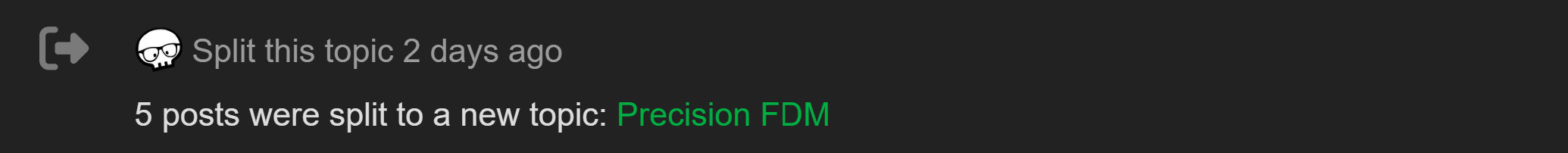

@JonRaymond Would it be possible to move the most recent posts, starting with comment #37, to a separate thread: “Precision of FDM”
Starting with the first comment by Isaac_Citrom, that would be #37.
That way, two completely different discussions won’t get mixed up, and the good comments from Isaac_Citrom will still be preserved. Then we could continue this side discussion there.
