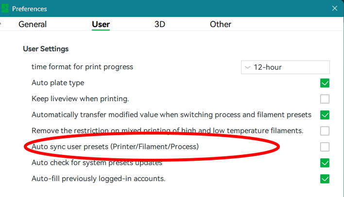

I also don’t understand why Bambu Studio doesn’t sync these presets to the cloud and associate them with the user’s account. It would make reinstalling the software or moving to a new PC much easier.
Hope this helps someone!
